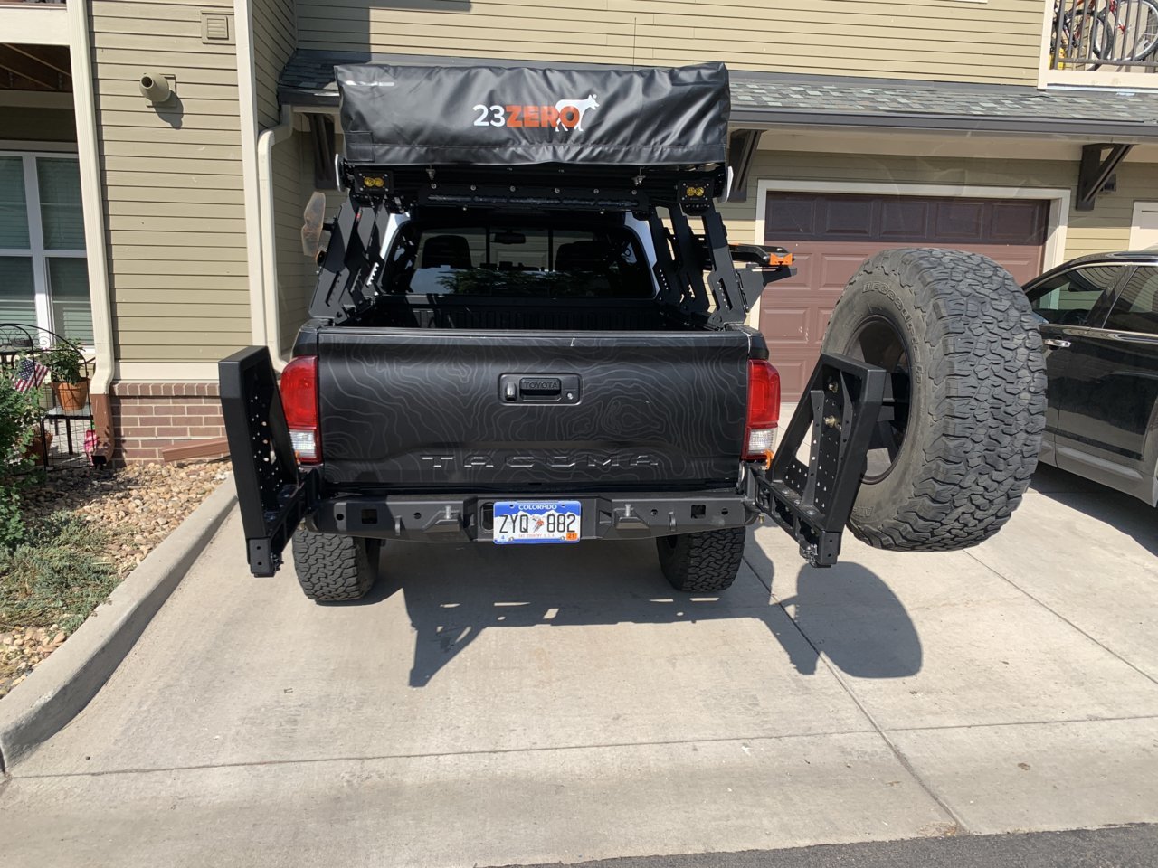

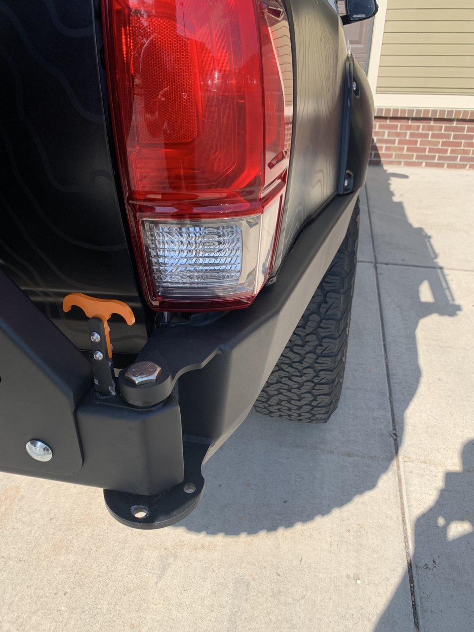

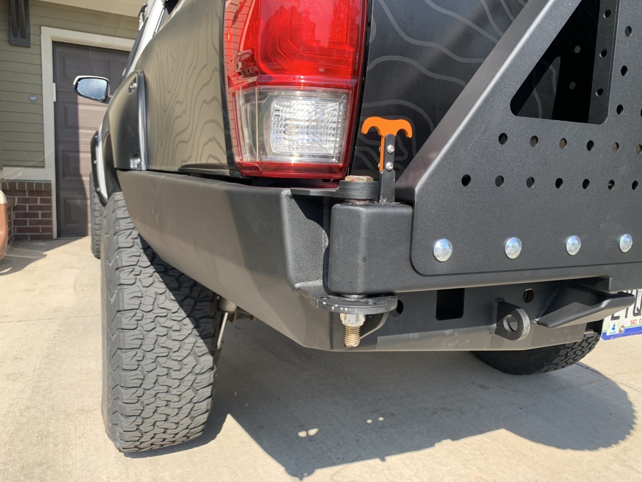

    Looks awesome. the latch is different.. Did the other one not work out? did I miss a post about this?

    You did miss a post #484, the pins were too close to the tail gate on the 3rd gen with the other arms.

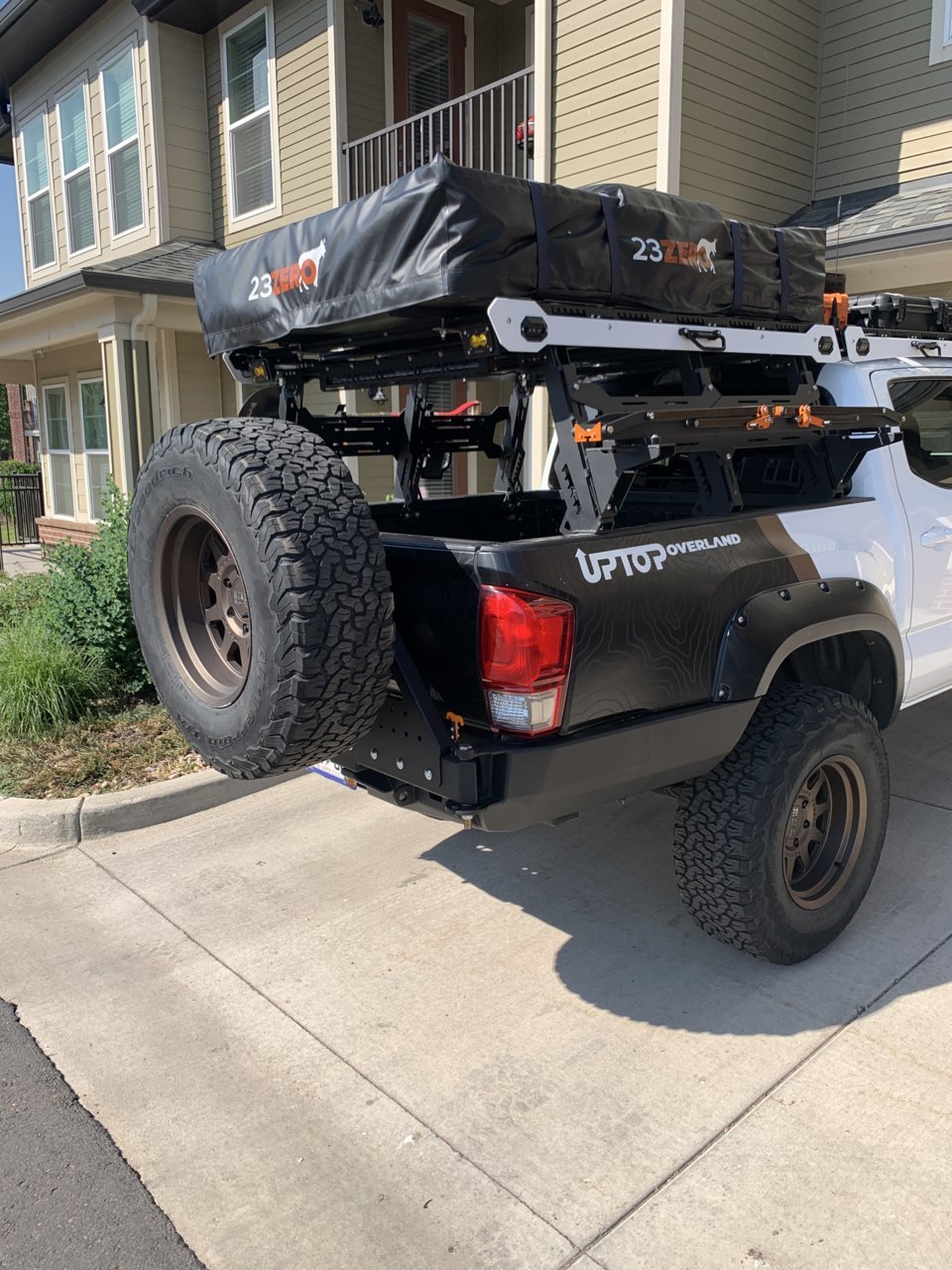

    If you rubberized undercoat the inside of the bumper, that takes the most abuse from the road it will help protect the powder. I did this on my previous bumper and it held up great in CO for 2 years before i switched to this

    Yes, just on the inside. It seems to hold up very well. It's an extra step, just mask it off and take your time.

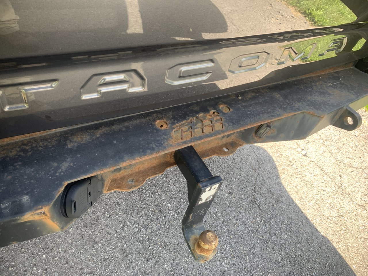

    the powder coating on my last bumper didn’t hold up to well and that was with washing every week or so...

    Yea, that's not normal. Something went wrong with that. I mean salt is corrosive, yes, but that's extreme. I live in Maryland, and if someone says snow two states over, they salt the roads. To make matters worse, they use that brine shit here. From what I hear, that's worse.
