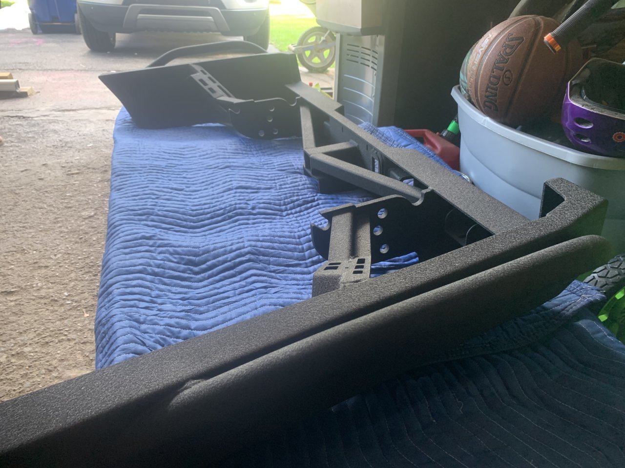

    Powder got done a lot sooner than expected! Should be going on this weekend!

    OOOOooooo! I like the texture!!!!!!! Did you request that specifically or is that the shops only option?

    It was his recommendation but I also liked the look of it. Only downside is it won’t match my front bumper and I’m kind of OCD when it comes to matching but we’ll see once I mount it up. I may not even notice the difference being one is on the front and one is on the back.

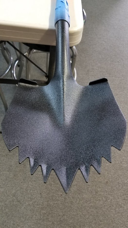

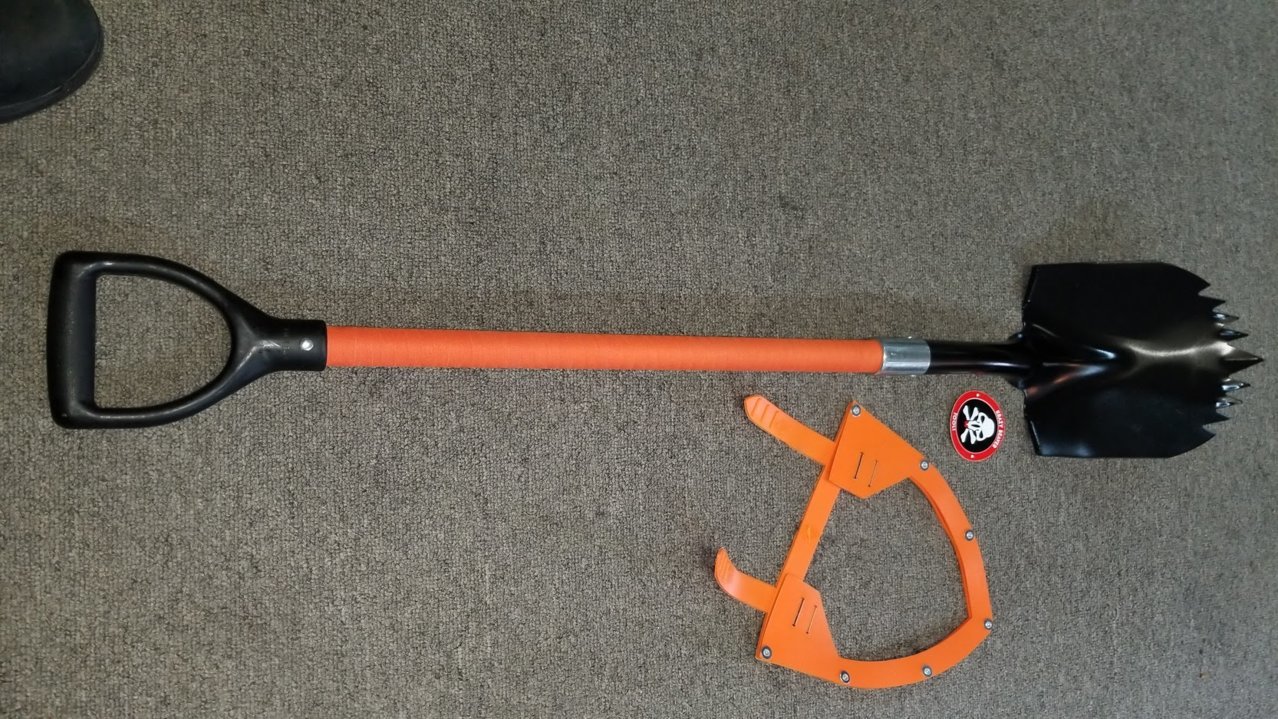

    But seriously.......Harbor Freight sells a rattle can bed liner spray. I used it to coat some armor and my trail shovel. It looks like a pretty damn close match. Before
    QDECXdM5Yu78R1G11Hs6MNDQev6dYafQKmDQ42xJ_a17a498013bbb30a1cb438dccbf07ce4415f9de2.jpg
    After
    RWMOrtwdQ5e3w94-N9aa1ywLiKRnp3VPwGh-DwIE_cb1d61b764ef6d8c6d690b5e8f35389858ea1f86.jpg
    Shaggs and Danactive[QUOTED] like this.

    might be worth grabbing a can to do a test run and keep one on hand for touch ups.

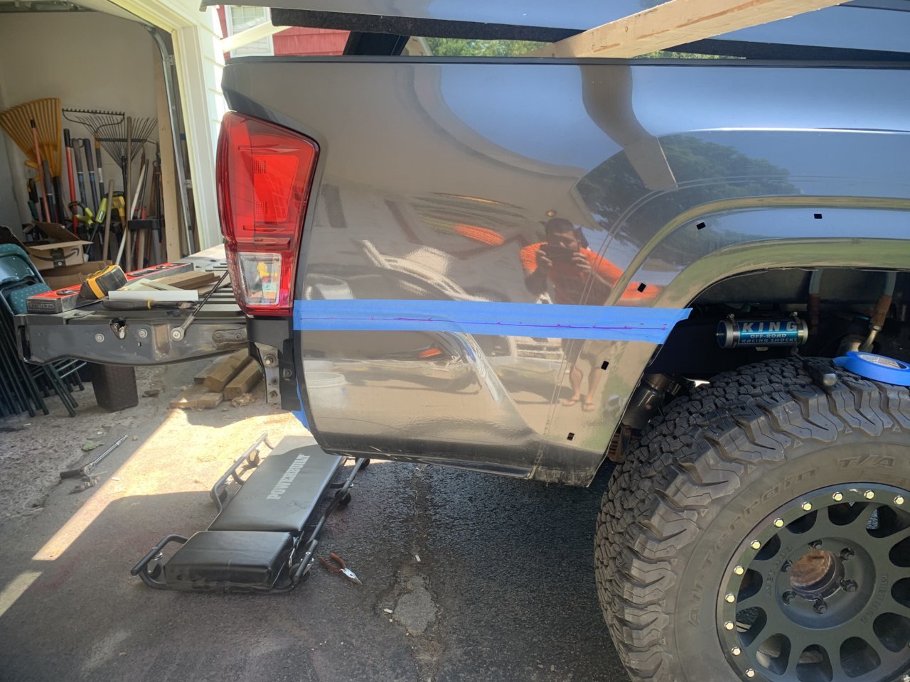

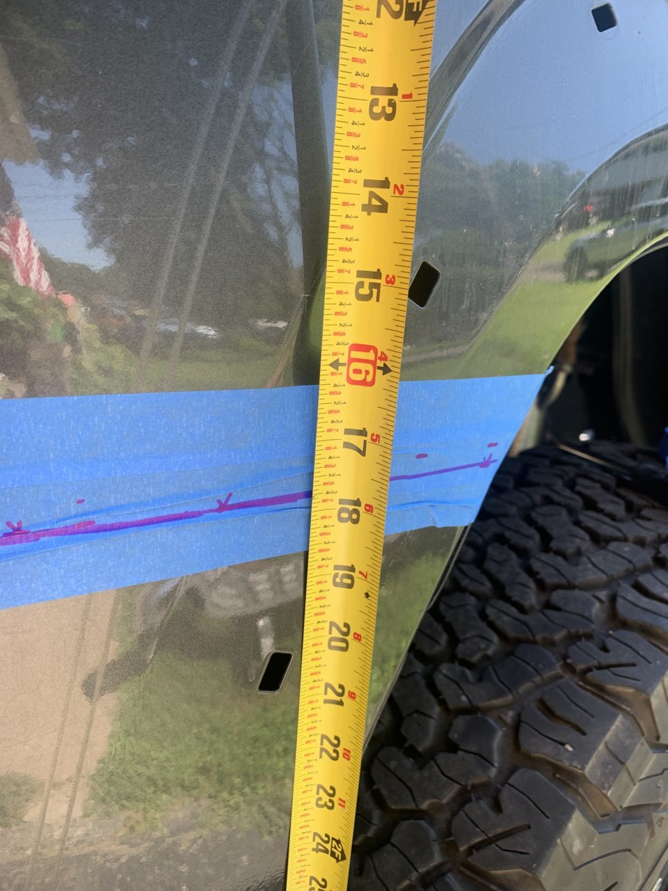

    Getting ready to cut bed now and i keep thinking this is too high. Anyone who’s done this please let me know if this looks right to you. It’s 17 3/4” from top of bed to give about 1/4” below tail light. Looks like a lot of bed getting cut off...

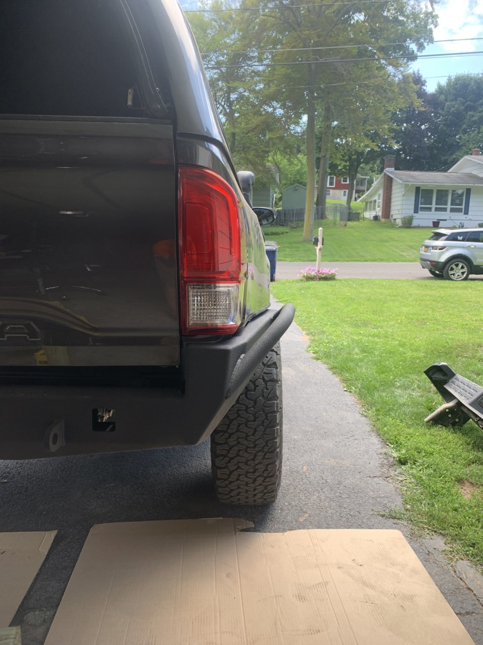

    I ended up doing the top of the bed measurement and went with it. Came out pretty good. Full write up with more pictures soon

    :bowdown: Great job! Did you use a cutoff wheel or something else? I tell ya. I wish there was something else to use to put over the cut. I have the same stuff on my prinsu where the wind deflector meets the roof and I put it on the best I could and it looks like shit. It looks like I rode over it on gravel first. I wonder if bedliner paint would work? Or just some smoother edge molding. You're came out really nice.
