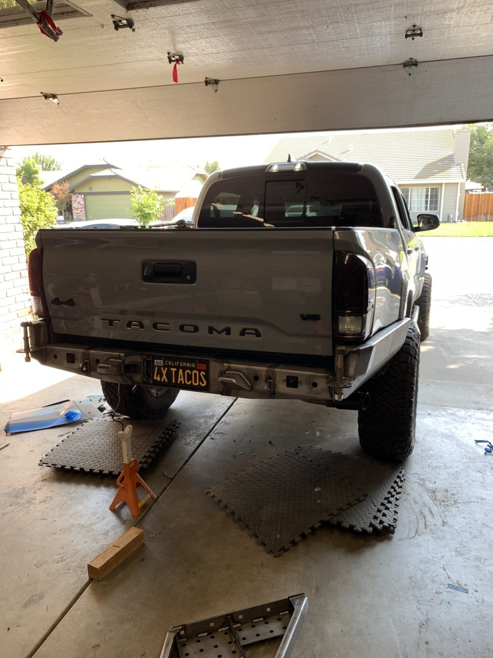

    IT FITS PERFECTLY

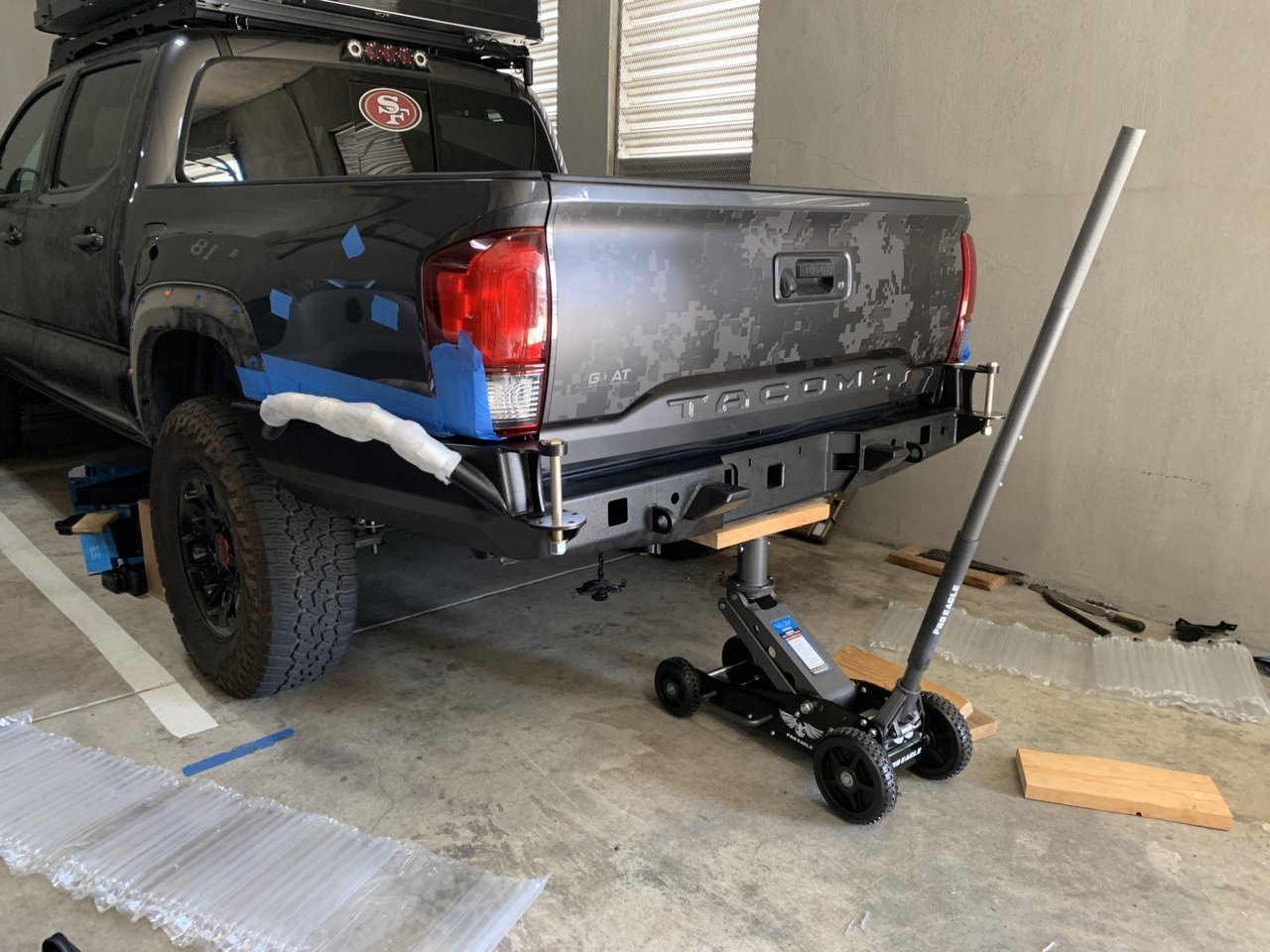

    See but if I tell you, that’s cheating and means you won’t have to put the hours of measuring as I did lol.

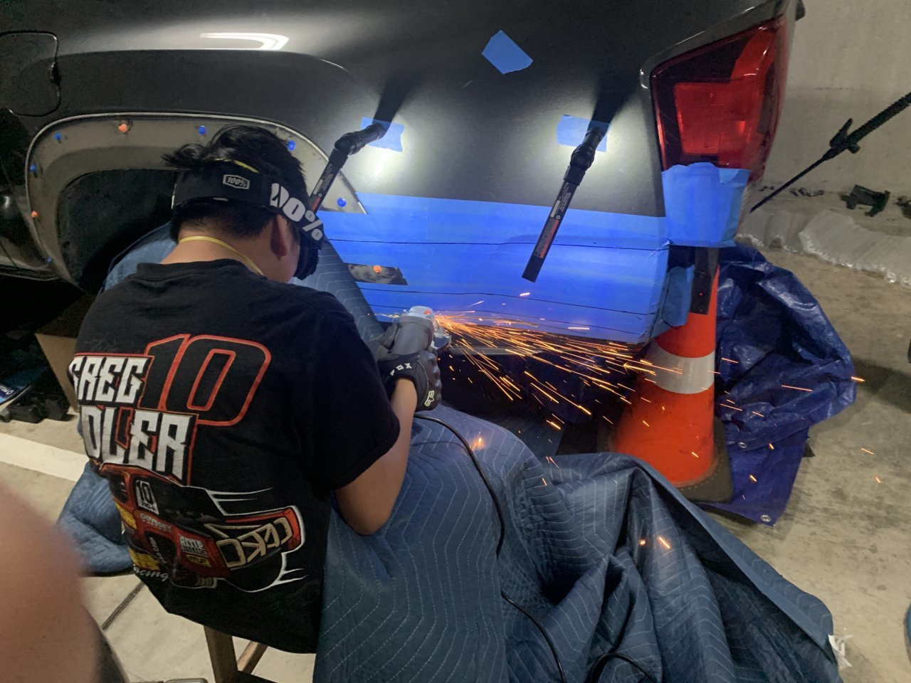

    Totally joking! I used someone else’s method from earlier on. I got a piece of lumber and used it to measure from the top of the bed sides 17.75 inches down the side. I measure at multiple points then used tape to make a line.
    I then used a grinder and cutoff wheel to make the cut, it cut really easy. I saw some people took off their fender flares, I left mine on, also with the inside liner, didn’t have any issues. I only had it on for fitment, just took it off to get it painted.
    OH, biggest thing.. have help. My buddy came over... this is NOT a one man job, and I applaud anyone that even attempts to do it by themselves!
    The stock bumper/hitch took some coercing to get off. After than we used a couple floor jacks and jack stands to help us mount it.
