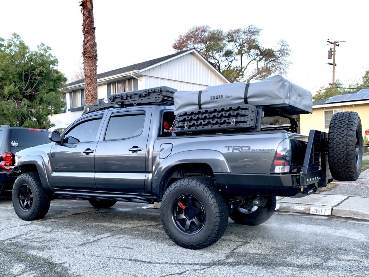

  17. Jan 27, 2021 at 4:07 PM
    #797
    Syner1
    Syner1 Active Member
    Nov 12, 2014
    #142210
    39
    Anthony
    Bay Area, South Bay
    2015 MGM TRD Sport 4x4
    Yakima BedRock System, Yakima FrontLoader, Foglight Anytime Mod, FJ TRD Caps, Derped Emblems and Sport Wheels, Matte Black TRD Sports Bed Decal, TRD Skid Plate, OEM Bed Mat, LED Interior Lights, WeatherTechs, Spidertrax 1.25", Avid Front Bumper Guard, Avid Slider Style Steps, BHLM, Black Depo Rear Tail Lights.
    CB7077BA-5881-44CF-9197-B958AE4AF0D6.jpg Installed mine and looks great!
    How do you adjust the latch? The left swing arm locks with no play, but the right swing arm has some wiggle/play. This is even before mounting the spare tire on it.
    loyaltothetaco and outxider like this.
  18. Jan 27, 2021 at 7:07 PM
    #798
    Blucuss
    Blucuss Well-Known Member
    Oct 4, 2014
    #139637
    172
    Texas
    2018 Super White Tacoma TRD OR
    • RAVELCO ANTI THEFT DEVICE with Three Plugs • 285/75/16 BFG KO2s on Stock TRD PRO Wheels • King Front Coilovers, 700lb Front Springs, Extended Travel, Remote Res with Comp Adjusters • King Rear Shocks with Remote Res and Comp Adjusters plus DOBINSONS TACOMA HEAVY DUTY LEAF SPRINGS • Total Chaos UCAs & LCAs • 5.29’s & ARB Air Locker • ARB Twin Air Compressor on SLEE Mount • Switch Pro 9100 • North Star NSB-AMG27F Battery • OGE Machined Aluminum Battery Tiedown • Upgrade Sound System - KENWOOD DMX706S / XR9015 KENWOOD Reference Fit 5 Channel Power Amplifier/ Custom Box 10" Single Sub Ported / KFCXW1000F KENWOOD 10" Shallow Subwoofer, 1000W Max / RSE165 FOCAL 6.5” 2-Way Component Kit Door Speakers • Custom Front & Rear Viewing Cameras • Sound Dampening Mat 4 Doors, Floor, and Rear • Redline Toyota Tacoma Hood QuickLIFT ELITE - Carbon Fiber • LRA 34 Gal Fuel Tank • BAMF High Clearance Rear Bumper with Rub Rails & Dual Swing out with Tire Carrier plus dual Squadron Pro S1 Baja Designs lights • C4 Fabrication Overland Series Front Bumper with Full Center & Headlight Hoops plus Front Bumper Frame Supports / Squadron Pro, Pair, LED Driving/Combo Cubes (Amber) Fog Lights / Center LED Bar Baja Designs - S8, 30" Driving/Combo Amber,LED Light Bar • CASCADIA 4X4 FLIPSTER V3 WINCH LICENSE PLATE MOUNTING SYSTEM • WARN® ZEON 10-S Platinum Winch • GOAT - CUSTOM Go Off-road Armor Tech • Ditch Lights - Squadron Pro LED Driving/Combo Cubes • Cali Raised 25 Degree Rock Sliders • Cali Raised Bed Channel Supports • ShrockWorks High Clearance Full Belly Skid Plates All Steel Construction • High Clearance TRD Exhaust Modification • Custom Horn from American Auto Horns • upTOP Alpha XL Roof Rack with Baja Deigns 30" S8 & Squadron Pro, Pair, LED Driving/Combo Cubes Facing the Rear • Weathertech Front & Rear Floormats • G-Tec Fab Door Sill Protectors • TRD Pro Front and Rear Leather Seats • MOLLE Panel, Double Cab Subwoofer w/power window • TheTacoGarage Dashtop Multi-Mount • MESO Gas Hole • MESO Custom Fuse Cover • MESO Coin Holder • SDHQ Built Billet ABS Guards • Multimount Panel - Seat Jacker Mount • MAXTRAX MKII FJ Red Traction Boards
    Mine does the same on the right. I just wrapped the bolt with baseball bat tape and it tightened up. Not the best fix but good enough until I figure out something permanent. I have had it for a few months now and no concerns.
    Syner1[QUOTED] likes this.
