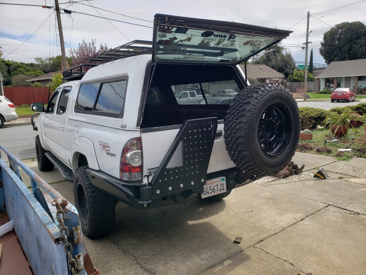

    Here’s how mine turned out. Hope it helps.

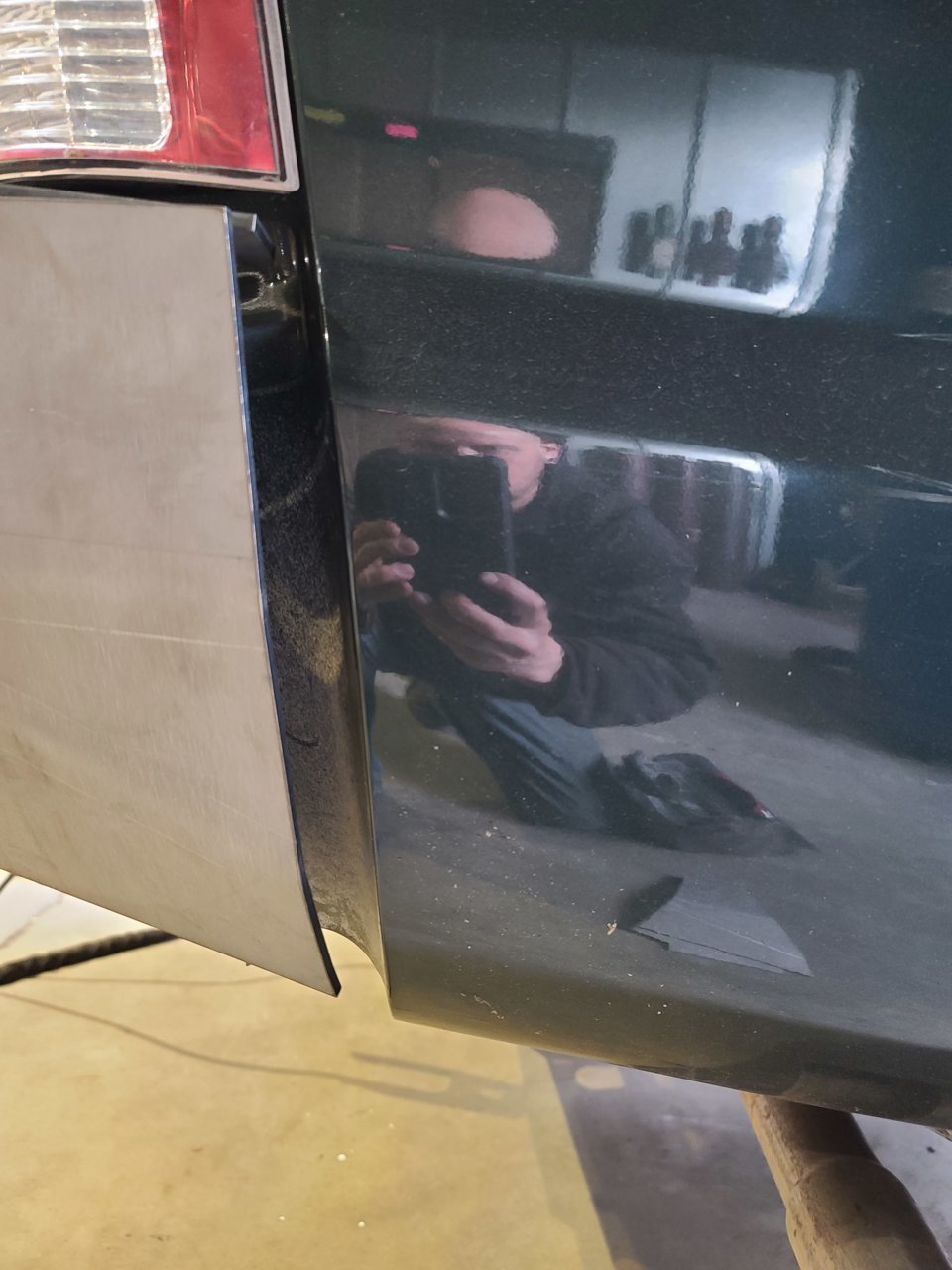

    im tryin to figure out how to stop the cut under the tail light, do i jus got a 90 deg. cut,do i round it out.... basically i jus dnt wanna cut too little and when me and my buddy try to put the bumper up it dosent go on

    Ah! I know what you mean. I ran into that problem on the part below the taillight. Make sure to leave some metal sheet for support. Here is how I made the cut and hope you can see it after I zoomed in on it.

    Thats the money shot!.....yea.... i cut way more lol, where u stopped i basically made a 45 degree angle and cut down, i figured since it was jus material jus sitten there for no use any more, i went to the black plastic flap, down and around it so the plastic tab still works and then sliced the corner and tapered it to the spot where the long nut is sticking out20210313_165408.jpg

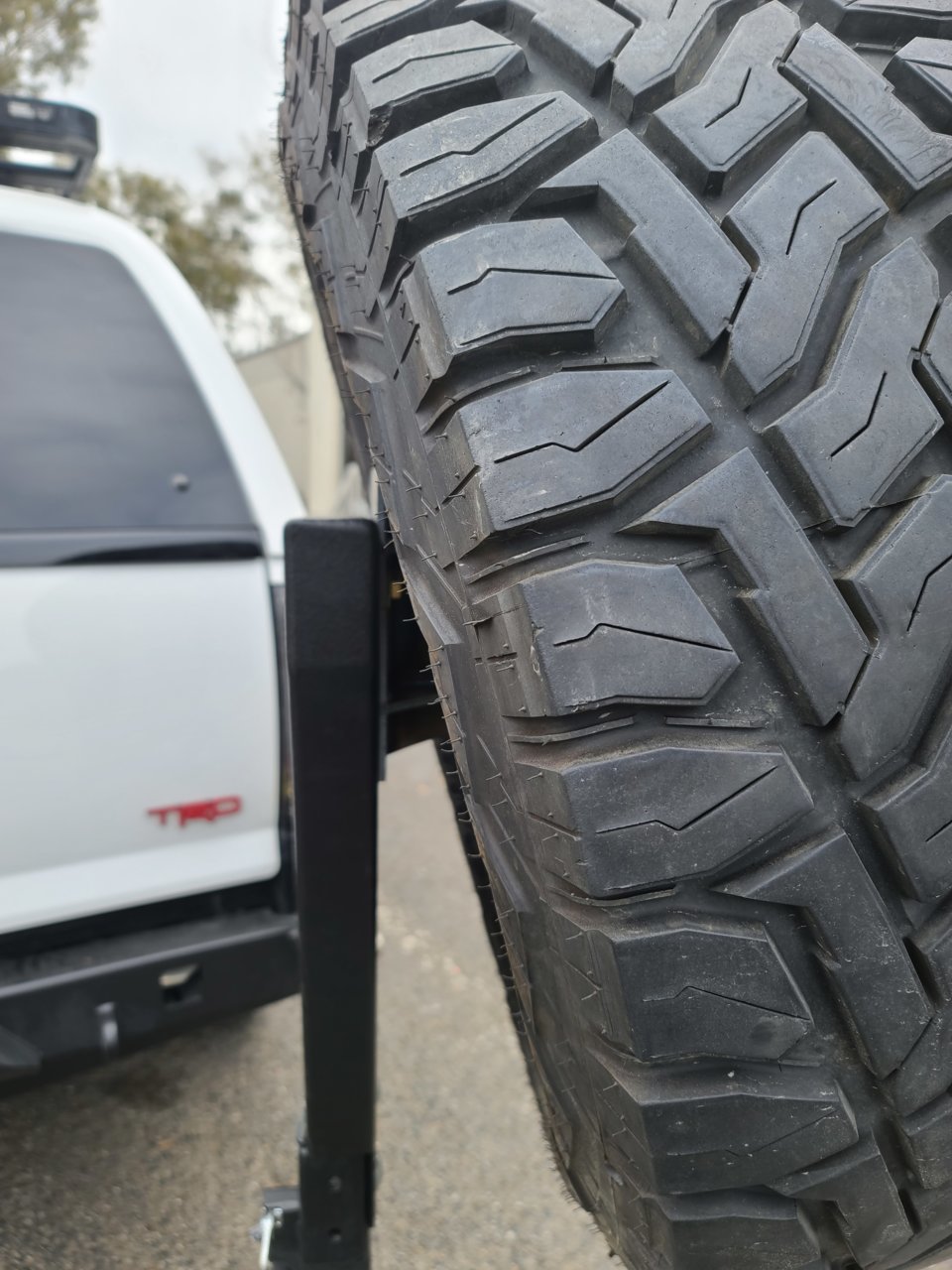

    Angled tire mounts.
    15 degree slope, they will need to be mounted high with larger tires or the tire will hit the upright. We will also offer spacers for the deep back space guys.

    Doesn’t the tire stick out farther, effectively making the truck even longer? What’s the benefit?
  17. Mar 17, 2021 at 4:39 PM
    #877
    outxider
    outxider Never stop exploring. Rest in Paradise Big Bro.
    May 9, 2010
    #36858
    2,081
    Sang
    East Bay, CA
    06 DCSB 4x4
    A few mods here and there and counting....
    The benefit is it looks awesome. :D

    I can only speak for myself- aesthetically,
    I like the way the angled version follows the shell. Functionally, I justify it as the angle will give a better departure angle
    Midship909 and JLee[OP] like this.

    It does, it's a look thing really it has its pros and cons.
