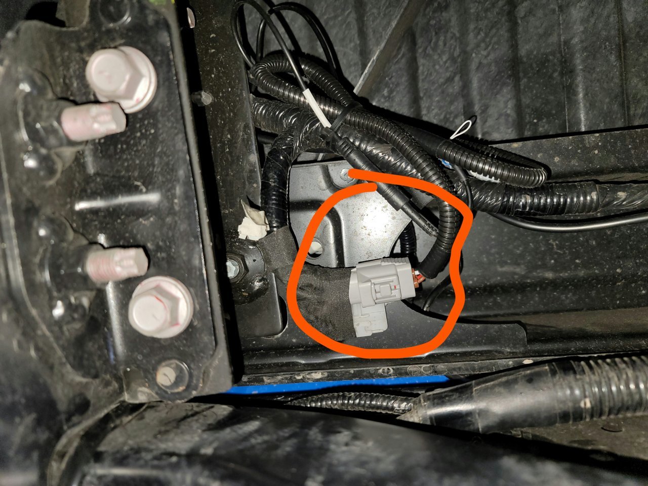

    did you rewire it to the stock harness plug?
  2. Aug 14, 2021 at 12:36 PM
    #1062
    Impoy47
    Impoy47 YOLO-HA!
    Dec 27, 2018
    #277070
    369
    R-nel #KN6UYM
    East bay Tri Valley, Ca.
    Xwing T-19 Pro Voodoo Fighter
    Yes, see pic, circled in red.

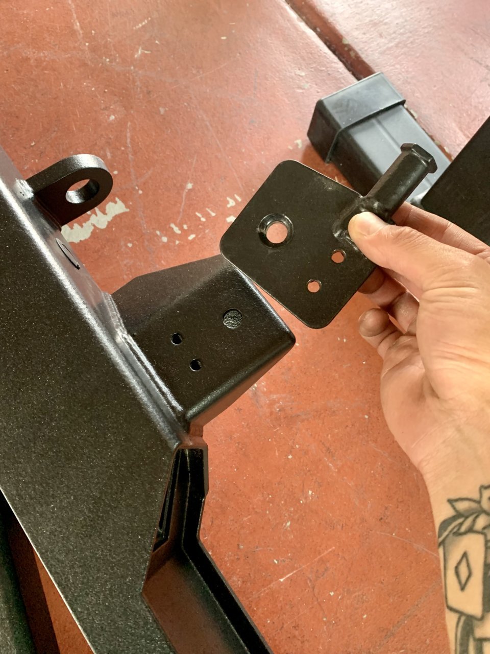

    Anyone know what size hardware for the latch pin plate? My kit didn’t come with all the necessary hardware so I’m trying to head to the store today. @JLee
  10. Aug 15, 2021 at 3:59 PM
    #1070
    thebaker
    thebaker Well-Known Member
    Feb 14, 2009
    #13597
    2,507
    Byron
    NorCal
    Upgraded to a 3rd gen
    Never ending......$$$
    Just hit up Jerry....im sure he'll get it out to you asap since you were missing the hardware.
  11. Aug 15, 2021 at 4:07 PM
    #1071
    Gat_
    Gat_ Don’t be shattered.
    Dec 18, 2018
    #276236
    880
    Bay Area, CA
    '19 Cement Tacoma TRD OR M/T
    I did, thanks! Hoping someone else knew cause my bumper is going on today and the plate seems impossible to put on once the bumper is installed.

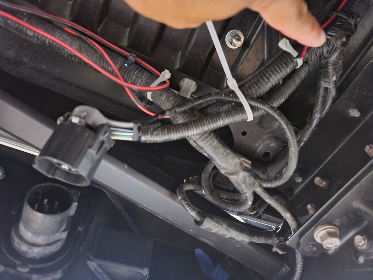

    When talking the loom off the wiring for the plug, did you guys just take off up to where the wiring intersects with the larger bunch of wires? Or do i need to take off more?
  14. Aug 15, 2021 at 6:34 PM
    #1074
    RangerComa
    RangerComa 58008
    Mar 14, 2017
    #213317
    2,829
    Adam
    Marin, CA
    17 DCLB
    list is growing fast
    I took it off to that pint and tugged and didn’t seem to offer much more length. I’m guessing you need to go further. Full disclosure I quit at that point. Fuck it. I don’t need to tow right now.

    No hardware was in the bag with those? Sorry about that.
    It should be two counter sunk 3/8thx1" bolts with nylocks. and 4 1/4x1" button heads with nylocks.
  16. Aug 16, 2021 at 10:34 AM
    #1076
    Gat_
    Dec 18, 2018
    #276236
    880
    Bay Area, CA
    Nothing in the box.
    Any particular site or store you get them from for a specific grade?

    Get SS and if you have an Ace nearby, that would be the ideal place to find said hardware because my local Home Depot sucks.

    They are not graded bolts standard 18/8 ss is fine.
