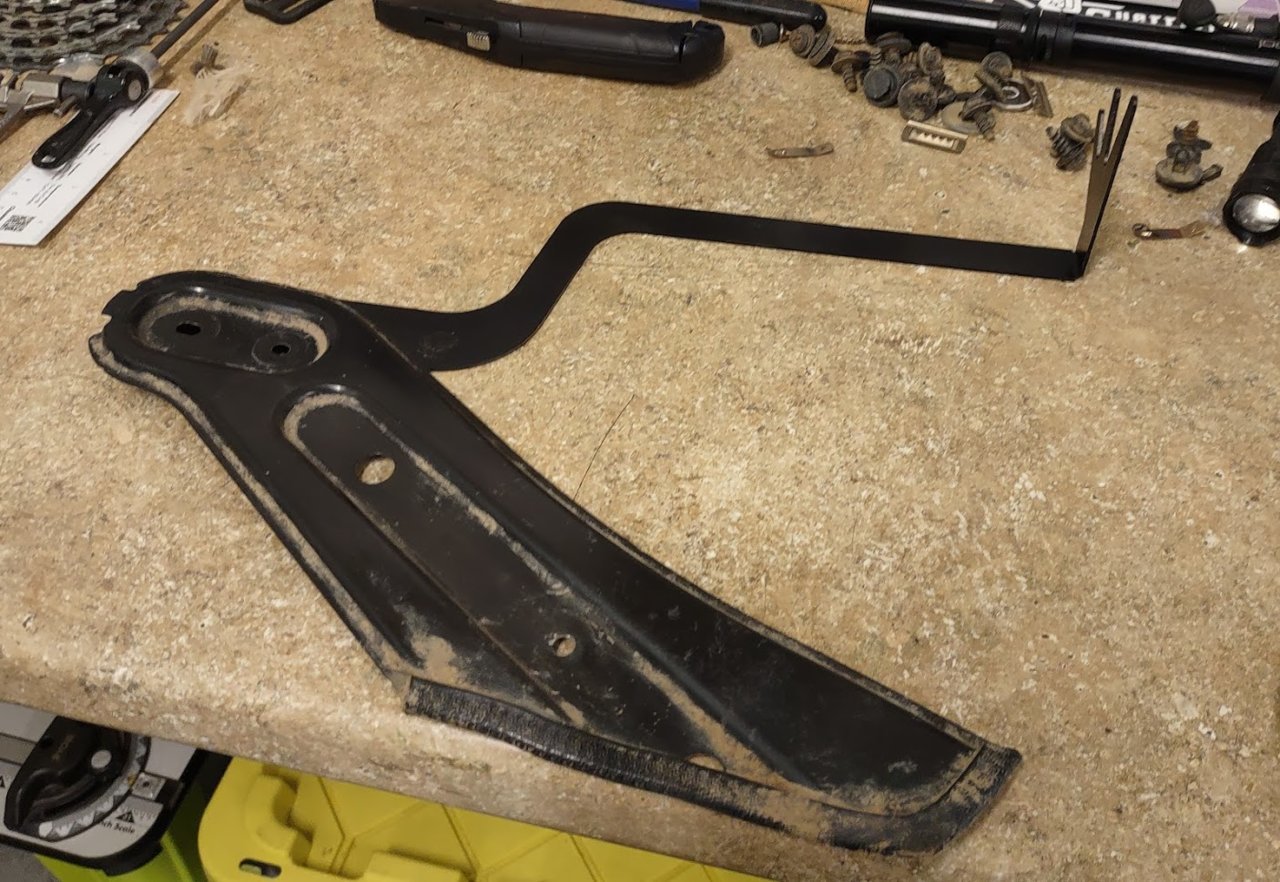

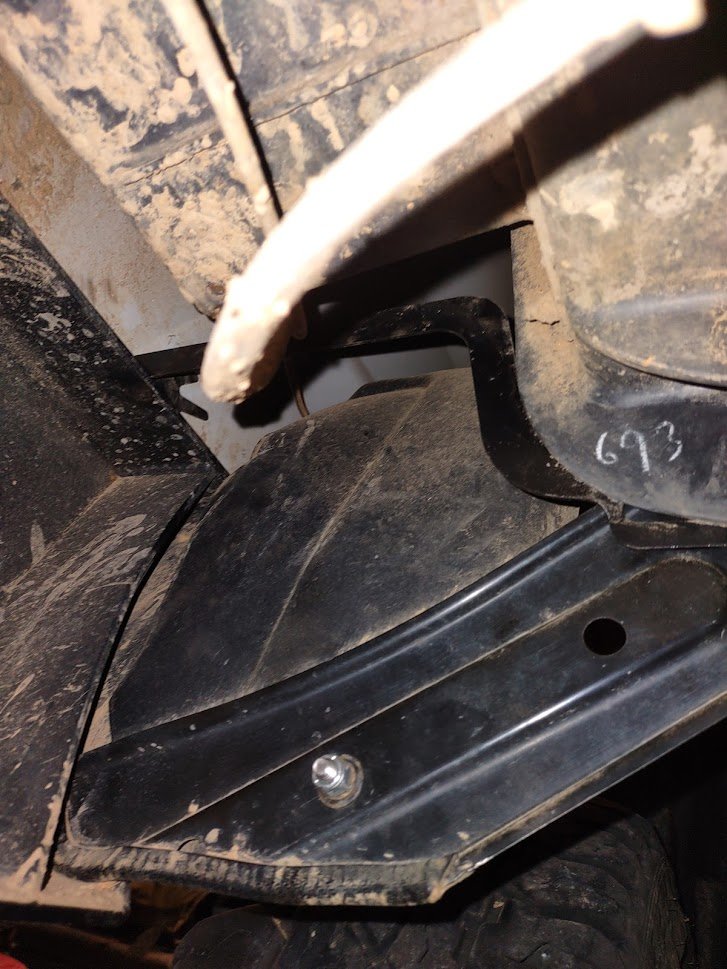

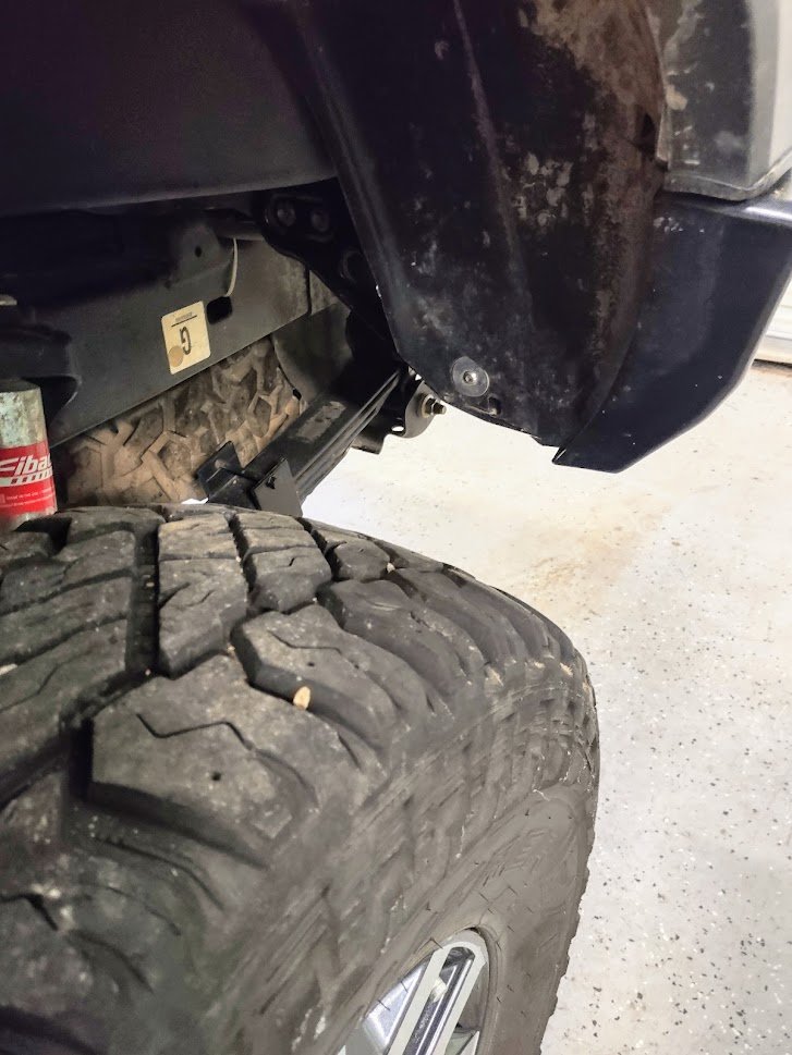

    AM-JKLWb-_CyOZ9ZAT0miUEPIEVzx1jBfjeNIrQo_fc84d094ee11f61ee13c2fabc8c67558c4848471.jpg
    AM-JKLWVwOIzWmJJGGadMlbT4NAgZo6gR9y2H3nk_481fd5eb00fadcaa7d5d9a64e1070e56ab599728.jpg
    AM-JKLXOIendOlYzU2EIXxuvpuZUeJwpNPsdHfzK_35408c72e8c9ed084a9d3a45659ad96c14cf2049.jpg
    Installed the bedside stiffeners today so I thought I'd show my solution to keep the fender liner intact. I used metal shears to cut the stock brace jawn down so it'd fit inside the end of the BAMF bumper, used edge trim to protect from rubbing, and added a 1/4" bolt to hold the liner in place. Pretty straight forward but I figured it might save someone some head scratching.

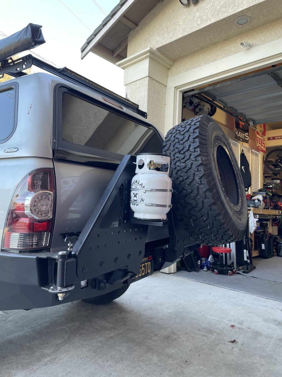

    BAMF propane mount.
    44C6BC9B-DA2B-48E4-BBC6-AC42B792A43C.jpg 0ADB4D4D-7EF3-4A48-ADEE-3D6CCEAB6AA1.jpg

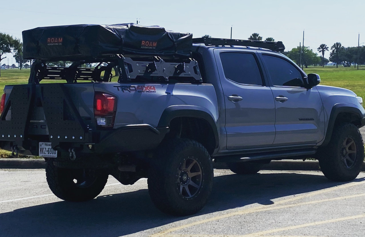

    I can finally post the pic of “the bumper” that I’ve been anxiously waiting for. Couldn’t be happier with it!CFE39F50-F471-4416-9586-1E6982F43D91.jpg
