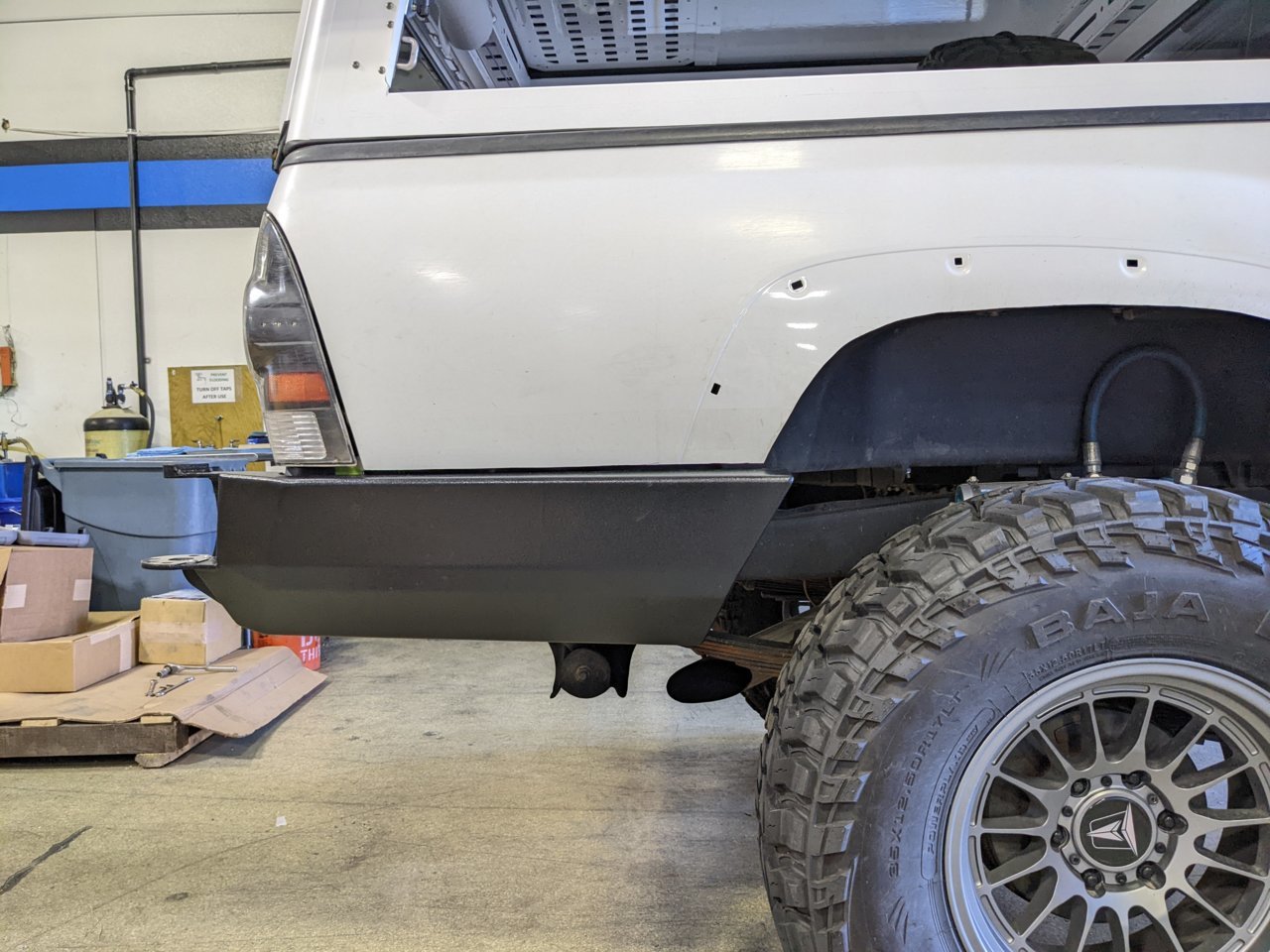

    Is there a way to confirm the bumper was cut for 35s @JLee ? Before I get too far into this, just wanted to make sure. I cut my fenders and flares for my 35s months ago..

    Was your measurement from top of bed rail to your cut line the same as mentioned in the 2016+ install instructions? 17.75"? Just trying to confirm my measurements. Think I can get away without removing my camper.

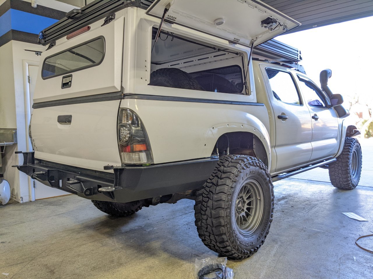

    Where are you guys putting the tire mount for a 35?
    Guess it's just going to take some trial and error for fitment of everything.

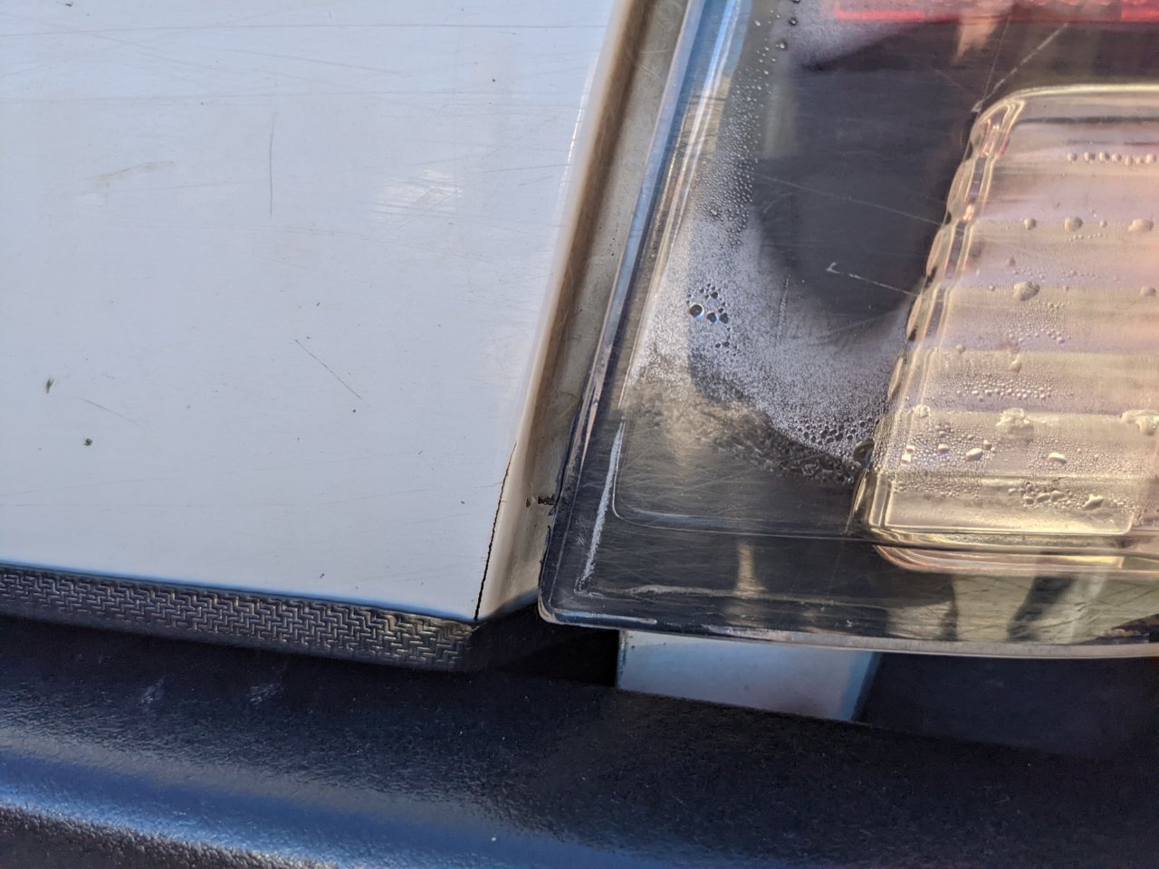

    Need to add the tire mount for my 35, the Single Jerry Can, and my propane tank/mount. The Jerry can and propane mounts are a little confusing. I think I figured out the order and locations for the Jerry Can hardware. Also, I didn't receive any washers or back plates for the propane mount hardware (just bolts and nylon nuts). I'll need to source some fat fender washers for the backside/inside of the Jerry can mount.
    I did notice (and this is from me not having any bedside supports for a while) that the last little corner of bedside material under the tail light.. is barely hanging on for life. It's cracked almost all the way through, and separated at the pinch welds. The vertical crack running along the crease, and another one barely visible running horizontal. Soon they will connect and there will be nothing to keep that section together. I hope to add some jb weld to the backside to deter any more cracking. Once I finish the bedside supports, it should help a ton. Unfortunately.. the damage is already done.. but like I said.. this was my fault leaving them unsupported for so long.
