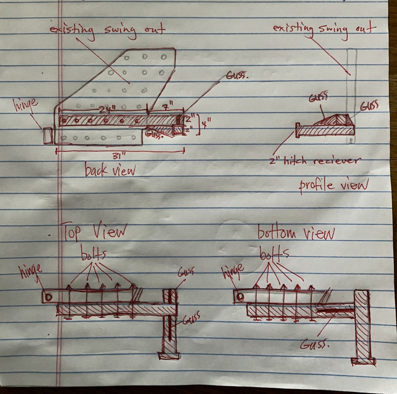

    Double down. I’ve been thinking of fabbing something like this for a while now. Here’s my drawings of what I’m thinking. I have the same 1upHD rack with two trays.
    My only concern would be the hinge… havnt figured out how much force it can safely handle. @JLee any idea what the max load should be on that?

    Figure those hinges are designed to hold a spare 35” wheel/tire combo at the very least… And you know BAMF stuff is overbuilt! Guessing you’d be fine with a couple of bikes and rack mounted on them.

    I agree, my only concern was the load cantilevered out away from the swingout and the hinge.

    You could have a mount made that bolts onto your swing arm that has a 2" receiver in it then use your bike rack :notsure:

    I dont see a problem holding that set up on the arm without the tire. Better yet how about we make them on our tube laser? Seeing how it's for light weight stuff it could be mostly 2x2x.120 wall tube and we have been looking for more short parts to cut in that size to minimize waste.

    Okay sounds good @RangerComa if you want to stop by with your bike rack sometime soon I can make to the dimensions above and we can check clearances with the 1UpHD.

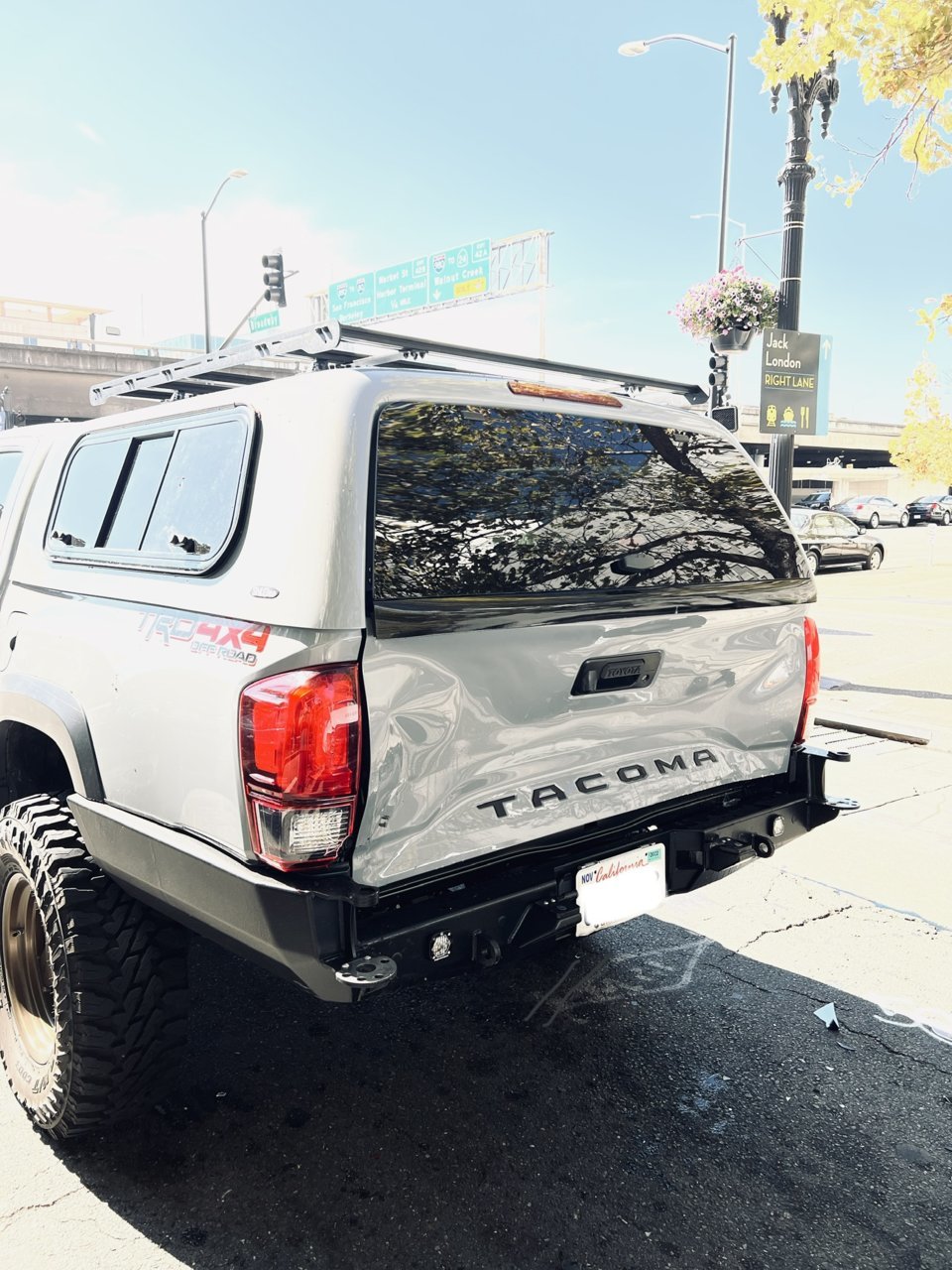

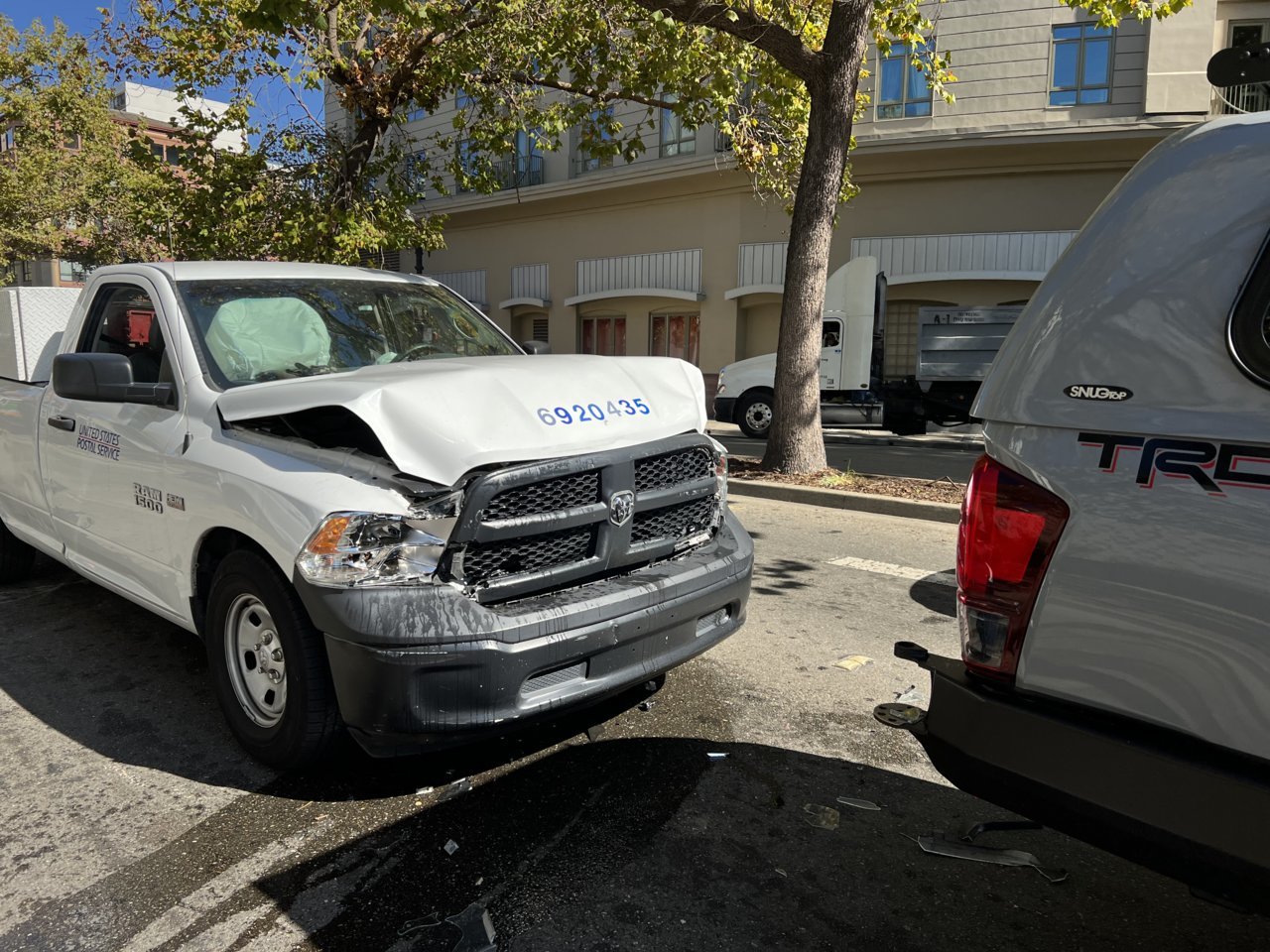

    Well, I can say this bumper is a an absolute unit. Rear ended earlier this week in the lovely city of Oakland; dude was going about 20ish. No visual structural damage to the bumper - any areas you’d recommend I double check, @JLee ?
