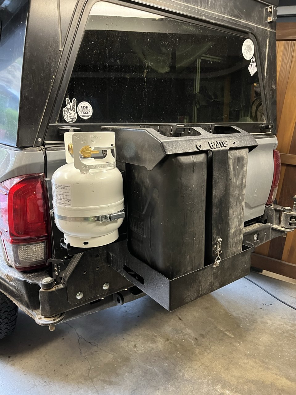

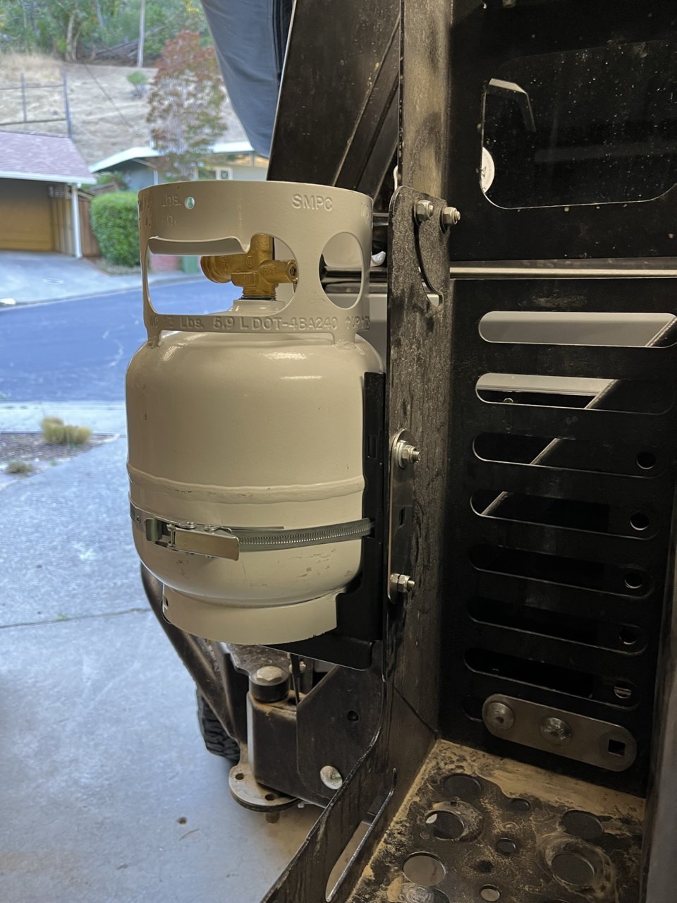

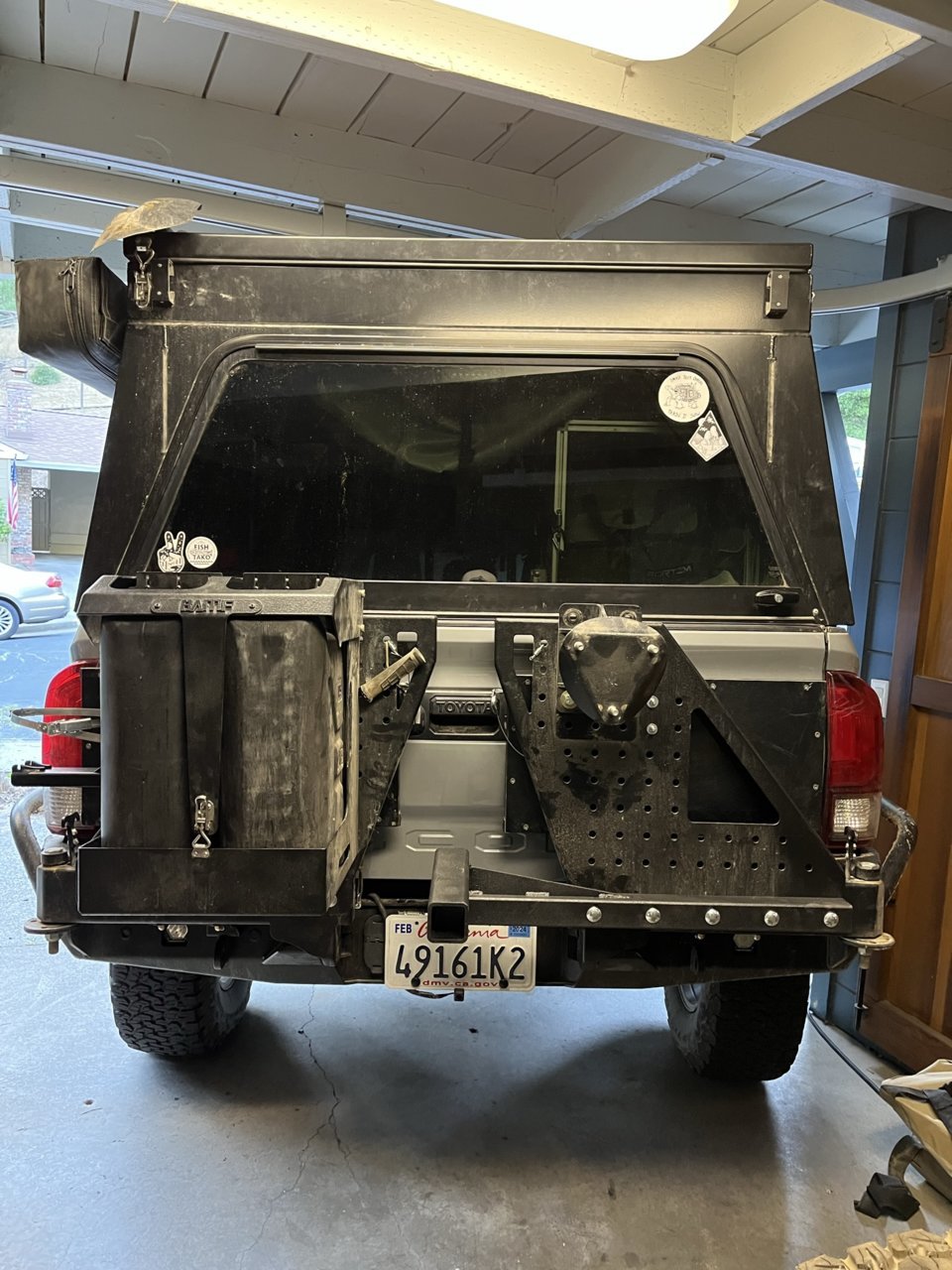

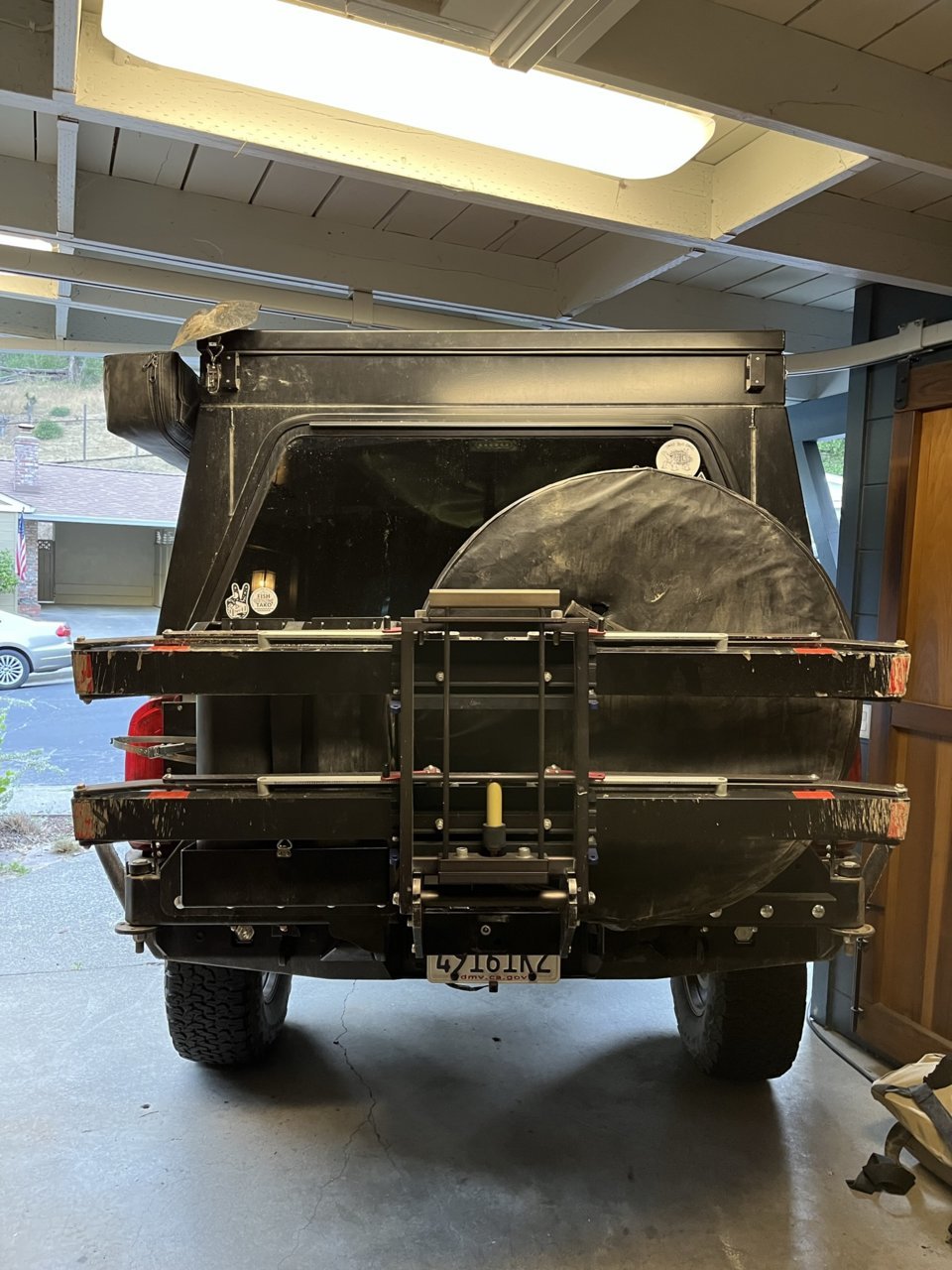

    Propane tank and bike hitch rack installed. Thanks Jerry!

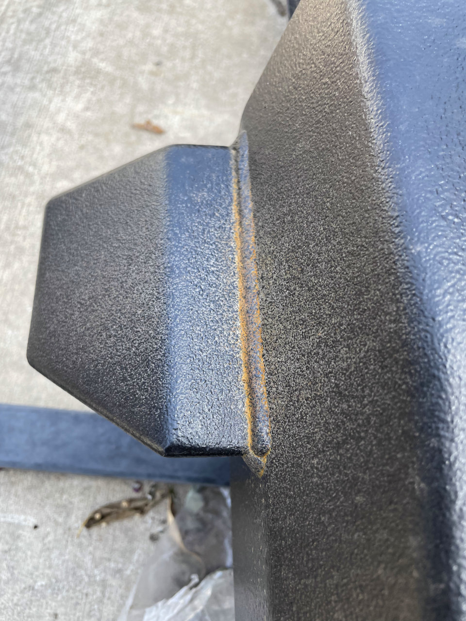

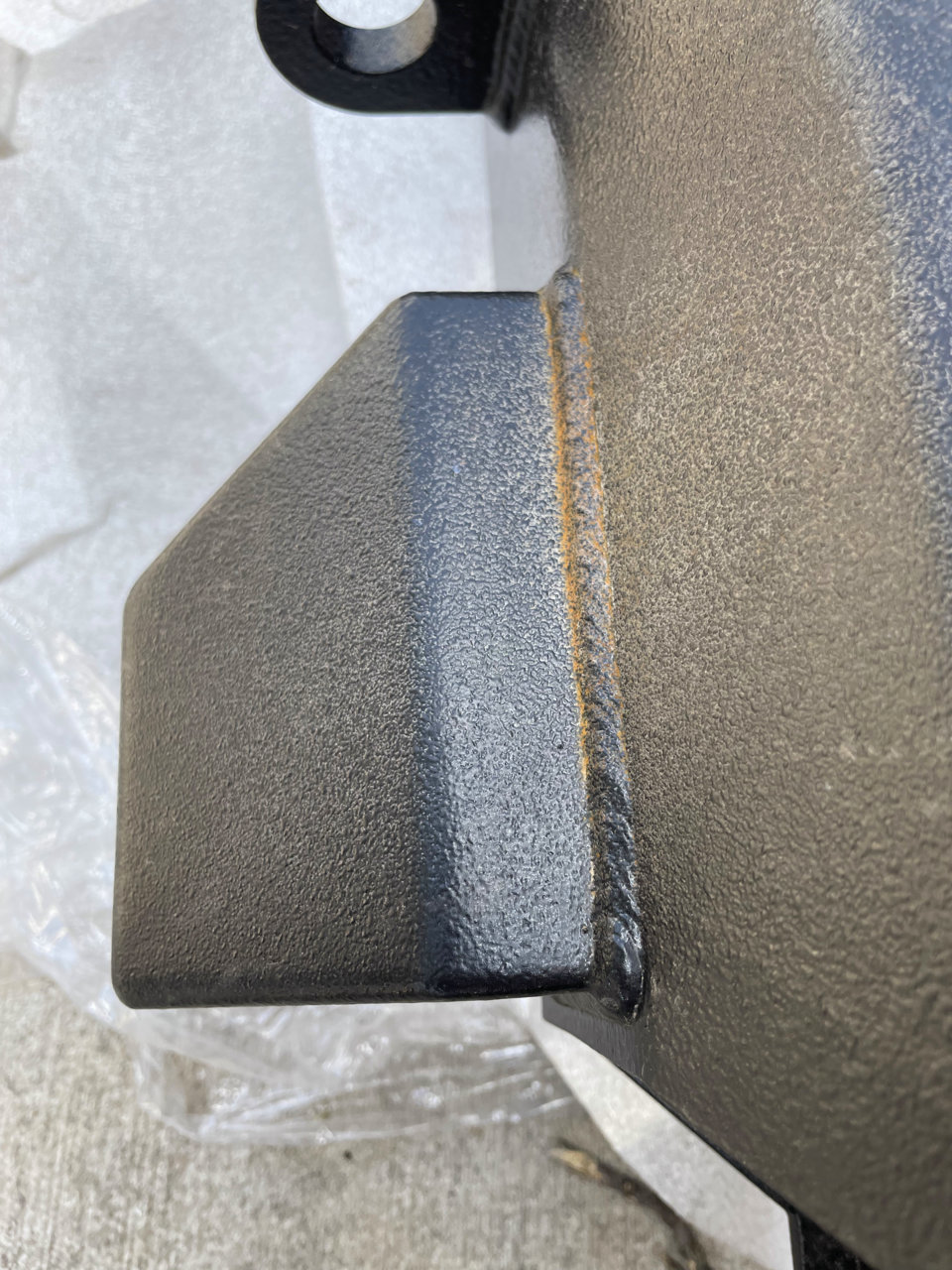

    I was about to start the process to install my rear bumper. I noticed it appears that it did not get fully powder coated and there is some rust forming on the underside where the swingsouts go. Does anyone have any suggestions/recommendations on what I can do?

    That looks like the rubber like coating from BAMF, which is not powder coating. BAMF sells a repair kit to recoat scratches, gouges etc.. If this is a new bumper email Jerry and he may send you a kit. You will need to prep the area with a wire wheel then recoat. After sitting in a couple rain storms I have the same issue on quite a few areas. I have the kit but haven't had the time to use it, and some of the areas are really not very accessible.

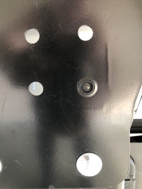

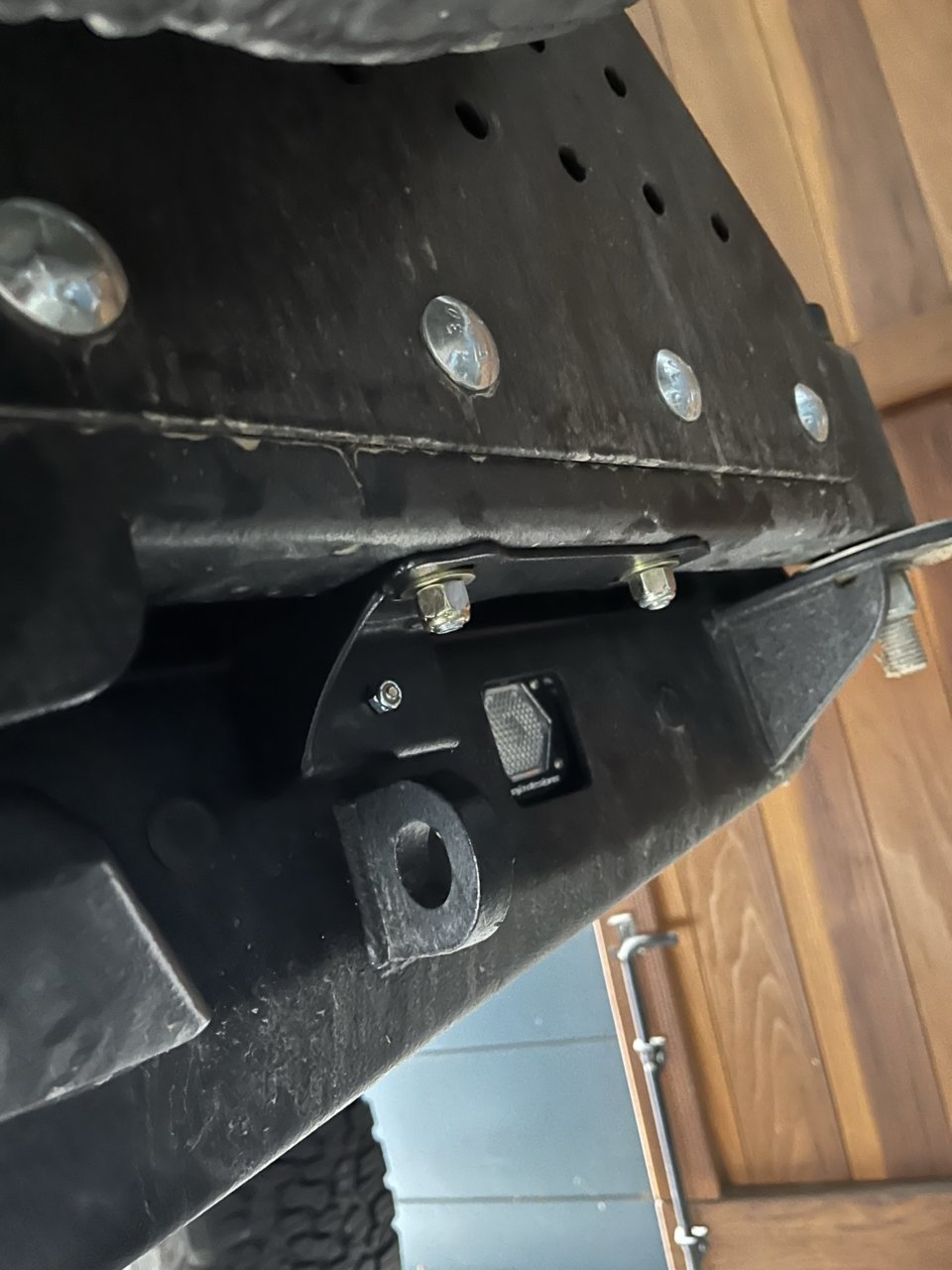

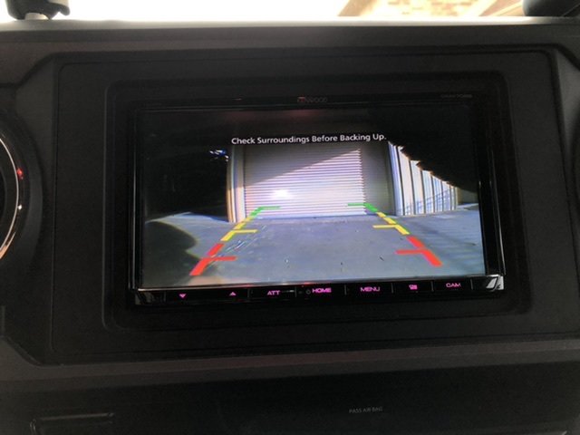

    How and where are people mounting their backup cameras? I have the relocation mount that came with the bumper, I’m just unsure the best location to place it.

    How did you run your wiring? Do you have any photos? Trying to figure out how to mount mine.
