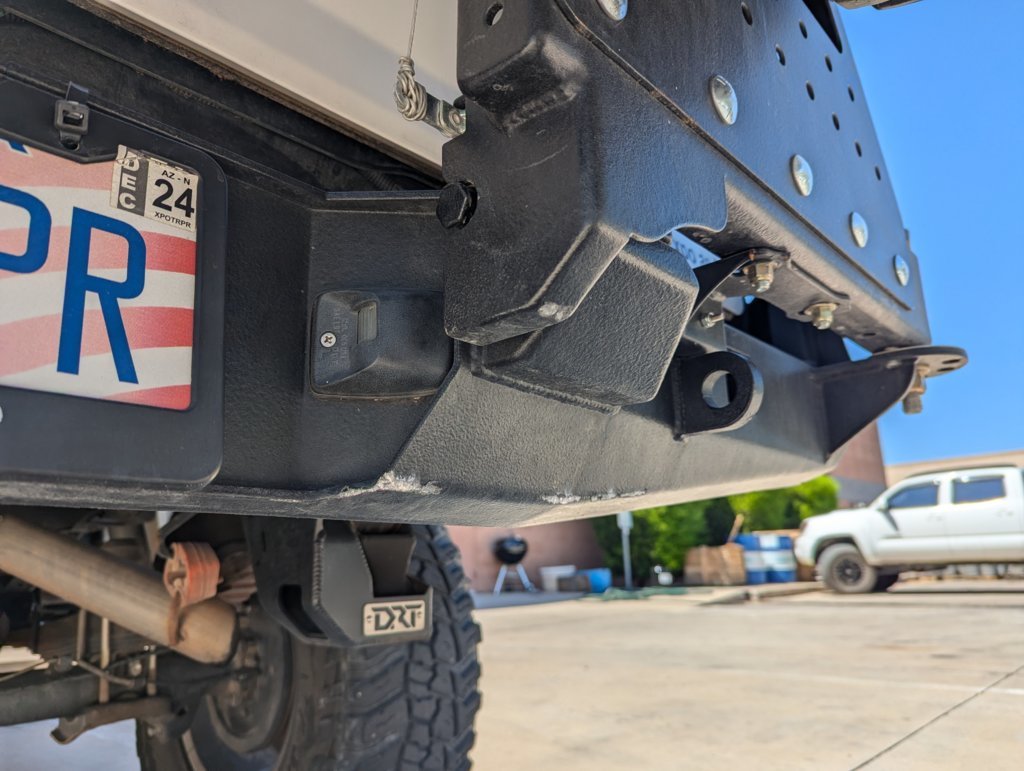

    those are the bumpstops Jerry has to add onto the bumper to help with some of the slack in the latch.

    Oh interesting mine doesn’t have those

    they are an add on. I put mine on after the fact. Reach out to Jerry and he can probably send em out.

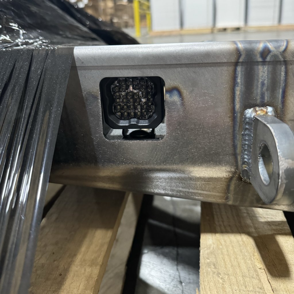

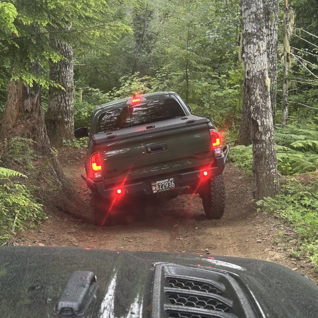

    Love the diode dynamic light pods. Big fan of the fact that they act as an extra brake light and a reverse light.

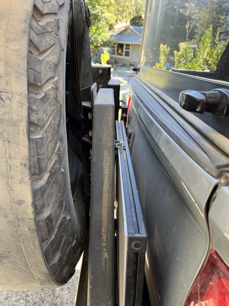

    As for install, I had to modify the bracket and shave off some of the pod for it to fit flush in the bumper cut out. Here is what the pod looked like before any modifications.
    Modified bracket
    View of the bumper’s mounting bracket

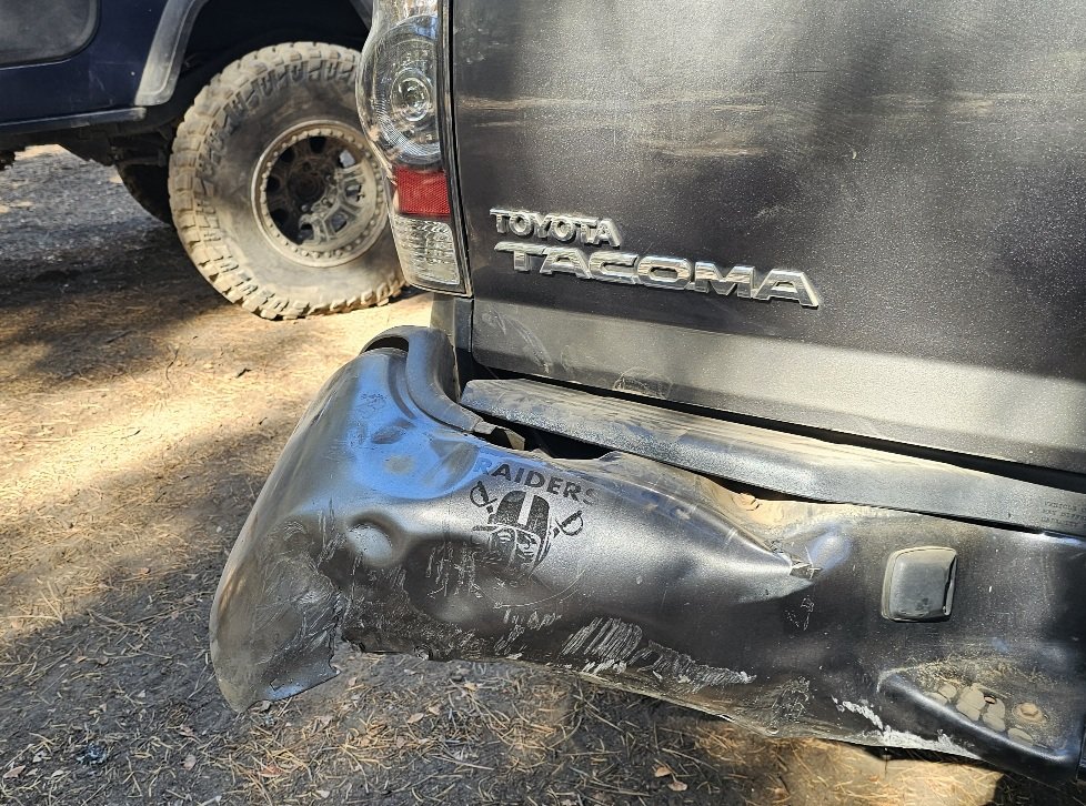

    Ever wonder maybe I can rock crawl and not get a high clearance rear bumper? Here's what it looks like after a few months of serious abuse.
    My bamf hc rear should be done soon. Can't wait!

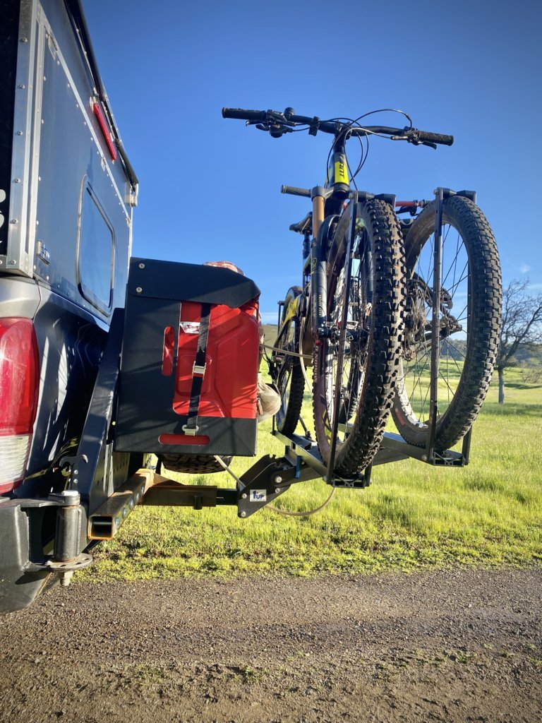

    a little beta about the hitch. I was the first to get it fabbed up and installed from Jerry…

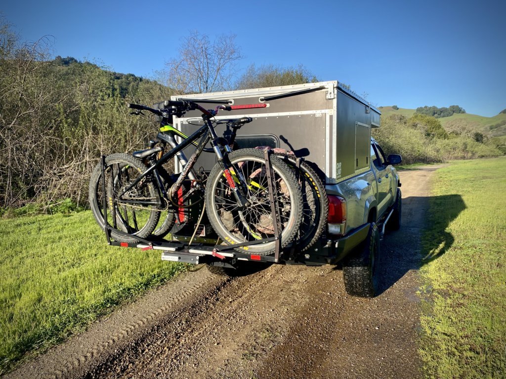

    I’ve bounced around on quite a few longer trips (with rack and bikes on, ~10,000 ish miles on road and hundreds of miles off road) including slow moving rough rocky trails and moderate speeds on fire roads stressing it out, with two bikes on the rack about 70 lbs + 45 lbs = 115 lbs total. ( I’ve even put an ebike on there for a couple short trips (yes I know I’m pushing it). I have tried it on both arms, with Jerry cans and also on the tire side. I have to say that it’s holding strong. There is some deflection of the swingout arm aft from all that extended weight and bouncing, but I don’t see it failing.

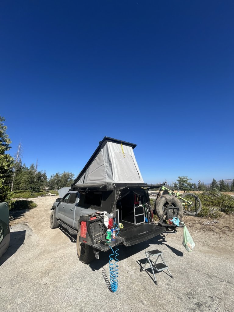

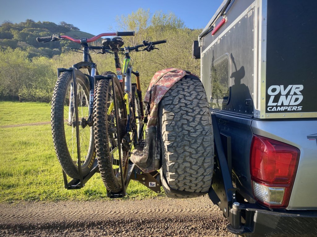

    I'd be a little leery of using that rack on the swingout if you also planning to carry full Jerry cans or a spare tire with it as well. That rack is about 80 lbs, plus 3 bikes you're looking at 200 lbs. My setup is my bike rack on the same side as my spare. You kind of have to do that unless your spare is small enough that you can open either swingout first. With my spare (34"), I can only open that side first because the tire overlaps the other swing out, so the bike rack has to be on that side too. I've got the OneUp HD, which is about 50lbs, and that alone causes some deflection of the swing out. With two bikes it's at the limit of what I'm comfortable with. Granted your lever arm will be shorter since it's tighter in to the swingout, but it's still a lot of weight. That said, I've had my setup for a couple years now and it's still holding strong. I haven't done any super crazy wheeling with the bike on the back, but it definitely goes off road with me and I love how high up it holds the bike. Helps keep it out of the danger zone!
    Here's the deflection on the swing out with spare tire plus bike rack.
