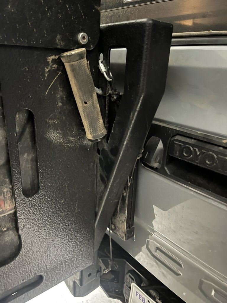

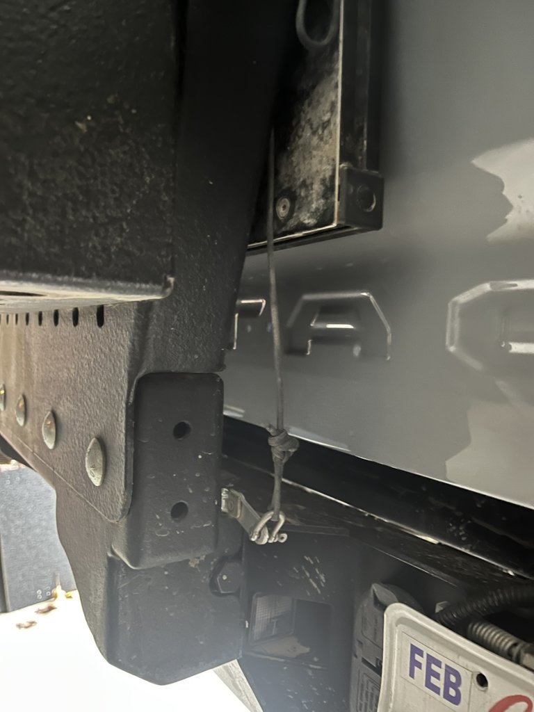

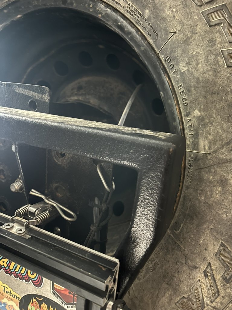

    Para cord from the latch up through the swing arms attached to wood dowel handles to reach from the back. Pull, open, Easy.

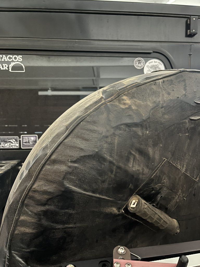

    I copied @RangerComa except added some old bike grips for handles, and some plastic sheathing over the paracord where it wraps around the metal edges. Works well and sure beats crawling under everything to open them up.

    oo i need to do that i have bunch of bike grips. you just drillled and knotted the grips?

    Exactly. I think I made the knot around a washer because the knots alone will eventually pull through the grip plastic. I'll probably upgrade to some worn out Ergons soon for a more ergonomic handle. :rofl:

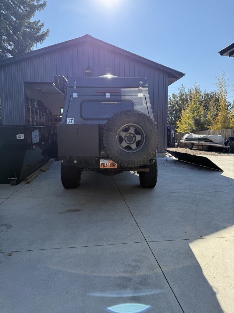

    Got my bumper yesterday and installed it last night. I'm looking forward to dragging this thing around the Sierras. Jerry cut about 2 in off of it to match my fender trim.
    I found the install of this by myself much more challenging than the front bumper which I also did by myself. I used a floor jack, jack stands and some cam straps that were hooked to the rafters in my garage to get it into place. This thing is built so well and it fits onto the frame so precisely.
    I'm interested to see how these rub rails work. It is my assumption that I can use them kind of like a rock slider and pivot off of things. My truck is so long that the ass end is an issue in tight spots.
