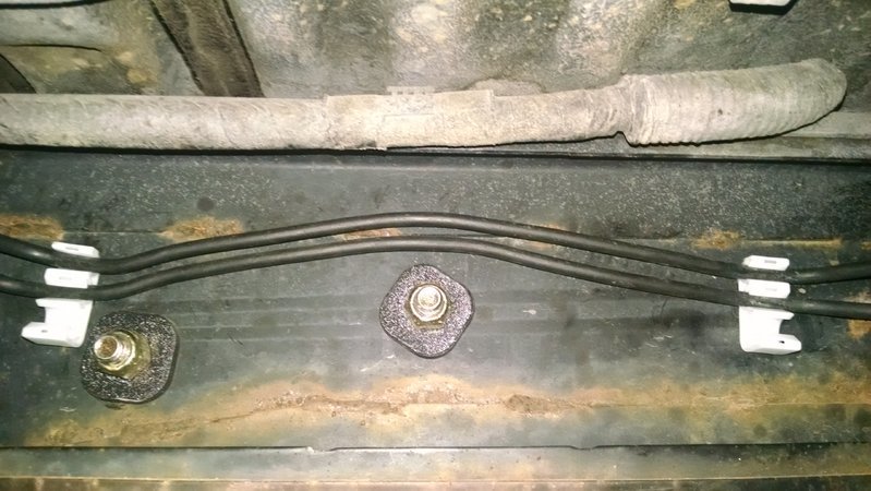

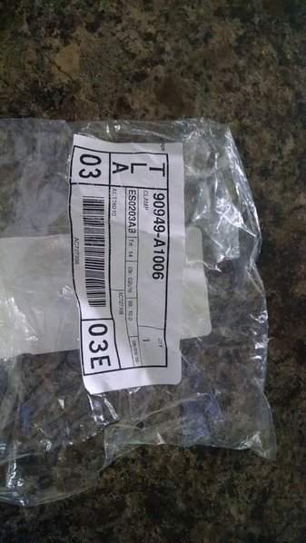

    I finally ordered and received my replacement clamps. FYI these are special order from Camelback Toyota so add a few days to your expected delivery time because they have to order then ship them....anyway, I inadvertently ordered 90949A10006, when I really needed 90469A0004...the only difference is the ones I received have three receptacles for lack of a better term with one being larger than the other two. This turned out to be a happy accident because once the lines are bent to clear the bolts they sit slightly higher than they originally did which would have stressed the other clips significantly. With these I was able to install them so the two needed slots sat on the upper side of the hole the clip mounts in, which I think is much better. Here they are installed.
