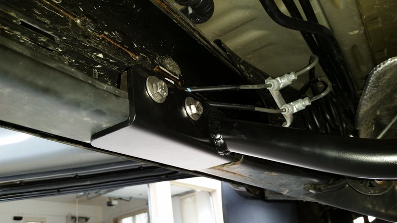

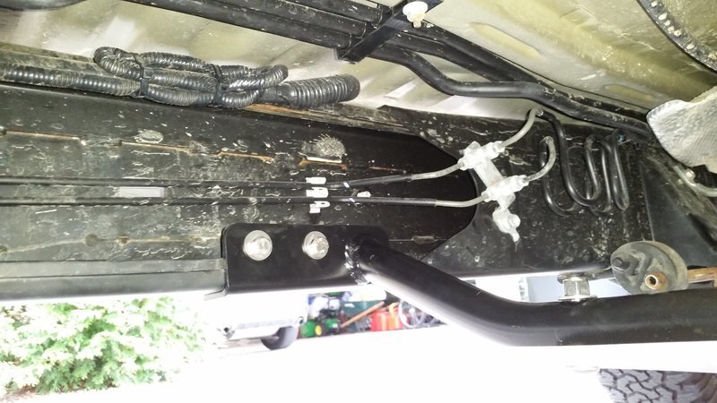

    Do you know if these are compatible with a Bud Built transfer case skid? The cross member is tubular and hits the frame with 90-degree end plates and a two-bolt pinch clamps. Here's some pics of them installed on my 2013 access cab.

    You would most likely have to trim something or hang the crossmember 3/16th lower under the slider frame plate.

    The second option seems best. I would just have to figure out how to make the pinch clamp work. Even without being attached the cross member would do most of it's work and stay put, but it would probably rattle. I think if I opened up the bolt holes in the cross member mounts and make them ovals with an additional 3/16" of height, I could put the cross member mount over the installed sliders and make it work. I might have to have a bigger clamping plate made, but 3/16" isn't that much, and the clamp isn't a precision fit anyway.

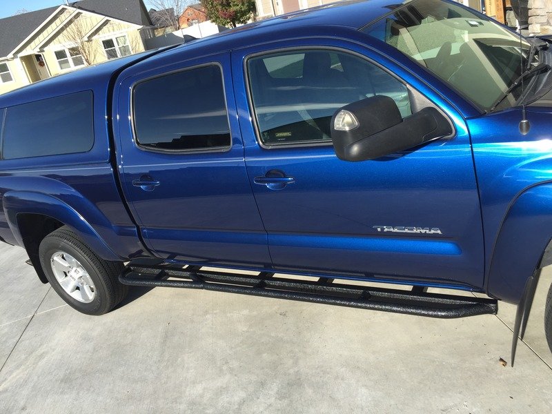

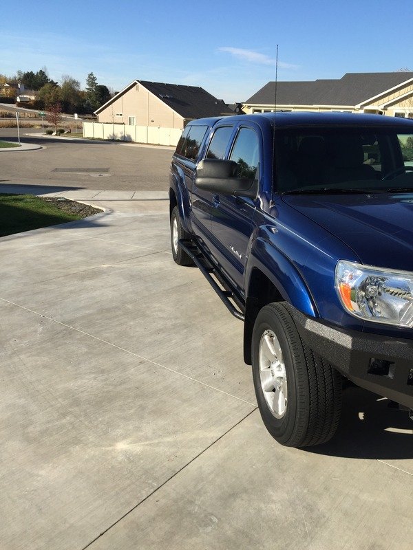

    I just got my sliders installed and I'm happy to say they look awesome! I also wanted to let everyone know, since I didn't, Jerry resolved the issue with the black box on the passenger side frame rail, the sliders now allow it to be bolted on without interfering with the gusset.
    Now I just need to finish the lift and put the new wheels and tires on.
