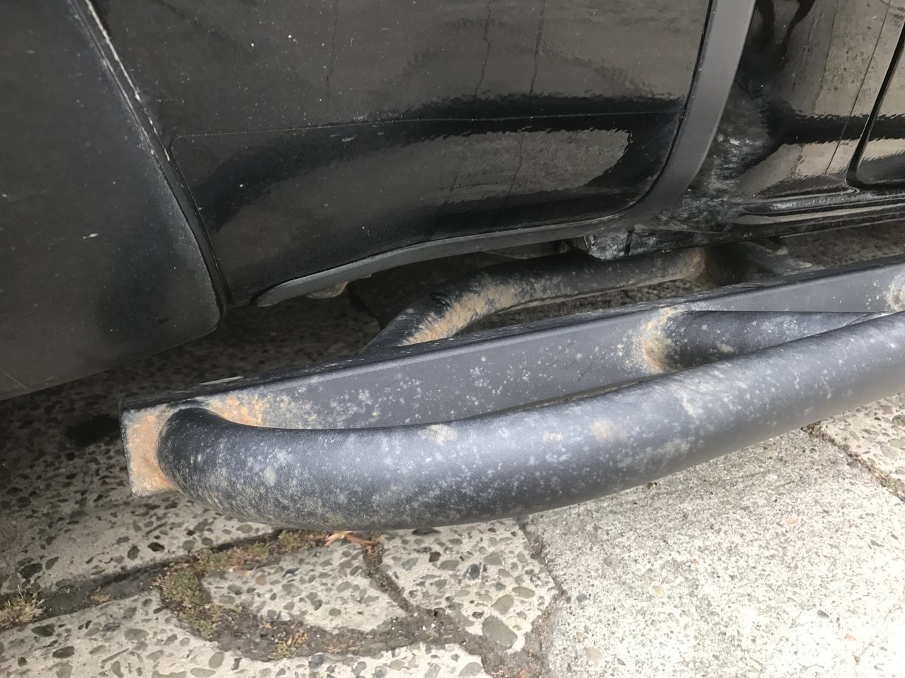

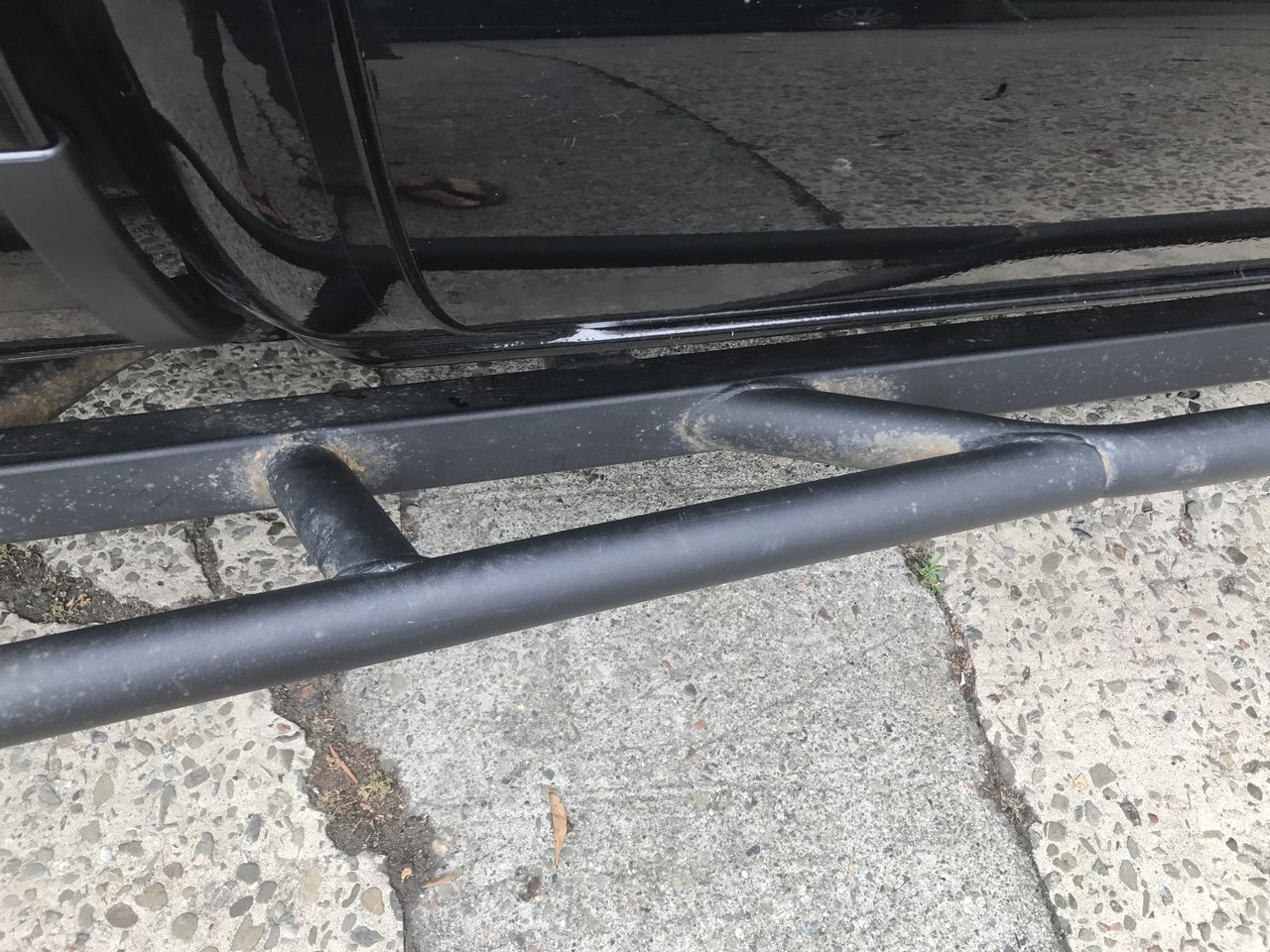

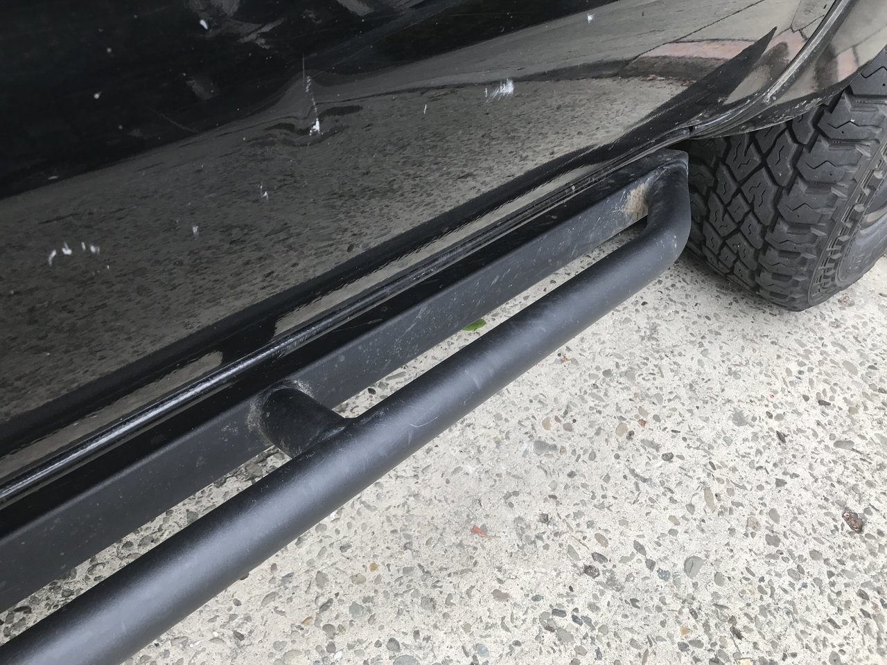

    Anyone have a solution for this rust that's starting to form? IMG_1836.jpgIMG_1837.jpg IMG_1839.jpg

    Sand it down and repaint with rustoleum spray paint.

    Ok do you happen to know what color rustoleum is a close match?
    And was there anything I was supposed to do to prevent this? They haven't even been on for a year

    This is a near perfect match https://www.amazon.com/dp/B003CT49B2
    That powder has micro pores and in wet salty conditions it tended to rust. We went with it for easy touch ups as it matched the bed liner well. Sliders should be touched up at least once a year if used properly and they should be taking a beating. The market has changed and not everyone is wheeling so no one touches up sliders and this powder didn't do well in wet conditions..
    We switched over to a thermoplastic coating that has way better salt spray protection back in December. Your under a year so you can bring them back to us to be blasted and re coated with the thermoplastic at no charge if you like.
