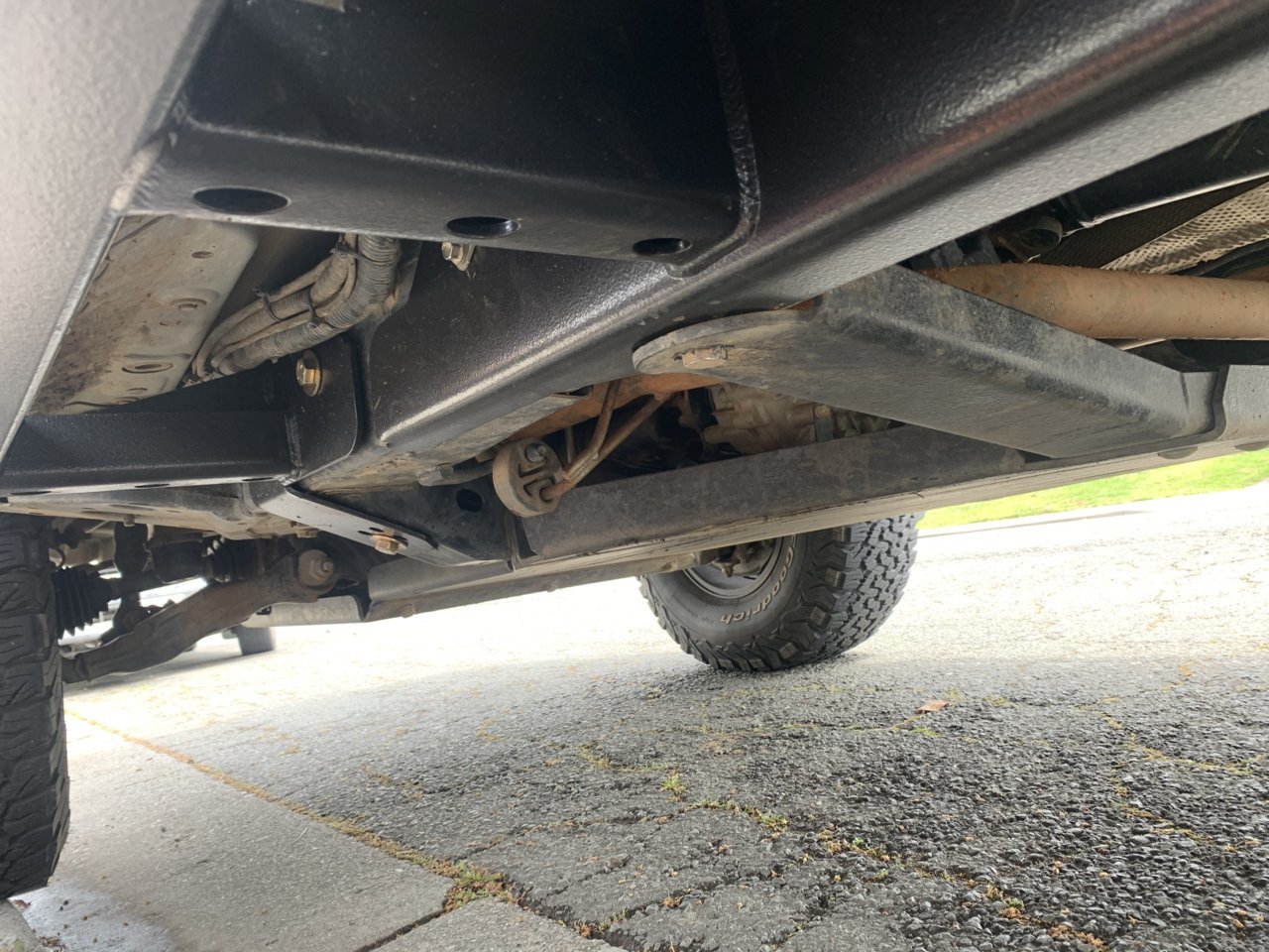

    6DAC5ADD-4869-49B0-8EB5-3211DDC52049.jpg Picked up my sliders earlier today... thought I’d throw em on before the wife got home from work (no wrenching allowed when she’s home :rofl:) and ready for use this weekend...
    Was bummed to find out I’m going to have to partially uninstall the BAMf transfer case skid, notch or drill the sliders to allow the BAMF transfer case skid to bolt up afterwards...
    Looks like the transfer case skid will sit the thickness of the slider backing plate lower.... should work in the end... install is going to take a little longer than expected :facepalm:

    All you need to do is remove that crossmember. Bolt up the sliders and drill a hole for the bolt with the skid stacked on the slider plate.

    That’s what I figured. Thx Jerry. I’ll get it tomorrow

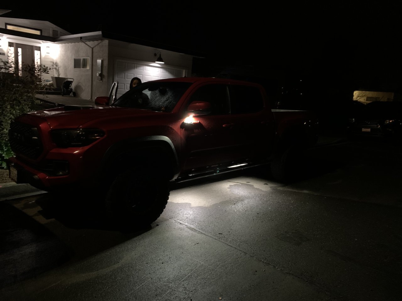

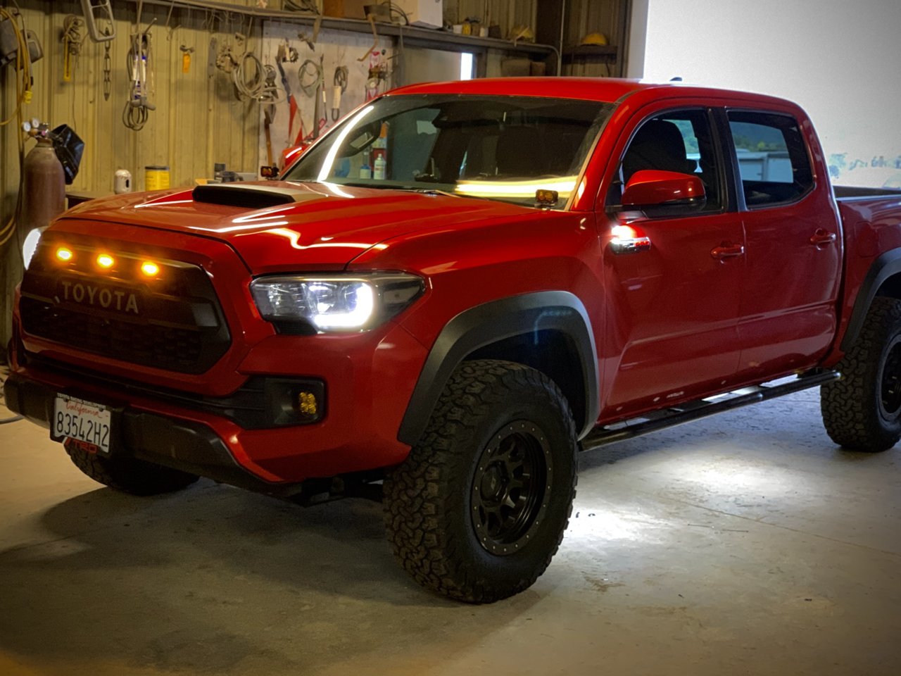

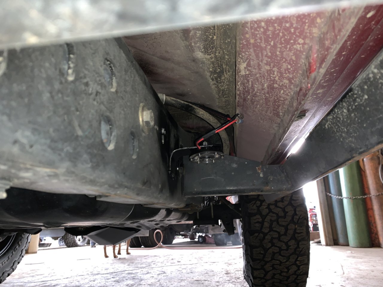

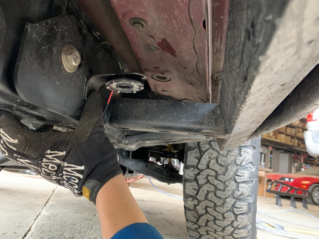

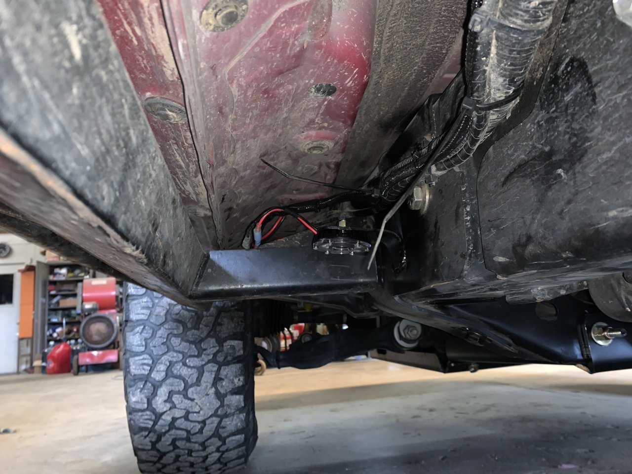

    I welded on some tabs for rock lights onto the sliders this weekend. Simple but pretty stoked! I think it turned out good

    Great idea, better protected, too

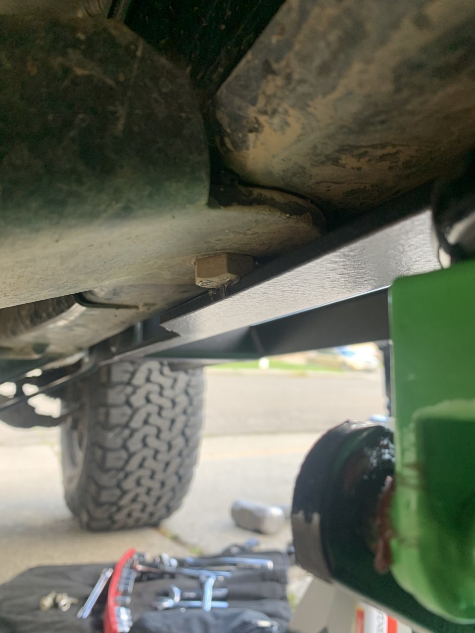

    Installed Friday... a few holes drilled, a few beers, and 2 1/2hrs... Well worth the lead time wait :thumbsup:

    What your t-case skid will look like with sliders... two holes drilled and it all bolts up
