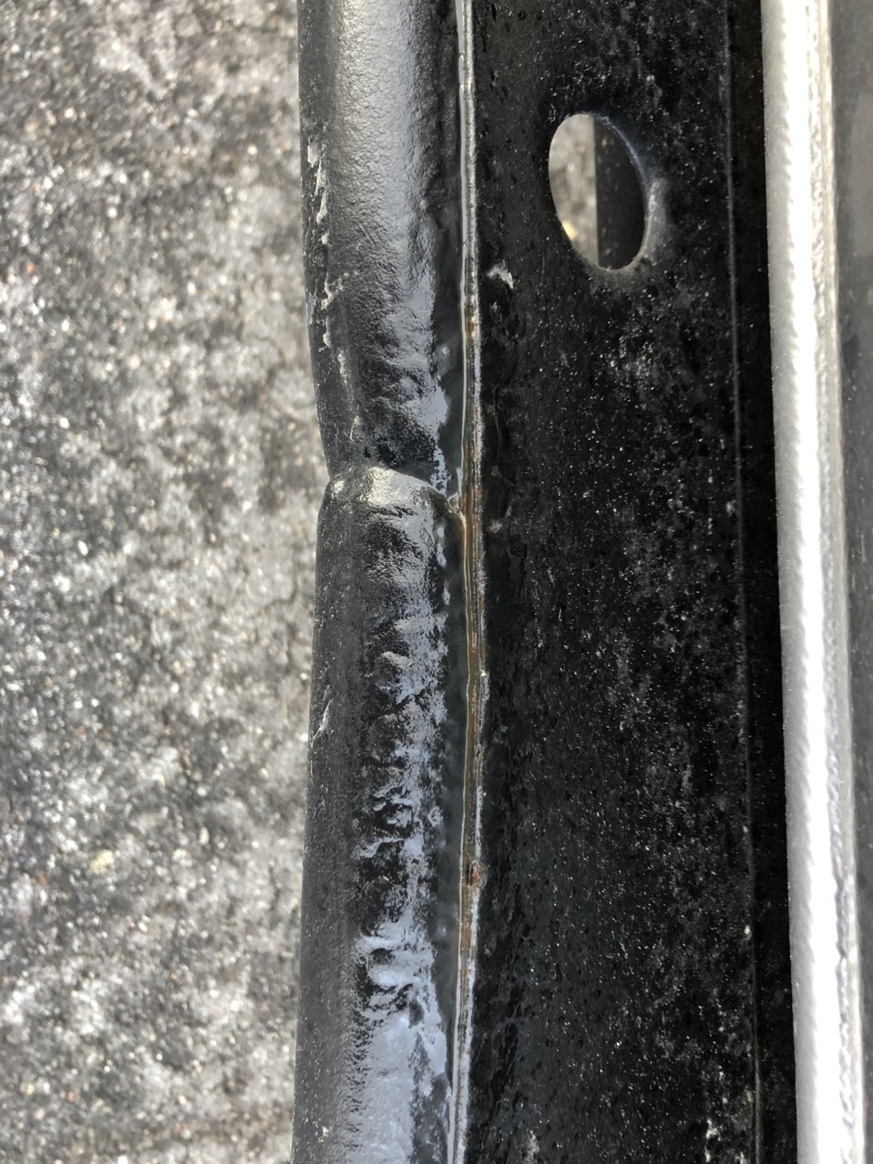

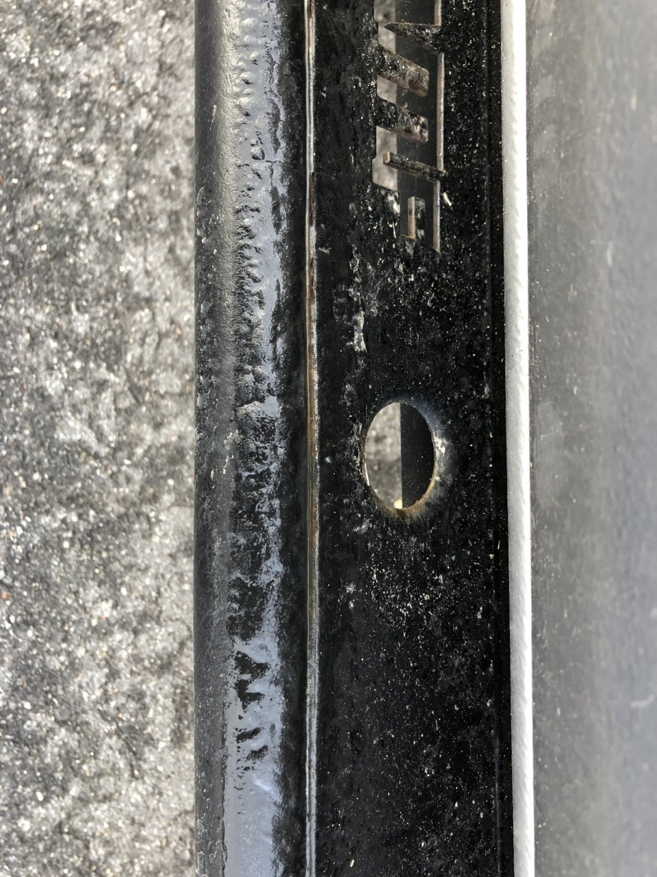

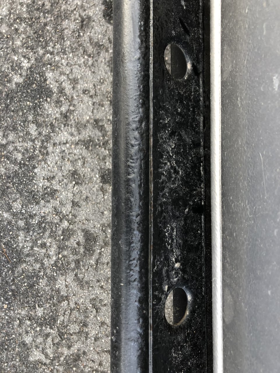

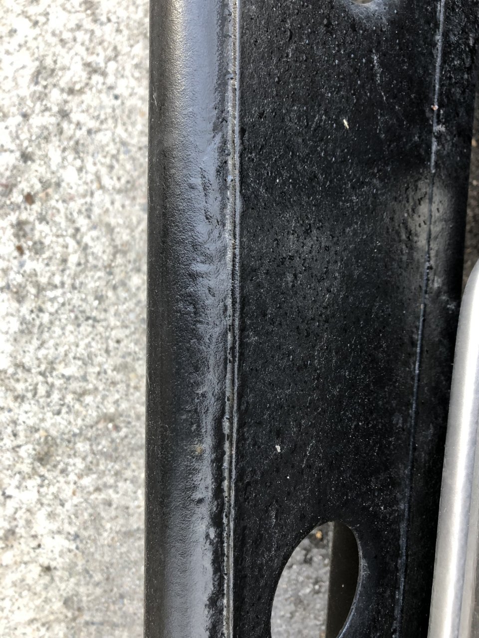

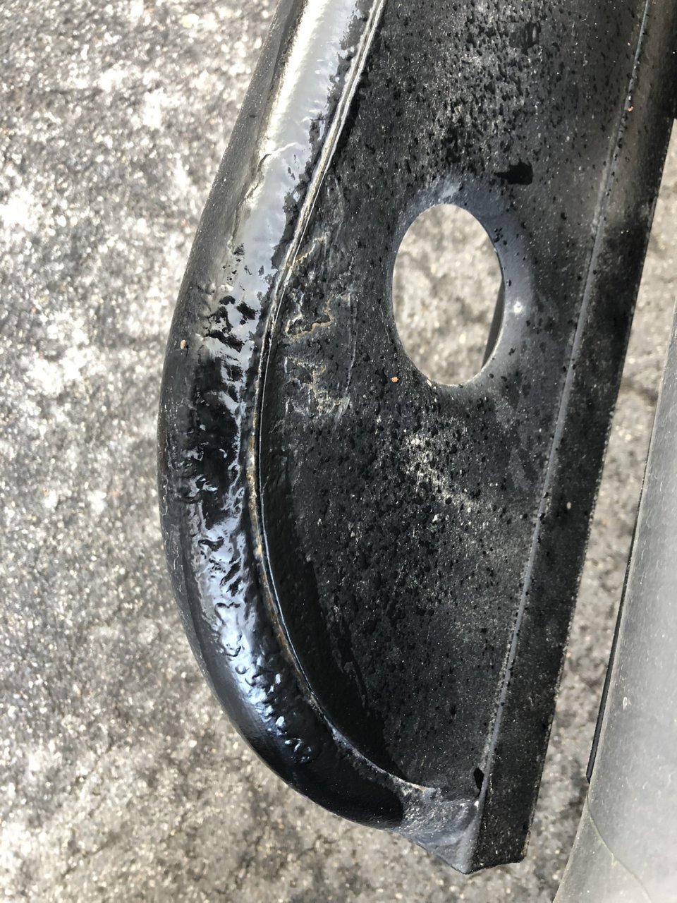

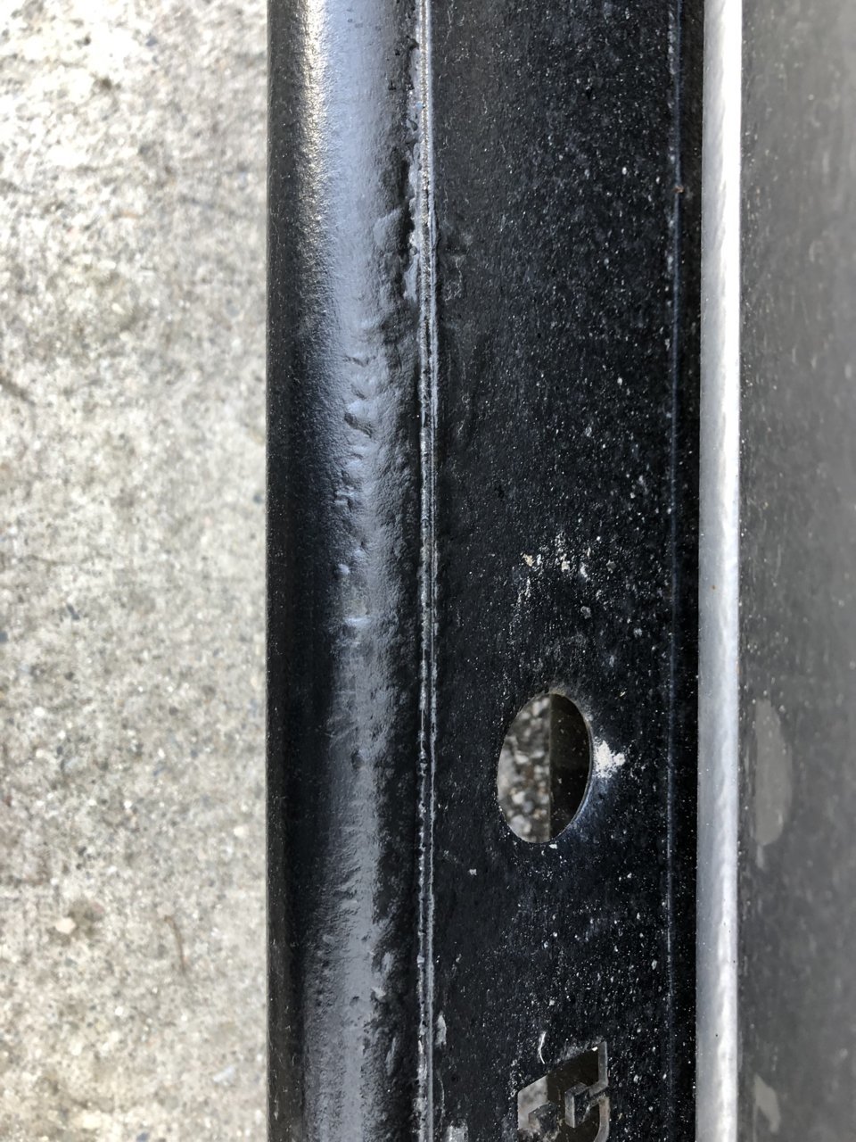

    So a heat gun can remove the bubbles? I am doubtful these are due to user wear. My truck is two door and I'm a bachelor. The bubbles are everywhere, on the passenger side also. SLC is a desert and pretty dry.

    Salt intrusion, you have wet salt water under the coating and continuing to eat at the metal underneath it. You let that get well beyond repair you will need to sand those areas to bare steel and recoat.

    Thanks for taking a look at my problem. You're right. So it would seem like filler plates are only a good idea in California and southern desert states.

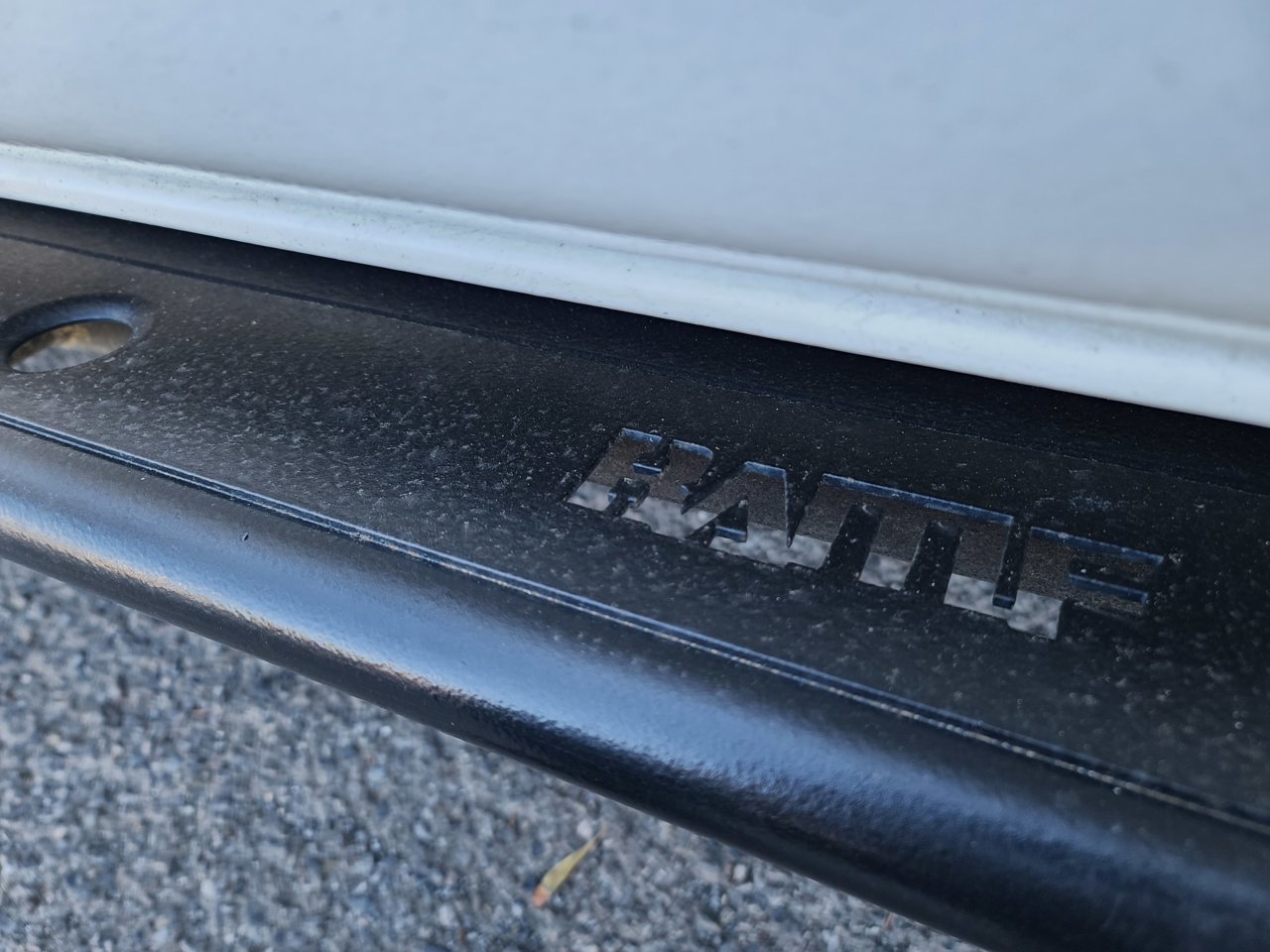

    Over three years daily driving. This is how they look without salt water intrusion. Yes being on the west coast helps a lot when dealing with rust.
    Any location that salts the road will cause rust you just have to make sure no bare metal is exposed and fluid film or rust prevention annually.
