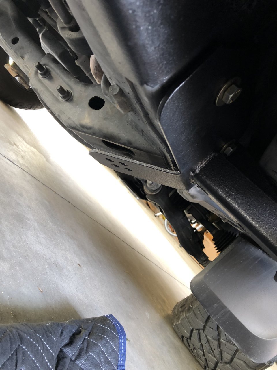

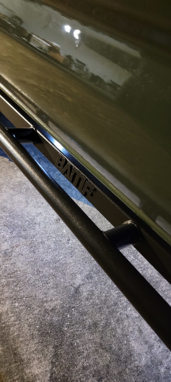

    Sliders delivered on Monday!
    Pallet seemed to take one hell of a beating traveling close to 3k miles but the sliders look just fine. Very well wrapped/packaged. These sliders are beefy! I didn't expect them to be this large (that's what she said).
    Install was a breeze for the most part. Was a pain to do by myself, but really just a tad bit slower and definitely tired me out. Just find a hole and then insert the bolt. Barely even needed the instructions.
    I did manage to break the plastic brake line clip when bending the brake lines to give clearance for one of the bolts. Kind of struggling to find the part number but my 15k service is coming due and I'll just ask the service advisor to find the part number so I can order it. I did make sure that the brake lines aren't going to rattle on any metal for the time being. **EDIT** Part number is 77285-04110. Cost $8.03 from the dealership shipped to me.
    I would recommend a cheater bar to remove the bolts on the bottom of the frame. I didn't have one so I used a dead blow mallet to strike my ratchet. No movement seemed to occur with the frame or cross member.
    Overall, I'm very pleased! It was a toss up between these and the Apex sliders so I had one of the kids pick which ones they liked the best. Excellent choice!
    The sliders do block the light from the SET LED illumination package some, but not too bad.
    Thanks for the awesome product @JLee!

    Did you have to drill out the holes a lil bigger for the supplied hardware?
  15. Jan 19, 2022 at 11:27 AM
    #1255
    ktbell444
    ktbell444 One who throws exceptions
    Aug 8, 2017
    #226306
    2,969
    ᚺᛖᛚᚺᛖᛁᛗ
    Nope! Just placed a bolt everywhere one would fit. Few nuts and bolts left over but reading through the instructions and other comments it is normal depending on the year.

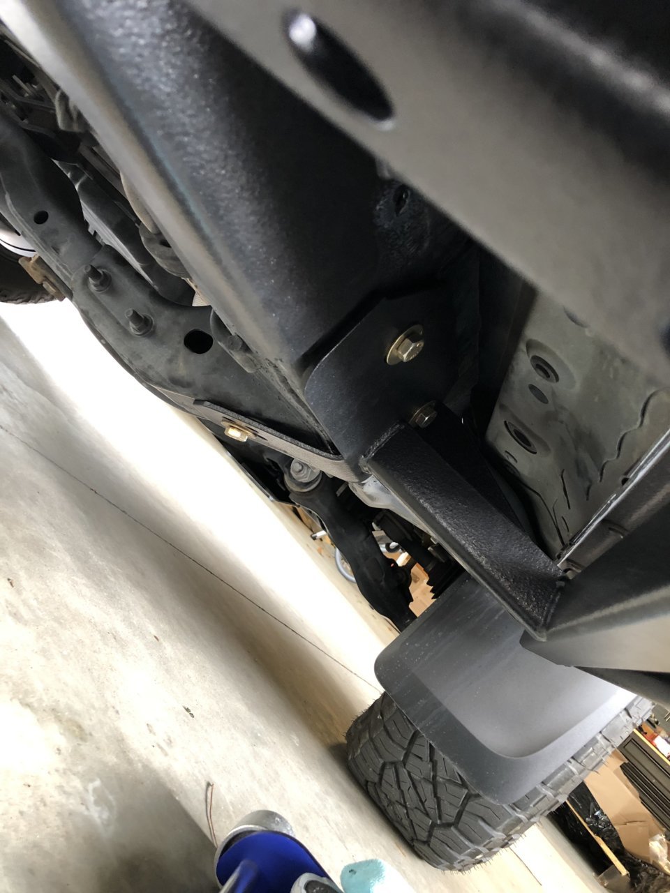

    Thanks ! How did ya bolt em the front wing piece going down the the crossmember?72E4A390-9775-45A5-9900-327C134813ED.jpg
  17. Jan 19, 2022 at 12:20 PM
    #1257
    JonnyQuicksand
    JonnyQuicksand Active Member
    Apr 20, 2020
    #325302
    29
    Tacoma, WA
    2017 TRD Off-Road DCLB
    Stock
    There should’ve been a slab with a welded nut on it that you shove in prior to mounting the sliders up. I missed that step on my first try at home and had to unmount the things.
    FishnTx likes this.
  18. Jan 19, 2022 at 12:41 PM
    #1258
    FishnTx
    Mar 22, 2017
    #214004
    9,171
    South East Texas
    ‘17 OR
    :thumbsup::thumbsup: Re imma dumbass put that towards the rear thanks:thumbsup:

    Got er in !!:thumbsup:
