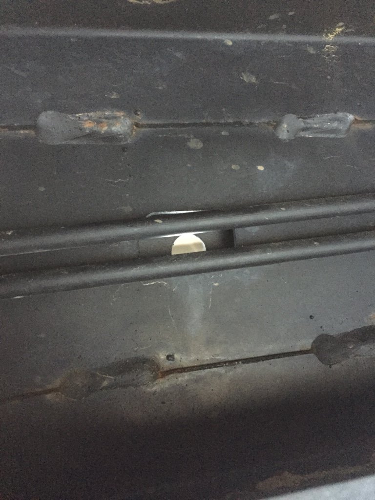

    Ok, definitely going to need help on this. Currently sitting under the truck staring at a bunch of random bolts/nuts. I'm assuming the square steel pieces are spacers, but under which bolts?

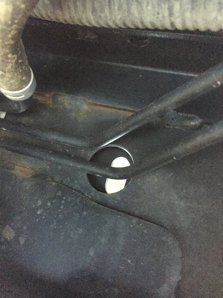

    I also have brake lines through some of the slots that look like bolts and intended for. 0dcd85e0e100482824cf05a1aa5cae3a_84480cfedd7931cbdc31fbe73f759c07011be7d7.jpg5eaab9c3edb0008258a5f236e2213ca2_2530142487590b266c285b1e0555a5b43eb3a160.jpg

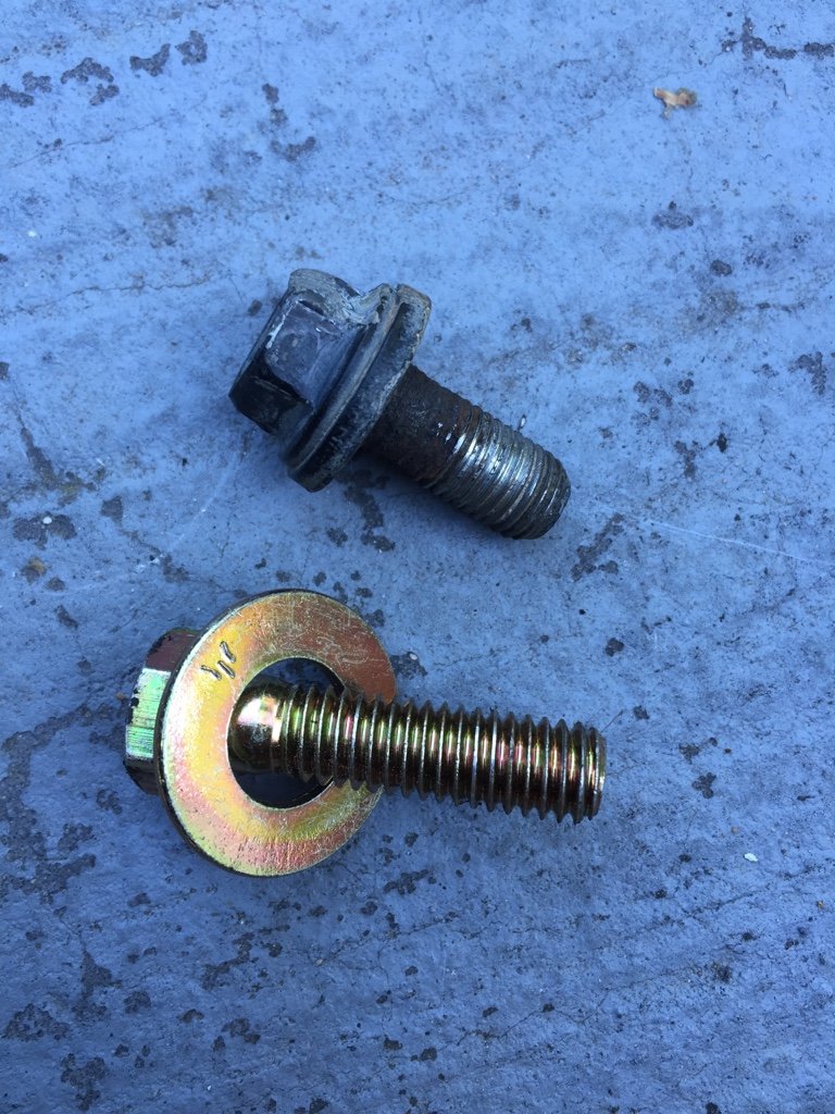

    Also, if this is the bolt that is supposed to replace the cross arm bolt on the down side, threads are different. Is this where is is supposed to go? Because otherwise the stock bolt is now too short to reach. 842c5fff7a5f3ca3df2b71a96037d494_93091afe98290491c94f5dbdb61fa665ee339c0c.jpg

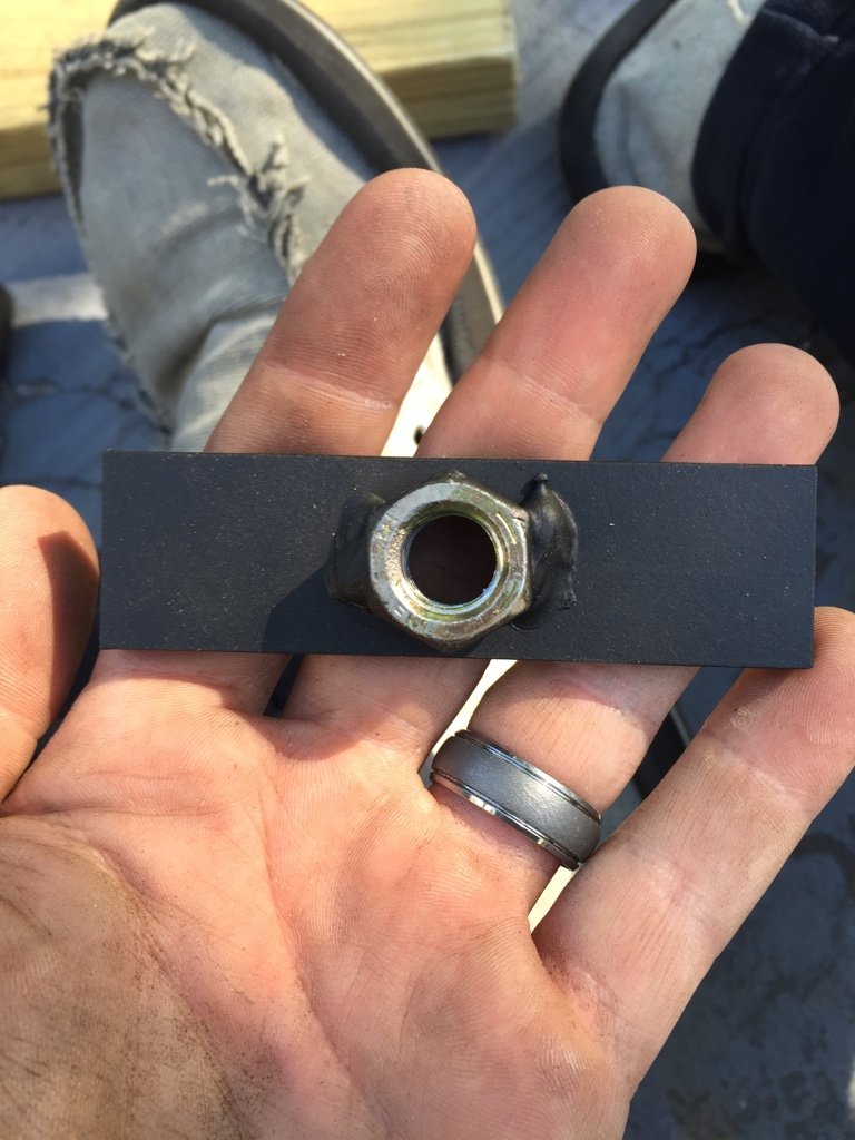

    Ok, I figured out everything above except the brake lines (looks like I'm going to have to move them) and where this piece goes. cffd9669964bb3cc79dbb3096e3a0edd_5a0098e268327a0d8d075a016b94a02fa5e2714a.jpg

    Well got them mostly installed besides the bolts that interfere with the brake lines, and one of the driveshaft cross member bolts. The bend is slightly too short to reach the hole. So I'm trying to think of a way to wallow out the hole. A note for installers: the picture above with the steel bar and but, it needs to be put in place BEFORE you install the slider or you will be completely removing the slider after you finished everything..........499e2361534b2c335280fd44408eecad_ebe16a593ad7679ce62ce1cbc0ab51282b4da28f.jpgab161e7dfd3a83933ee51f9b3c52fac2_d26b4c56469e570bede49f7420d978d9f62cb690.jpg2bc40ea53aec4c5b81f8a1fc8efa8b3b_2ce7f370742195c3605b443e60faa83bcc894e40.jpg

    The brake lines do need to be moved out of the way of the bolts just light pressure you can bend them with your hands.
    Humm that stock bolt should fit it bolted up Every time we bolted them up.

    I ended up getting one of the stock bolts screwed in. On the other side, it is about 3mm overlap over the hole to screw in. So I'm trying to find a way to get it in.
