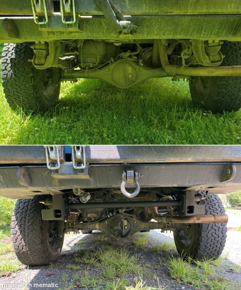

    I just installed the BAMF hangars and crossmember today. Will get a picture for you, as well as an update on how much it improved my truck's handling!

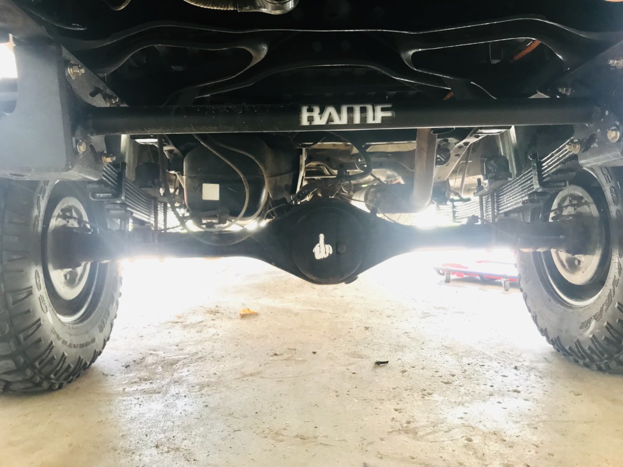

    Just installed the BAMF HD Hangars and shackles, as well as a crossmember. Already notice improved handling in the rear. Can't wait to bash my rear end up on a trail soon!

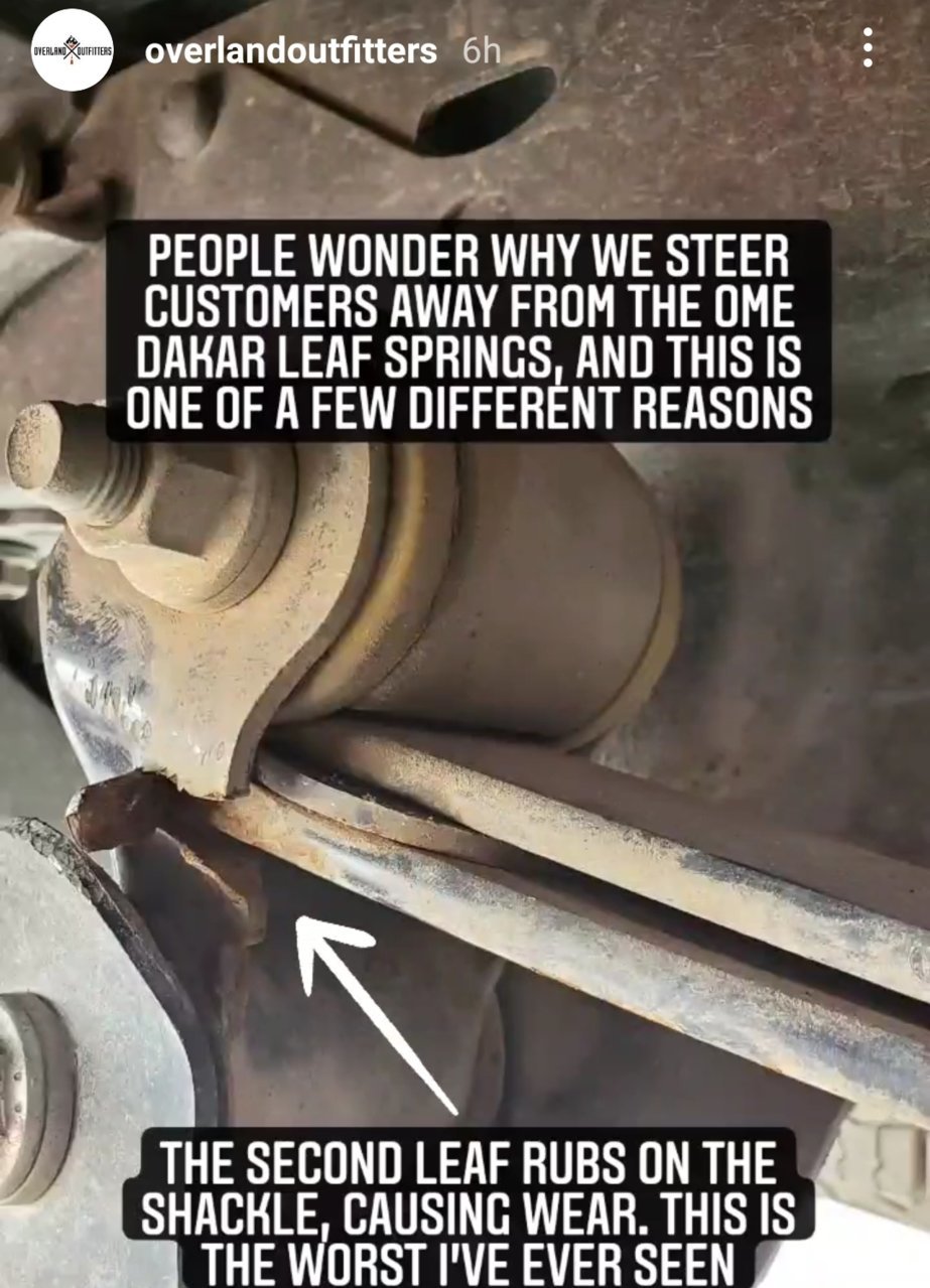

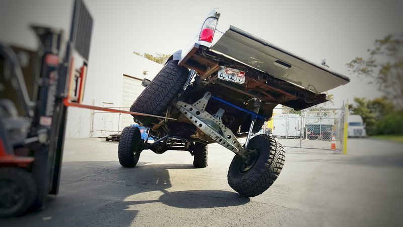

    I want to clarify this issue is 100% fault of the spring brands making springs that are not compatible with the stock Tacoma shackle arrangement/design. Those springs don't "play nice" with the stock hangers/shackles.
    Those springs are clearly designed for the Hilux shackles, plate shackles that go above the rear spring eye. In the Hilux application, there's no shackle to hit with 2nd/3rd leaves.
    The only way to fix the problem created by the spring designers is to fix springs, hence trimming the leaves that extend inside the shackles.
    Picture proof of Dakars destroying a stock shackle in a stock hanger.
    Every revision of Dakars have progressively gotten worse in this issue. I ask people to stop buying this problem, and if you did, hold them accountable.

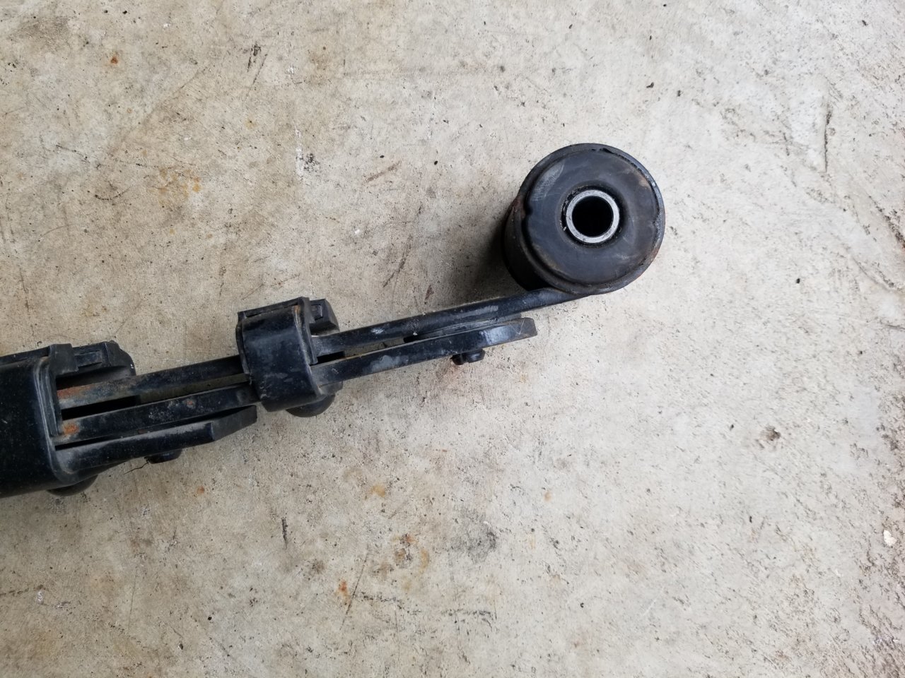

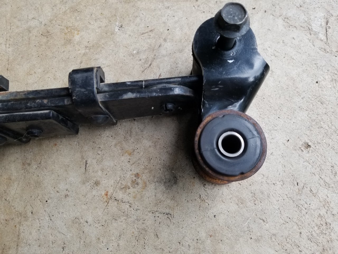

    All they have to do is follow the stock springs design:
    This is also a good guide on how much to trim Dakars, Dobinsons and Ironman, but Alcan will need to be trimmed more because they're much longer
