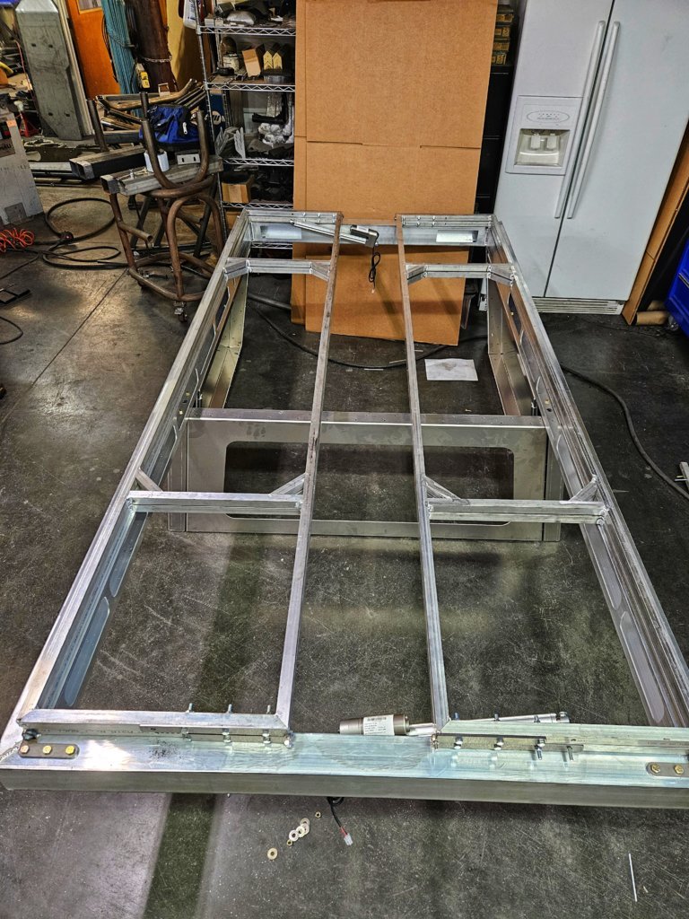

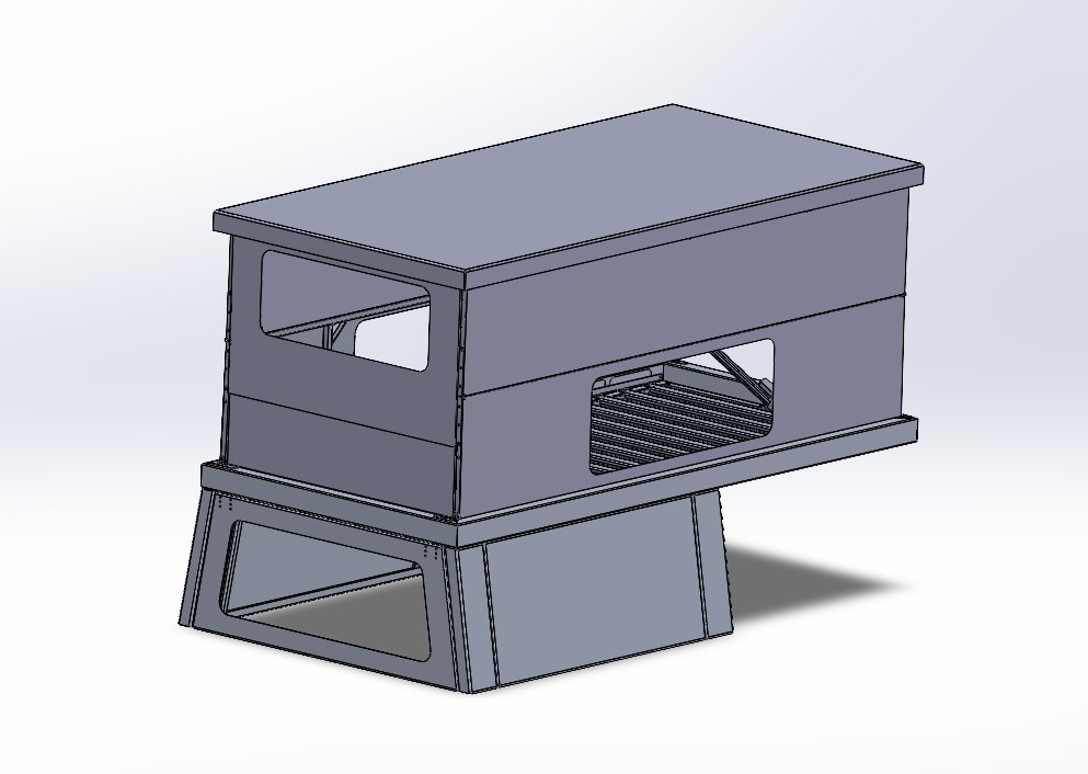

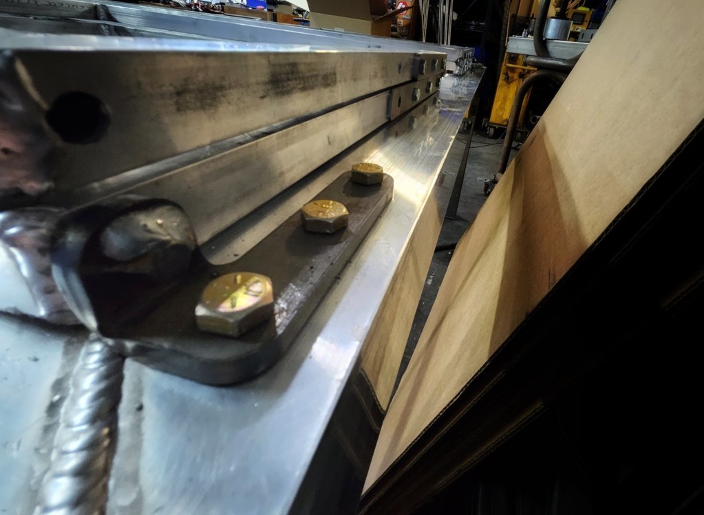

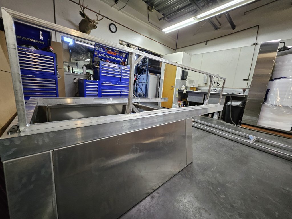

    There is a new camper hitting the market. Many of you know the failed Vagabond Outdoors company. Well I stepped in to help those that they screwed over get a camper and it did not work out with the patent holder of their designs that's all I can say, So I cut all ties with him and developed my own camper. The BAMF rambler is like no other camper out today. Full aluminum hard side tent construction not cheap composite sides, they are fully framed with 1" 6061 tubing skinned with aluminum sheet. Electric linear actuators to lift and lower the tent not struggling with tent fabric everything folds up nice and tight with a flick of the remote.
    I'm the only company that I know of offering a built in auto system for those that like tunes while sleeping. Or just rocking out with your CO*K out we don't judge.
    https://www.bayareametalfab.com/Rambler-mid-size-truck-bed-camper_p_197.html
    Standard Options Include:
    · 1/8" marine grade Aluminum Construction
    · One-piece solid aluminum Lid
    · Linear Actuators Raise the tent walls and roof
    · Waterproof aluminum Hard side tent
    · LED 3rd Brake Light & Wiring
    · Solid tempered Glass Cab Window Or plexi for weight reduction.
    · Rear aluminum door with tempered glass Window w/Keyed Lock and recessed hidden hinges.
    · Lockable Stainless-Steel Latches for the Lid
    · Camper Attachment Clamps & Bulb Seal Gasket
    Made In the USA
    DETAILS
    Body
    · Laser cut & CNC bent 1/8” 5052 Aluminum 7 panel design with 4 reinforced corners, 1 front panel and 2 sides complete the lower frame.
    [​IMG]· Fully welded panels & stainless-steel bolts & nuts for connection points
    · Sealed panel connections with in house made Butyl rubber gaskets laser cut for an exact fit.
    · The tent frame is constructed from Laser cut 3"x4"x.125" wall 6063 aluminum tubing with relief cut outs for optional fans/storage, power
    · Attaches to truck bed with aluminum clamps and bulb seal.
    Roof
    · Single piece 5052 .125" aluminum reinforced with 1"x1" tubes to handle loads on top of the camper.
    · Havelock Wool insulation with durable light weight interior aluminum ceiling panels.
    · Linear Actuators and hinges recess into the camper when closed.
    Tent
    · Full pop hard sided folding panels make up the tent. Waterproof, durable, 1x1 tube framed with 16 gauge aluminum outer skins (With optional insulation)
    · 30 gauge clear Vinyl side and rear windows.
    Sleeping Platform
    · Bed platform can be lifted to fully lift the bed out of the way for full use of living space.
    The suspended Laser cut formed aluminum bed slats create a floating like support under the mattress, breathable as well keeping the under side of the mattress dry.
    · 3" x 48" x 80" 2 layered Memory Foam Mattress made by FOAMMA with Water Resistant Organic Cotton Cover, 1" memory foam top with a 2" Firm High Density Foam Base, USA Made, CertiPUR-US Certified

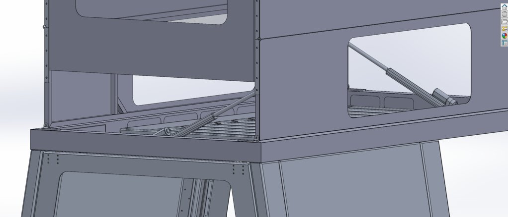

    They fold down from the lid.

    Ah got it. And they fold around the actuators?

    The lower section slides down. So fold and slide.

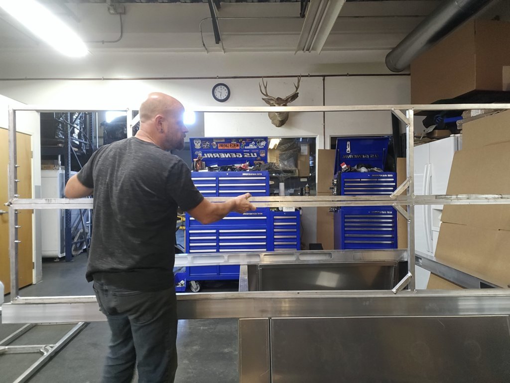

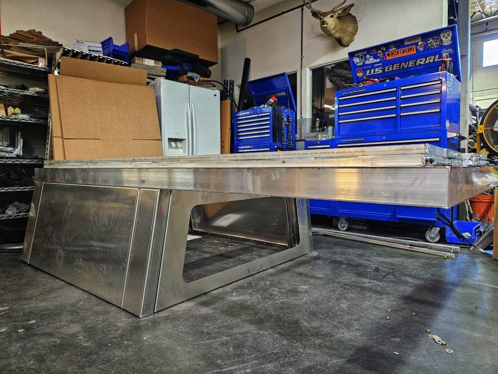

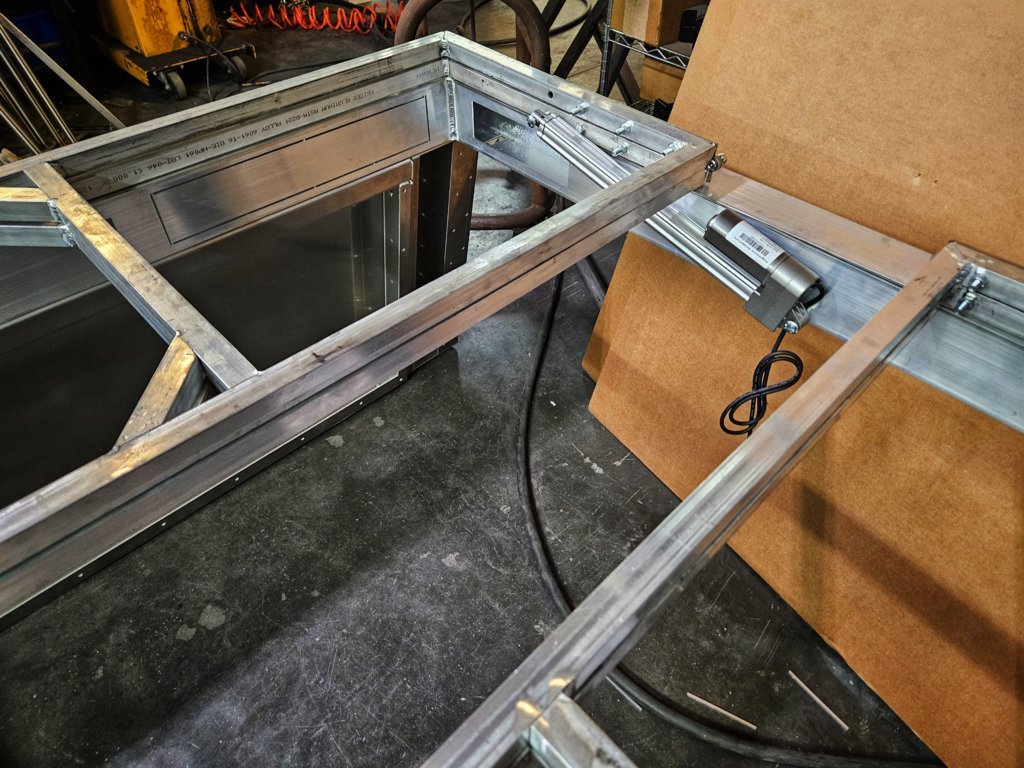

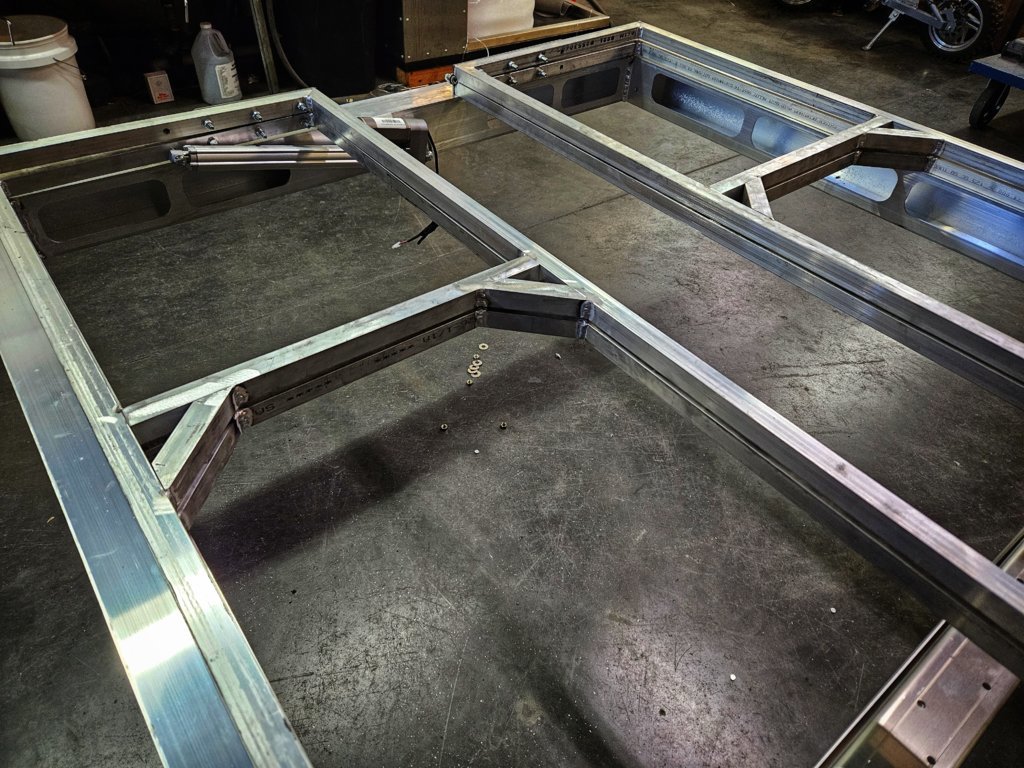

    The hard side walls, the 40" tall walls give so much more room. Sit up fully no wedge in your face when sitting in bed. I should have power to this one this weekend going to do some load testing to see how much weight can be left on the roof for quick road trip stops. No one wants to unload the whole roof rack if your just stopping to catch some shut eye on a long trip. The aucators combined, have about 700lbs of force so it should be good for lifting gear on the roof rack as well.

    This looks like a promising design. Will the side panels open up? Will make loading and retrieving things inside the bed easier. Also creates that open air nature feeling and less of the "camper van/in a tin can" feeling.
