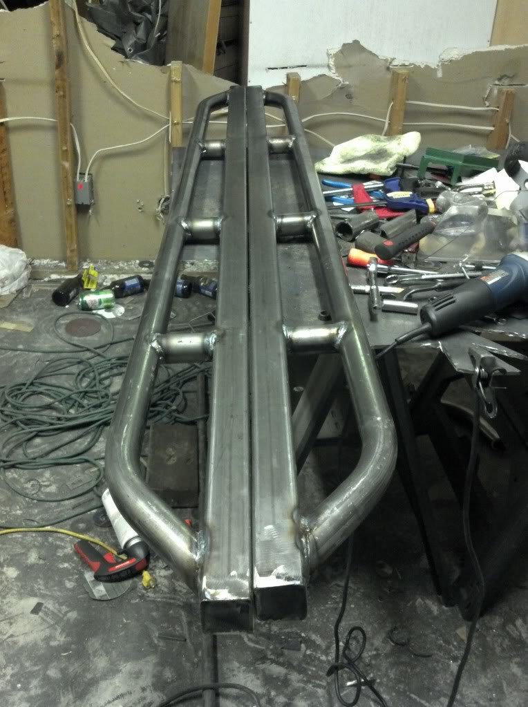

    Here is a set of non kick outs im working on for a member. They get progressively wider towards the back by about 1.5"
    Don't mind my remodeling in the back ground :D

    welds/sliders look great!

    Looks to be an awesome job!

    Looks good!
    I have a general question I've been wanting to ask a fabricator about sliders. With the kick-outs, why the 2-part tubing? How come one piece starts at the front and ties back to the square tube, then a second piece makes the back kick-out, why not one single, continuous piece braced back to the square tubing every 12" or so. Just curious, I'm far from a fabricator, just a wondering mind!

    Looks mainly I didn't like the look of one tube for the kick out sliders so I went this route. Non kick out sliders are one piece.
