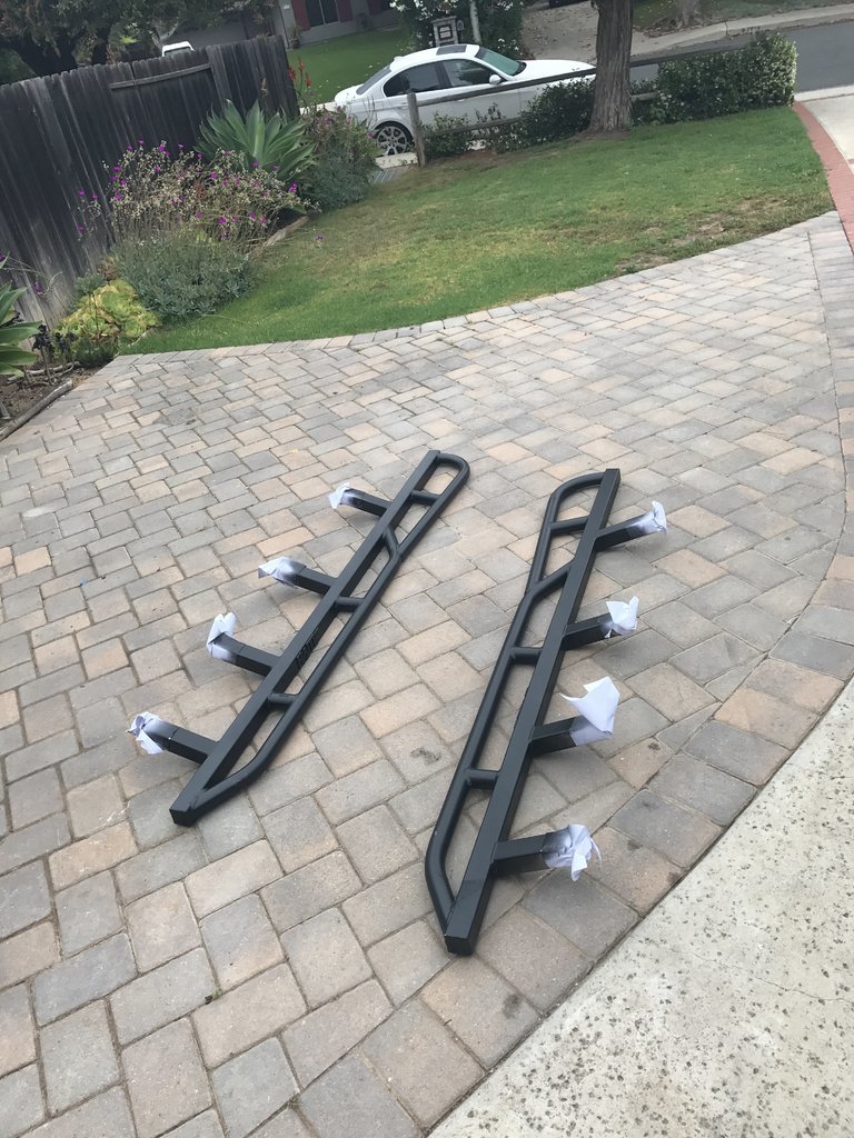

    Installed the sliders today with a buddy. Install went smooth, took about 2-3 hours. Had to cut one plate a lot of clear a river but that was simple. Love the fit and finish!
    How much clearance do I need between the door and tube? How much will it flex ? I have over a fingers worth IMG_4701.jpgIMG_4713.jpgIMG_4714.jpgIMG_4718.jpg

    My sliders are welded about an 1/8" below the pinch weld running front to rear. I've landed on them multiple times, very hard, and have managed to get them to contact the pinch weld ever so slightly. So I'd be willing to say a fingers worth is more than plenty

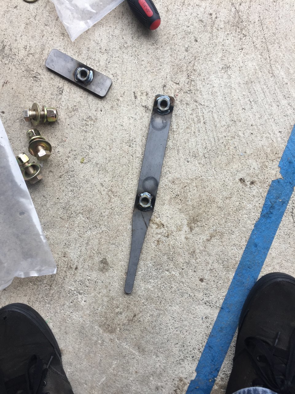

    2nd gen DCLB.. where the hell does this become relevant in the install..? Doing install in the rain because determination.
    Edit: Disregard. Found the secret spot for it. How many bolts per side should I have? I have a lot of holes in the slider mounts, but the frame holes aren’t big enough for the given bolt.

    Every hole is not used most of them are for brake line clips on the driver side. These are made for over 10 years of frames that toyota changes ever so slightly every few years. Just bolt up the holes that fit the frame.

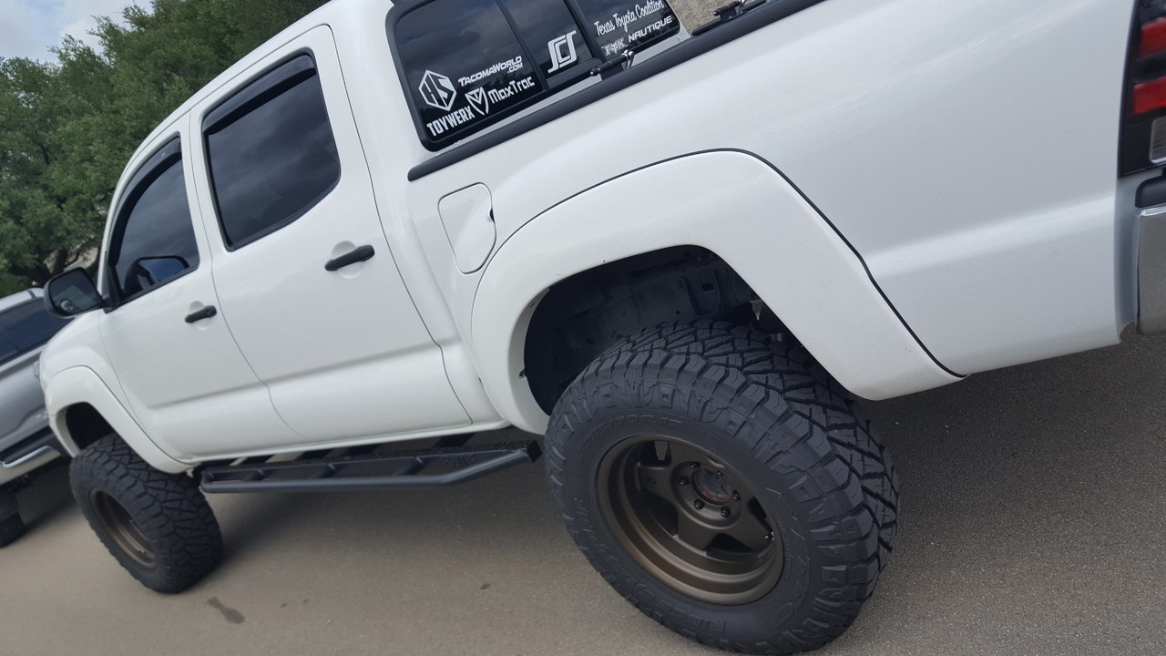

    AF060AFF-E366-4FAC-AD01-77495690B749.jpg I guess the DCLB for a 2013 Tacoma only has an option for the kicker Out sliders? I didn’t see ones that didn’t kick or low profile. I saw this picture and wanted it for a DCLB.
    ChadsPride likes this.

    The no kick on the DCLB was removed from the options. Building one or two sets a year is not cost effective. We will build them but there is a 10% upcharge to do so.
