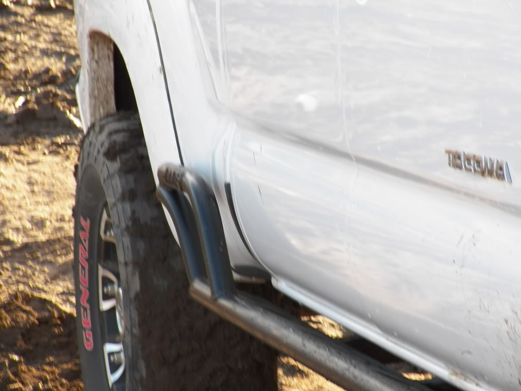

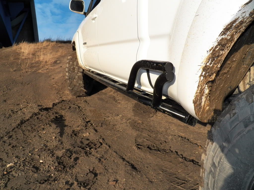

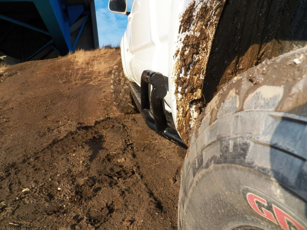

    we mounted and installed some sliders today :p, i posted a shitty cellphone picture, but tomorrow or monday ill take one with a real camera and upload them for you
    any specific requests like maybe upside down??? :p

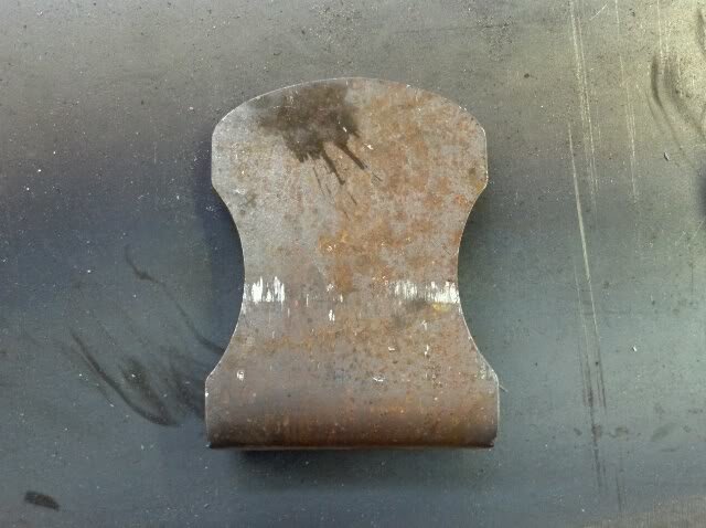

    Well i don't have straight lines on my frame plates well the bottom does here is me frame plates. I put a small fish mouth on each side and a radius at the top to relieve any stress the sliders or the welding would add.

    That may be for the welds but then you have all the forces of the sliders pushing on one point at the top and I feel that is worse for the frame. I feel my frame plate design is going to have the least amount stress on the frame then any in the market today.

    Nice, I like that design. Great work Jerry.
    That's just what I heard. I 100% trust you and your fab skills. I like your idea a lot more because their is no single point where stress can be focused.
