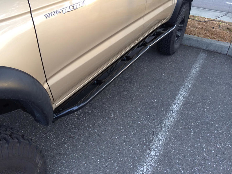

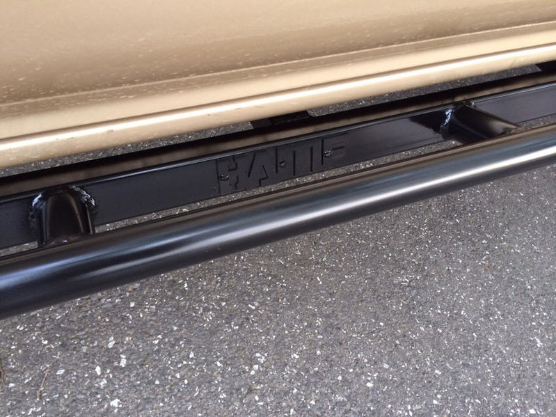

    Big thanks for taking the time to install my sliders this week! It was super busy, I hope you were able to get everything done in time.
    Btw for anyone thinking about sliders, please do yourself a favor and have them powder coated by jerry... For one it is kind of a pain in the arse to do on the truck, and the powder coating feels/looks/ismoredurable. For the record, it was MYchoice to do it, against Jerry's suggestion. Noted.
    I'll attach a pic of the outcome :)ImageUploadedByTapatalk1396637397.466512.jpg
