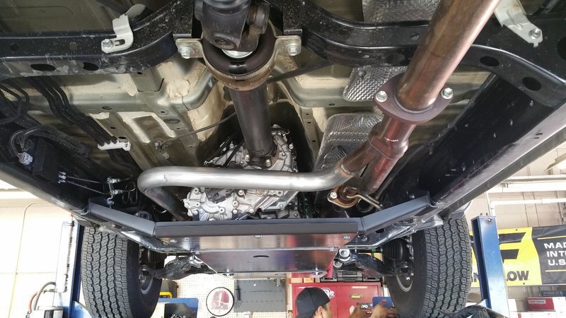

    Anyone running the full set? I want to see photos of how the exhaust was rerouted. Waiting on the front and mid plates to be finished... Held off on the third till I figure out the best way to route the exhaust.

    Just like that is how it should be routed.

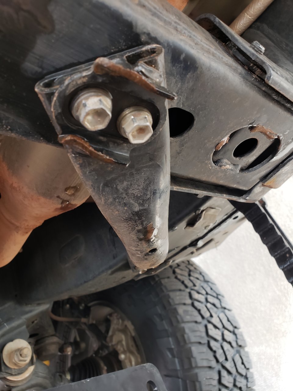

    @JLee Do these frame supports have to be removed to install the bamf mid skid?
  7. Jan 20, 2019 at 12:09 PM
    navytacoma
    navytacoma LCoverland.com
    Dec 6, 2017
    #237799
    152
    Jacob
    Phoenix AZ
    2023 TRD Sequoia
    Yes
