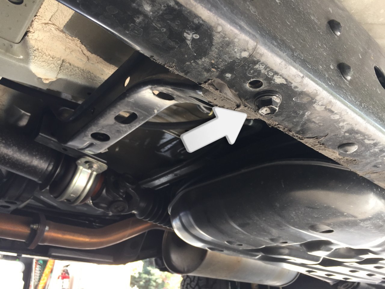

    photo.jpg I was about to install the BAMF slider this afternoon. However I realize that it require to remove this bolt on the cross member before the installation. I honestly don't feel comfortable to remove it, and I think I saw some folks are having hard time to put that back. Does anyone of you have issue after remove the bolt? Or you have a way to avoid the frame to move side way?

    Breaker bar, socket , easy peasy.
    Back together even easier.
    My frame is under coated so it was probably worse than what you're about to do.

    You'll be fine. The alignment never moved and had no problem putting a bolt through there. Actually, it is the first bolt that you will put back when putting the slider on.

    Just do it! Worst comes to worse you can just grab a ratchet strap and react on the other side of the frame to pull it back.

    Just pull it, no worries. Ive never had an issue with it in installing any of our sets of sliders which is a few dozen installs

    Like mateo said ratchet strap if needed.

    Like other have said, use the ratcheting strap...I had to use one on my 2017.
