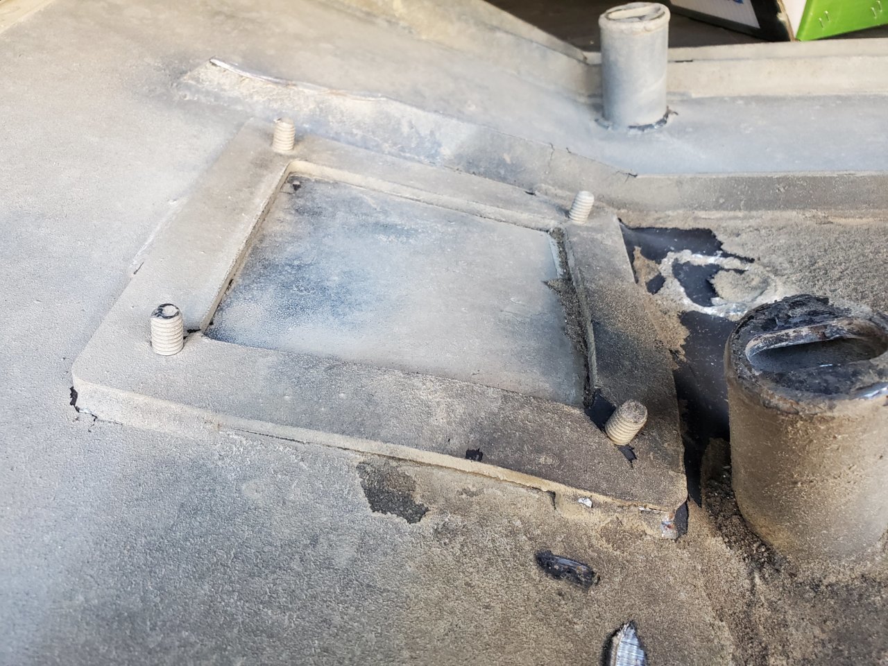

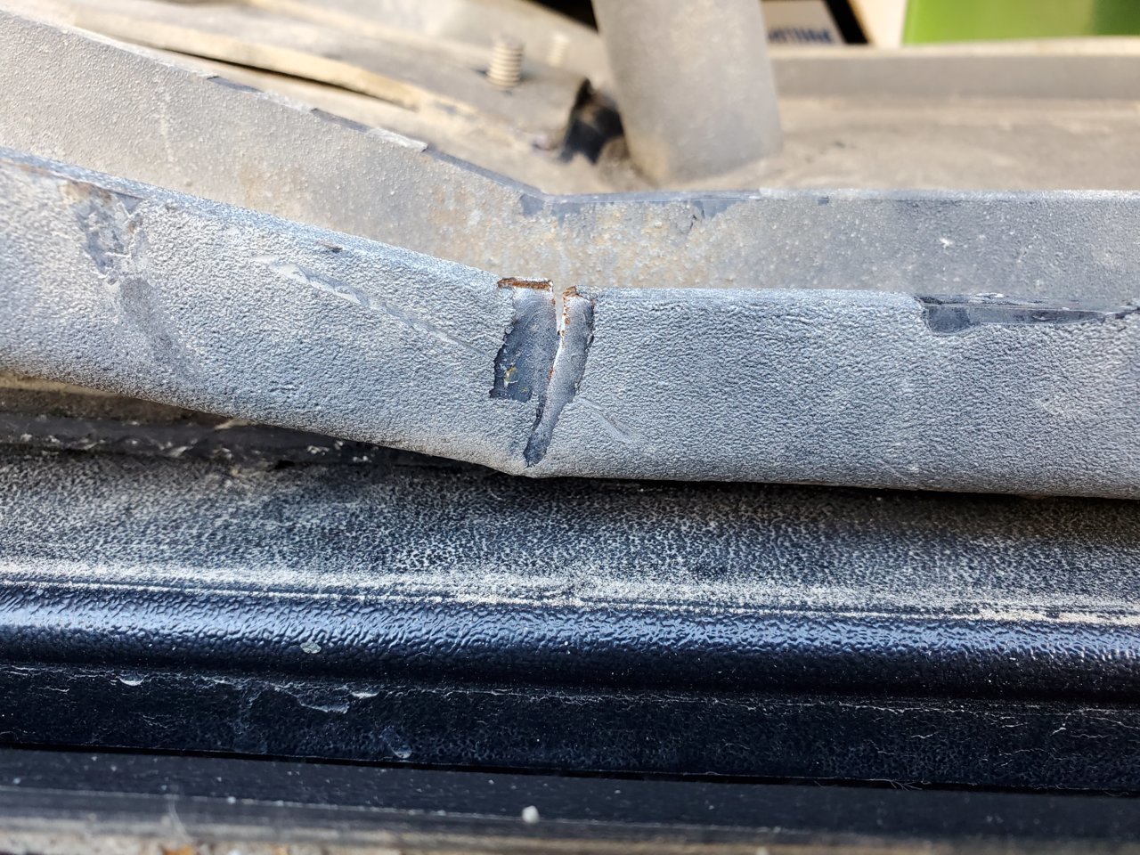

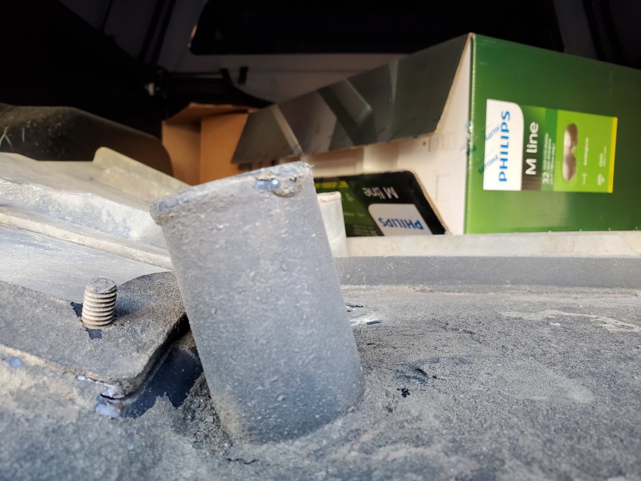

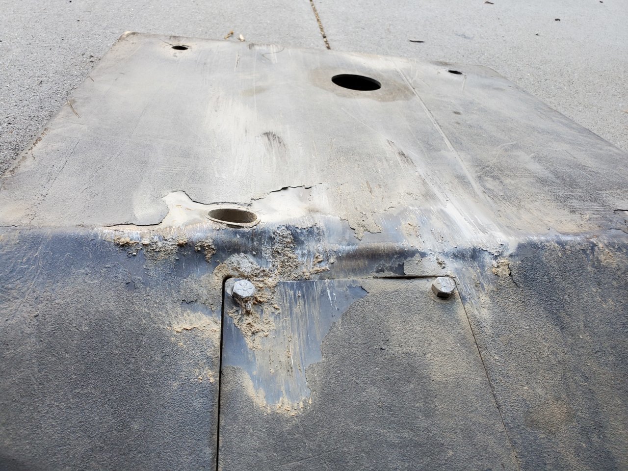

    I thought this was relevant to the discussion since you brought up the oil filter door. Mobtown 3/16" steel with the standard reinforcements. Guy hit a rock at 20ish mph right on the weakest point. Royally fucked the skid up, but protected the engine. Mobtown then sent him a new skid at their production cost as a "warranty" and also a "holy shit you hit a rock at 20 mph"

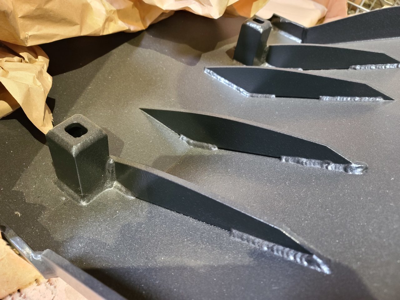

    Alright! Now let's do it again with an RCI. Anyone want to take one for the team?
    These pictures show a bit of the points I was making.

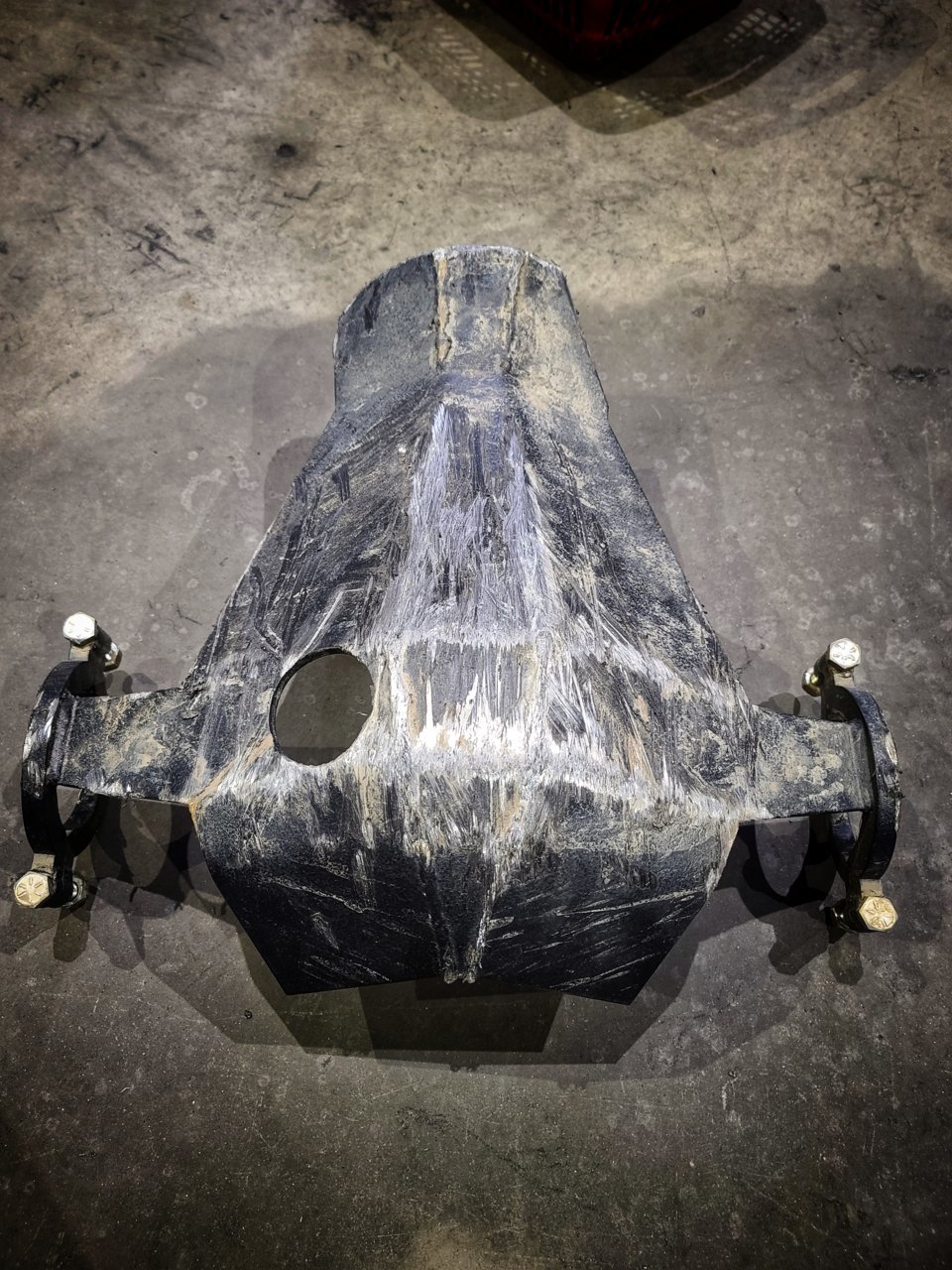

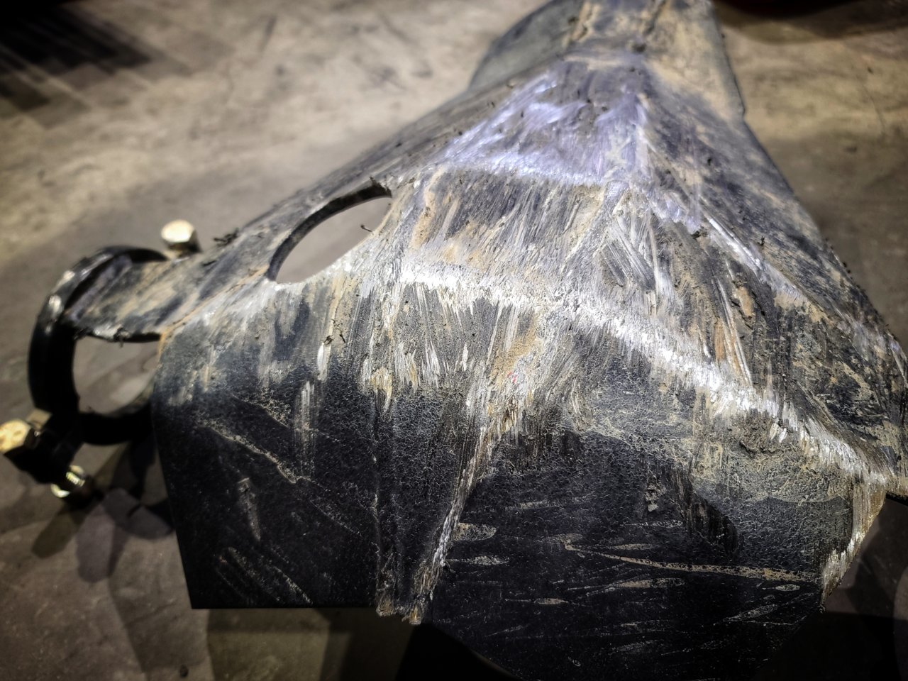

    This was one of our Diff skids after one Rubicon trip. This is why we build them the way we do. Granted this is a extreame case of honey badgering the skinny pedal but he did what he had to do to get through the trail.
    3rd gen on 33's drags a lot of ass!
