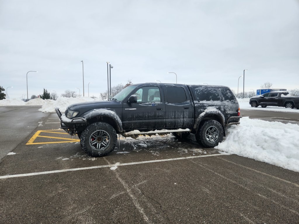

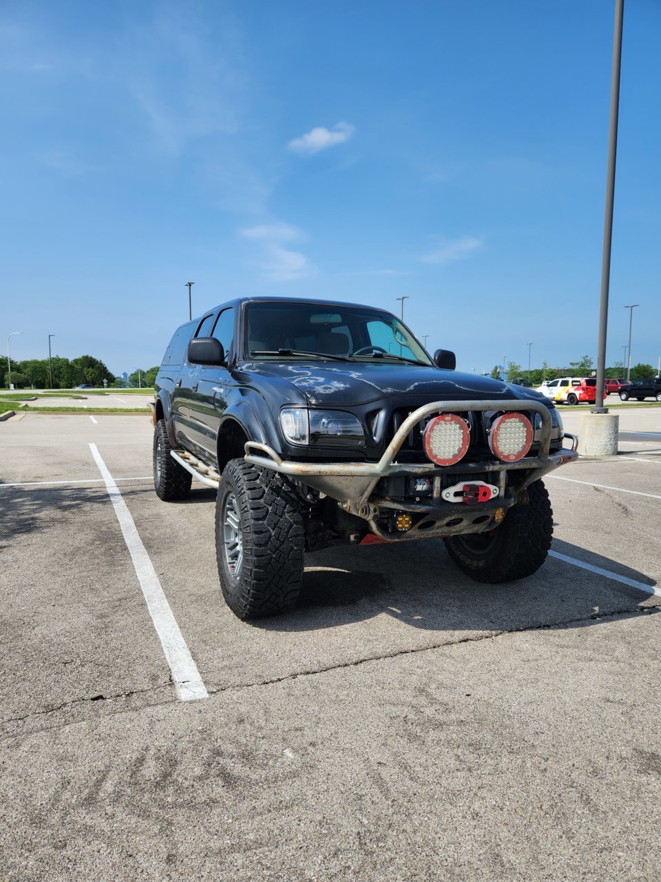

    How she sits 1/9/2025
    How she sits 7/7/2023
    How she sits as of 2/26/2022
    How she sits as of 9/27/2019:

    So as can be seen in a few of the earlier pics in my thread, the headlight lenses that I had were very foggy, I had polished them up once, but that only lasted for 2 months or so... but beyond the lack of lens clarity, even with nice sylvania bulbs, its extremely annoying to see your own shadow on the road ahead of you when someone in a late model vehicle is behind you. So I purchased some CAPA certified headlight housings, a 35w HID projector kit with 5000k temperature bulbs, and the appropriate wiring components off Amazon for about $170 all told. I painted the chrome parts of the reflector housing matte cement gray, and decided against putting a backing plate on the shroud, so some light still escapes into the former halogen reflector bowl. I also ran a wire from the parking lights to the 3rd pin on the blinker bulb, the effect looks nice, but I think I'm gonna get a switchback LED to have more light output during "fog light" operation. The headlights are WAAAAY brighter in lowbeam than the sylvania bulbs, and have less glare when driving by my truck in my girlfriends car, the highbeams are brighter, but the difference isn't as substantial as it is with the lowbeams.
    Finished product with the stock 4157 amber bulb (below low beam cutoff):
    A picture of the housing with the flash, maybe I'll remember to take a picture when the sun is out, or a picture of the light output!
    Light "leakage" around the shroud that was included with the HID kit:
