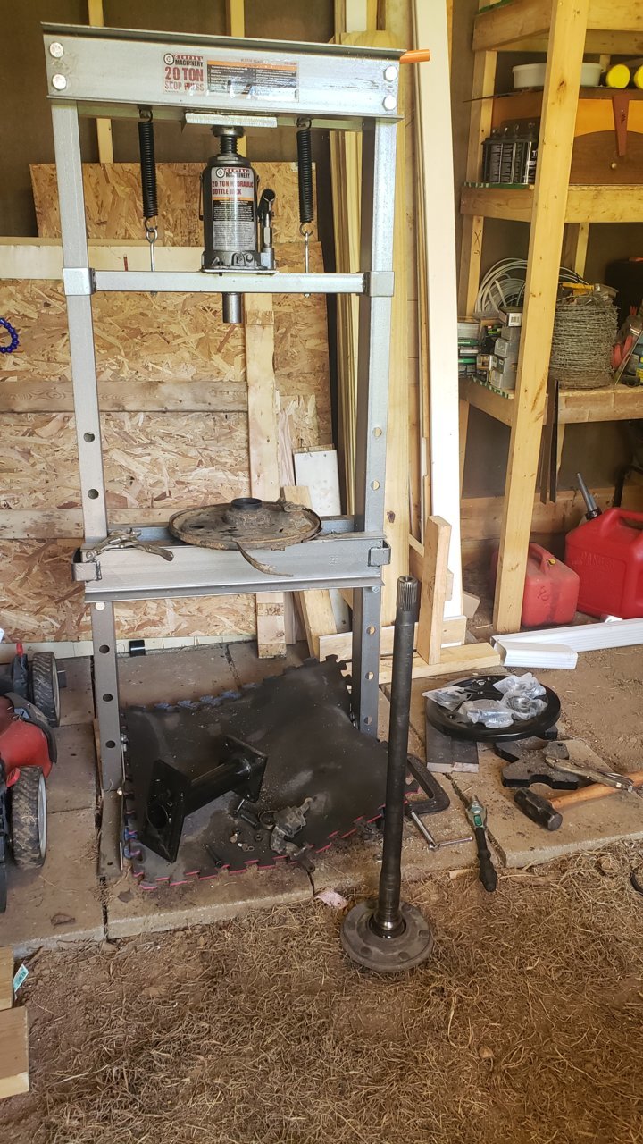

    2003 Tacoma DC
    Finally had some time to work on diffs today. As I was tearing down the rear to space the pinion to improve the engagement pattern, I realized I have a 27 spline 4.88 pinion, I'd prefer to run the 29 spline like OEM, so back it goes. I didn't even think to confirm that I had what I ordered, at least a 2 week delay to getting the truck back on the road.

    New gears showed up middle of last week. Had time sinday for a few fit ups, dropped .0025" from my solid pinion stack, which feels like a lot, but the pinion is now a little tighter.
    One curious thing to me is that this pinion shim stack is .2200" like holy shit. Stock was .0745" on my mics and the 27 spline gearset took a modest .1050"
    I dont think theres any problem, but this feels like a lot of shim. On the flip side, the install kit has about .380" in shims... so maybe this is more normal than I realize?

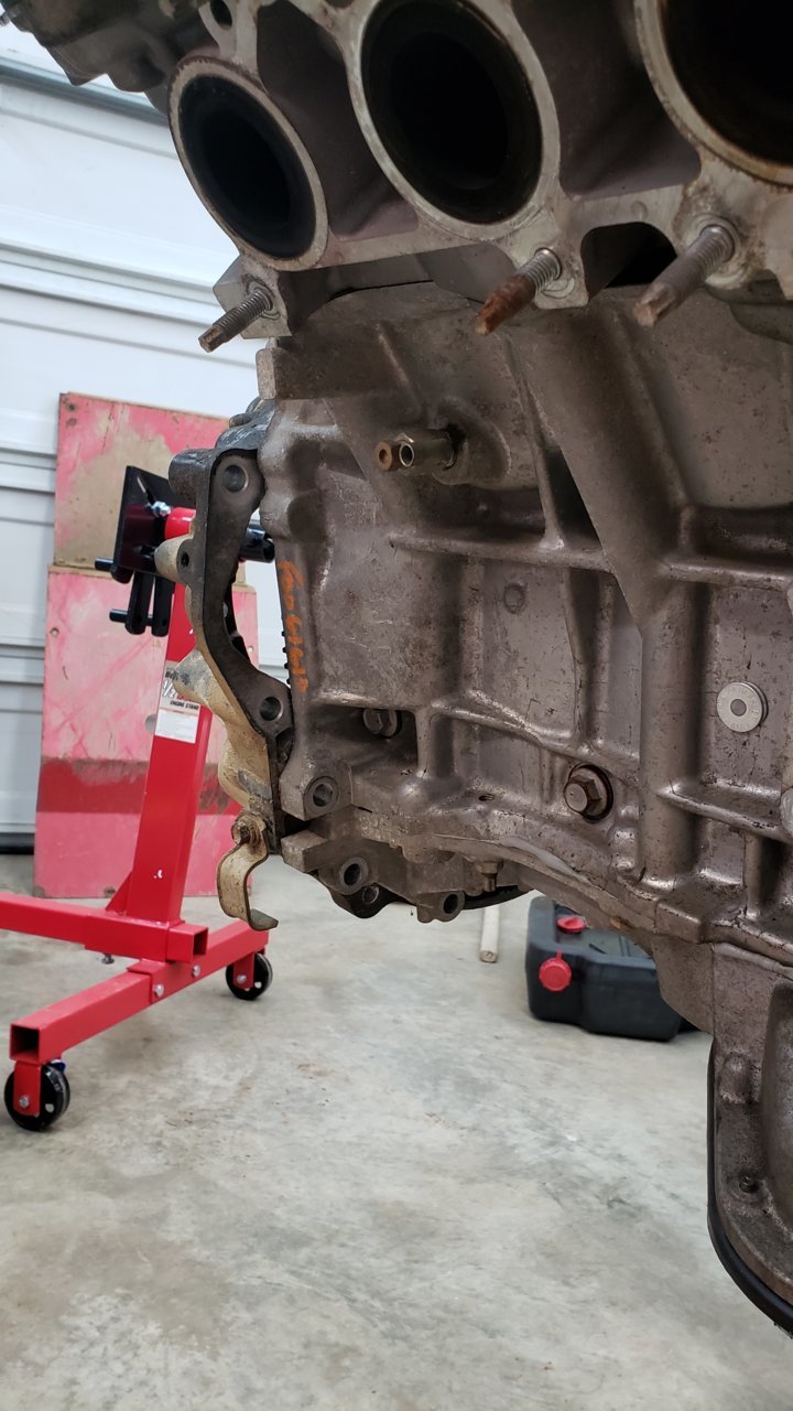

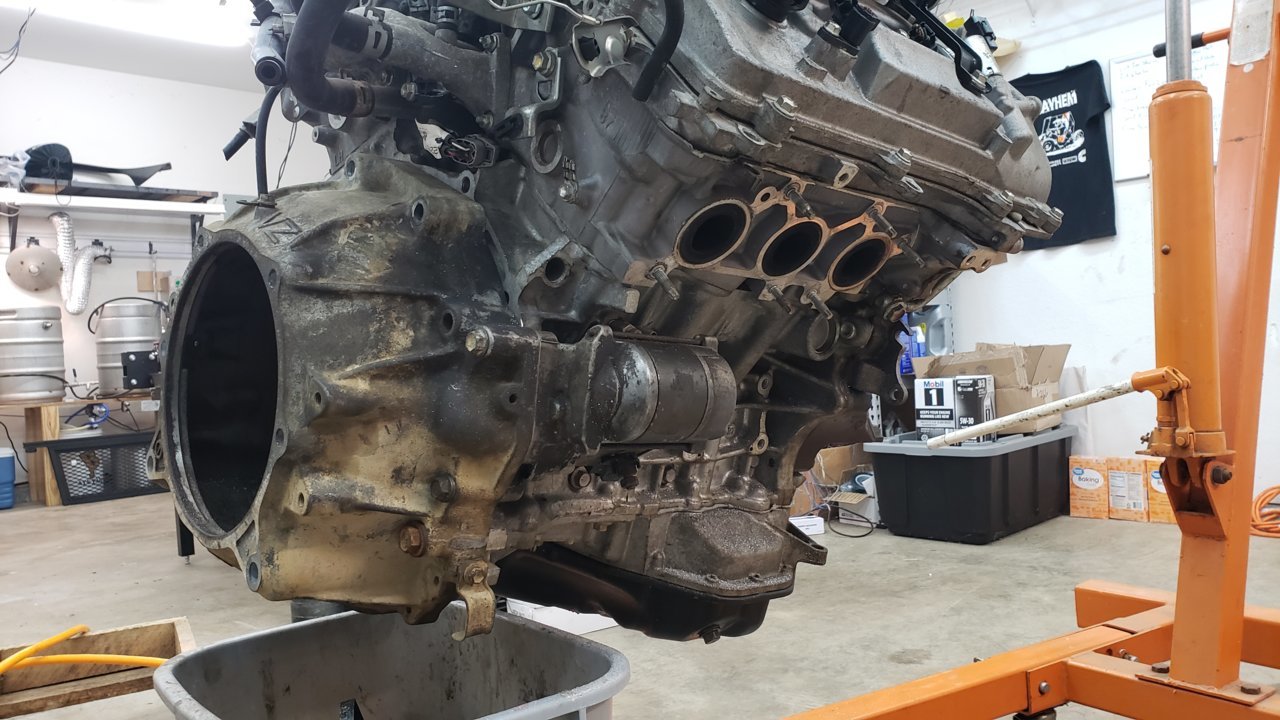

    Lexington, KY
    2003 Tacoma DC

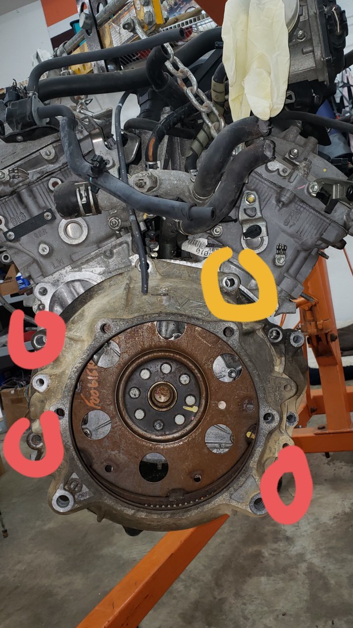

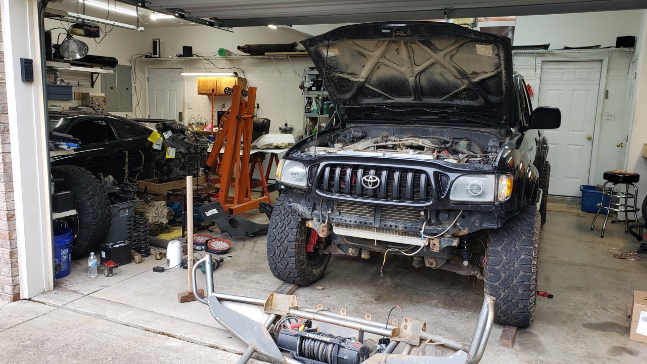

    So I got both my diffs in this weekend, they feel OK. The coast in 4wd doesn't feel great, like there's some very small vibration or noise but tbh I can't remember if it ever felt great. The LPV delete was a success, but the pedal is really soft after bleeding, so not sure if I got all the air out, seems like the front calipers may be stuck or something, and the rear shoes aren't fully adjusted yet.
    I also finally started some motor fitting stuff.
    The 2GR dowl pins line right up with where they are on a 5VZ, so this means the alignment of a R series or A304F is easy. I'm test fitting with my old A304F bell housing, 4 bolt holes line right up, but one of them needs to be tapped on the block, hole is present tho.
    There's also room to make 2 more of the transmission holes into mounting points, but I don't have the right sized drillbit to get into that right now...
    Now the difference between the transverse block and a longitudinal block... Starter location.
    After about an hour and a half with a die grinder and Dremel:
    And I threw the the old 5VZflex plate on there and hit 12V to the starter...we have compression!!
    This afternoon I'll draw up exhaust flanges and engine side motor mount flanges to get cut out on a water jet or plasma table soon.

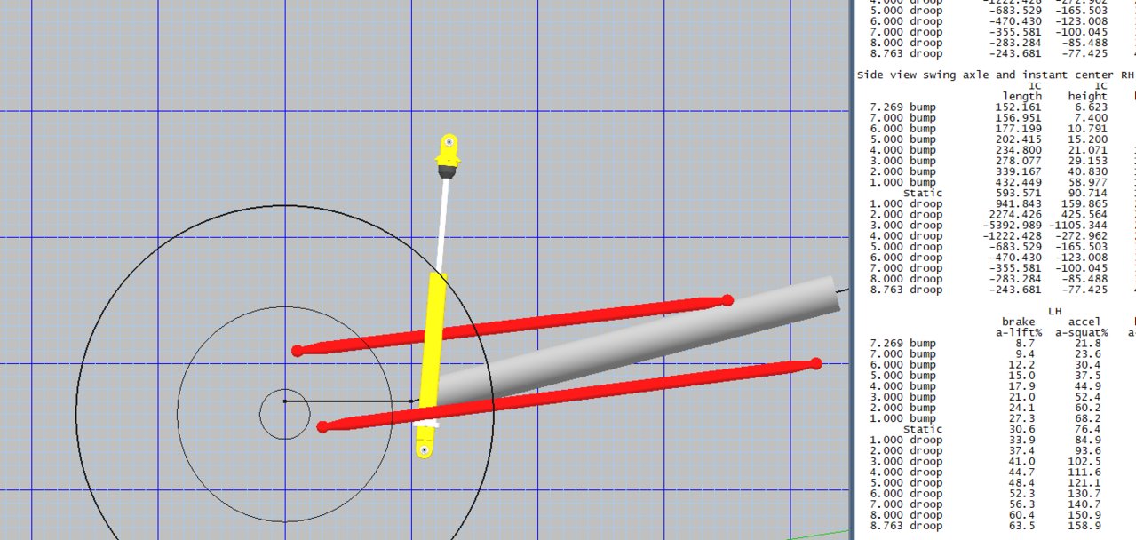

    Checking kinematics and digitally confirming travel estimates, as well as shock point placements for a quick minute this morning.
    I'm a bit surprised by how difficult the anti-squat% is to get right, and just how sensitive it is to the Axle side lower link mount, I'll need to pay extra attention to fabbing those up.
    Also, I'm sort of surprised that the main limitation for front travel on the 1st gen Taco is definitely the tie rod inner, I don't have a good solution for that right now.
    Both UCA and LCA ball joints/uniballs, as well the tie rod outer can easily be optimized to split misalignment thru travel, but the inner really can't.
    As it is, assuming that I get some solution for the Tie rod inner the front geometry should easily cycle ~12"
    There won't be room for more compression without going to glass fenders/opening up the apron area to allow the tire to stuff up there more, and at least with a 33 theres really only another inch or so of compression to achieve before the chassis is also kissing the dirt with a pretty moderate amount of tire squish.
    There isn't room to get much more droop without simply going wider, the CV angles and particularly the Tie rod inner angle get very severe very fast.
    This exercise has definitely made me question front travel numbers and lift amount for a first gen, even with some +2 amount, the trucks aren't able to pull very large droop numbers when lifted... I Probably need to work on this a little harder and consider doing more than one iteration of a front end kit, one to be perfectly compatible with the new axles, and one to maximize the usage of the new shocks.
