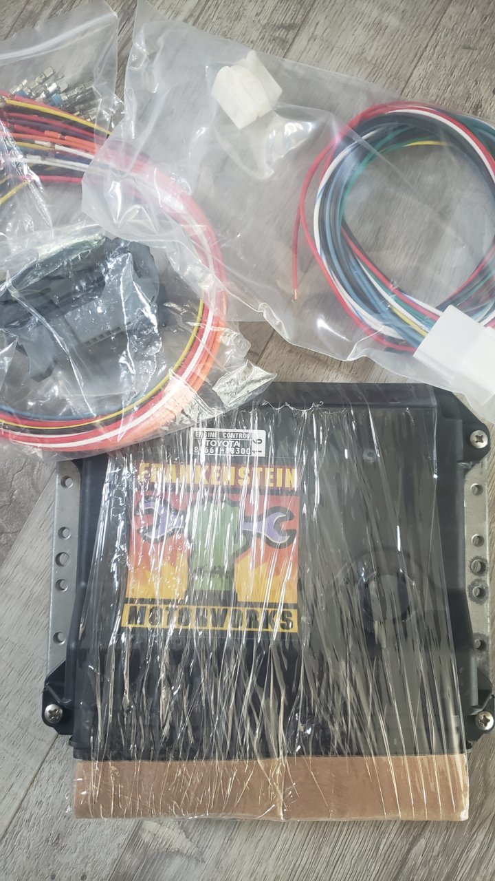

    ECU and wiring kit showed up today. Frankenstein Motor works for the win!!
    This ECU has auto trans codes removed, as well as EVAP small leak, and secondary O2 loop codes. The timing table has also been optimized for power, rev limit has been raised to match the lotus tune for this motor (7200rpm)... Not that I will be spending a lot of time up in those revs, but when/if I do, the truck should sound AWESOME!!
    The wiring kit has the body harness side plug for the new ecu (22 wires) as well as a patch harness connector to connect all of the body side signals/power(15 wires)to make this engine live and breath, as well as be super simple to put in another 2GR into the truck in the future if I ever need to.

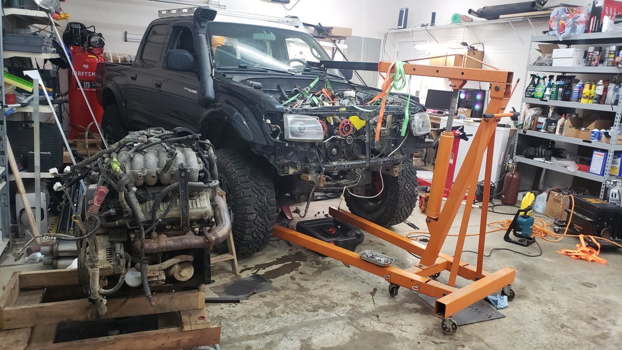

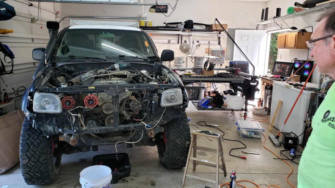

    OK finally taking some PTO this weekend to make progress.
    The things I'm worried about are:
    1. intake manifold; it needs to be modified to fit/route correctly
    2. headers; these also need to be modified to fit; also to route past the steering column correctly
    3. Lower oil pan x diff clearance, the lower oil pan definitely needs a slight modification, and it looks like the motor will sit about 3/4 of an inch higher in the engine bay than the 5vze I took out.
    Other things I don't have figured out:
    - Water Plumbing, but this seems easy, most of the outlets are in about the right spot; the heater core hoses are close, but also maybe too close to the fire wall.
    -AC lines, also seems easy, but I haven't found a local shop that has confirmed that they can swage new lines/fittings (AC is on the opposite side of the block now)
    -Power steering lines, this may be the easiest one as the power steering is in almost the same position and the pump uses suspiciously similar looking fittings.
    So parts I've got are:
    '13 Sienna 2GR-FE, non oil cooled $500 picked up
    '13 Sienna 2GR-FE wiring harness $250 shipped
    '09 RX350 Oil cooled Upper pan $130 shipped
    '15 Sienna High output Alternator $80 picked up
    '08 Tacoma 1GR Power steering pump $50 picked up
    '03 Tacoma 5VZ cold weather starter $50 shipped
    '17 Sienna ECU modified by Frankenstein Motorwerks $470 shipped
    Noonish
    7ish: 2gr is mated to the trans here, lower oil pan removed.
    Tomorrows goals:
    Fab motor mounts, route plumbing, modify lower oil pan, remove keep wires from 5vz harness.

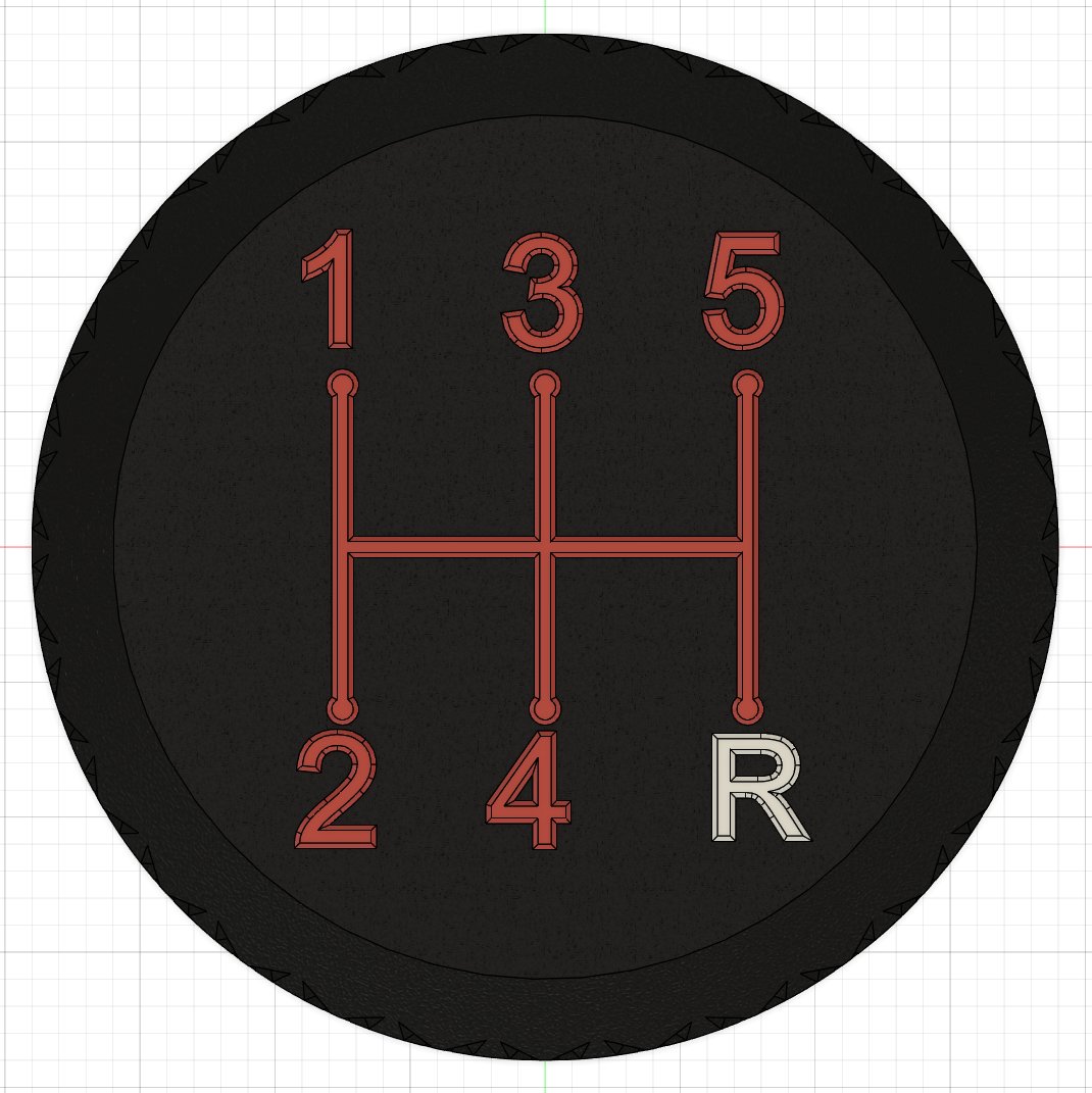

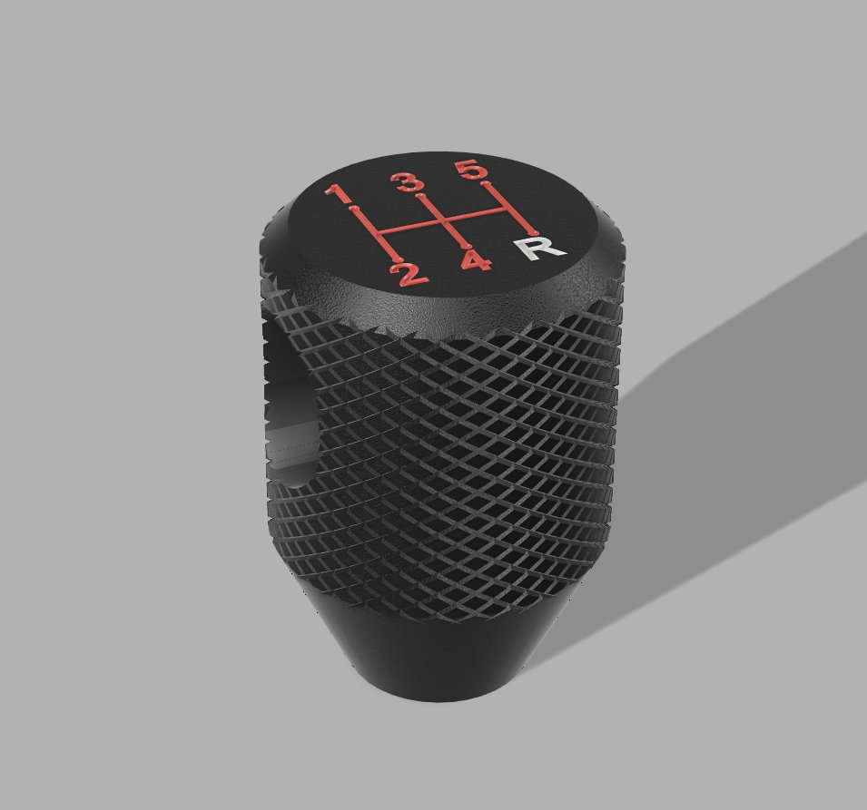

    Truck progress has been a little slow, waiting on a helicoil kit that matched the Block x Trans connection before I can do a "final" install of the block; Motor Mounts are done however.
    Another thing that I didn't catch ahead of time. Part of the Valve cover is MUCH too close to the T100 Brake booster, not sure if a factory brake booster would fit better, but I plan to cut a little bit of the valve cover off to make sure there is 1/2in of clearance.
    lost a few nights of sleep over some of the motor swap things being more difficult than expected, so I designed a shift knob that can be 3D Printed and accept the 1st gen ADD 4wd button. It also can accept around 8oz of tungsten Pinewood derby weights, so it should feel pretty good vs a stock knob or a basic 3d printed knob.
    Printing my.....3rd one now (still getting the button retention geometry just right) but if I can get eh quality dialed in, I'd consider selling a 5spd knob + Low range knob of the same style, reusing the factory 4wd button and BYOT (Bring Your Own Tungsten)
    Now that I look at this however, I think I should move the R to the right a little more as pictured... loltop view.jpg
    *edit and fixed; now another 6 hours to print again lol

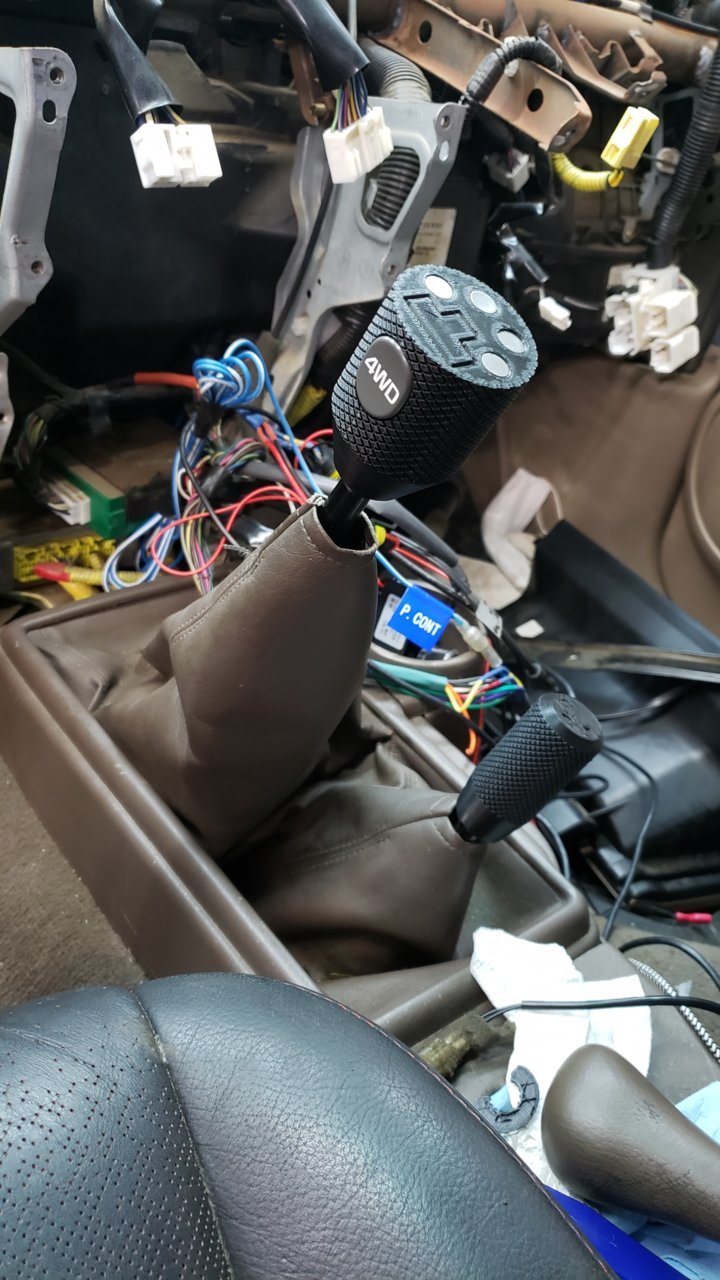

    Still waiting on some things to make big progress on the motor... Sadly.
    Printed shift knob looks and feels good.
    The seam between the upper and lower halfs still seems to stand out no matter what I do!

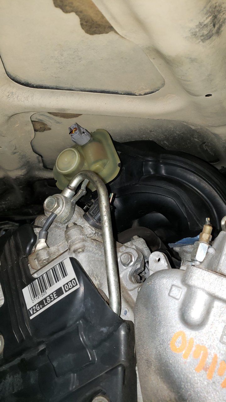

    And even tho I checked, and re-checked, the intake manifolds is 1/2" too tall, and I can't close the hood....
    As expected, the driver side header is a right bitch, it's gonna take a solid 40 hours to get that bitch made. I am modeling it tho, so making another should be ez.
    That flange sits up about 1/2" higher than the rest of the manifold... I might make all the clearance I need if I get a little tricky.
