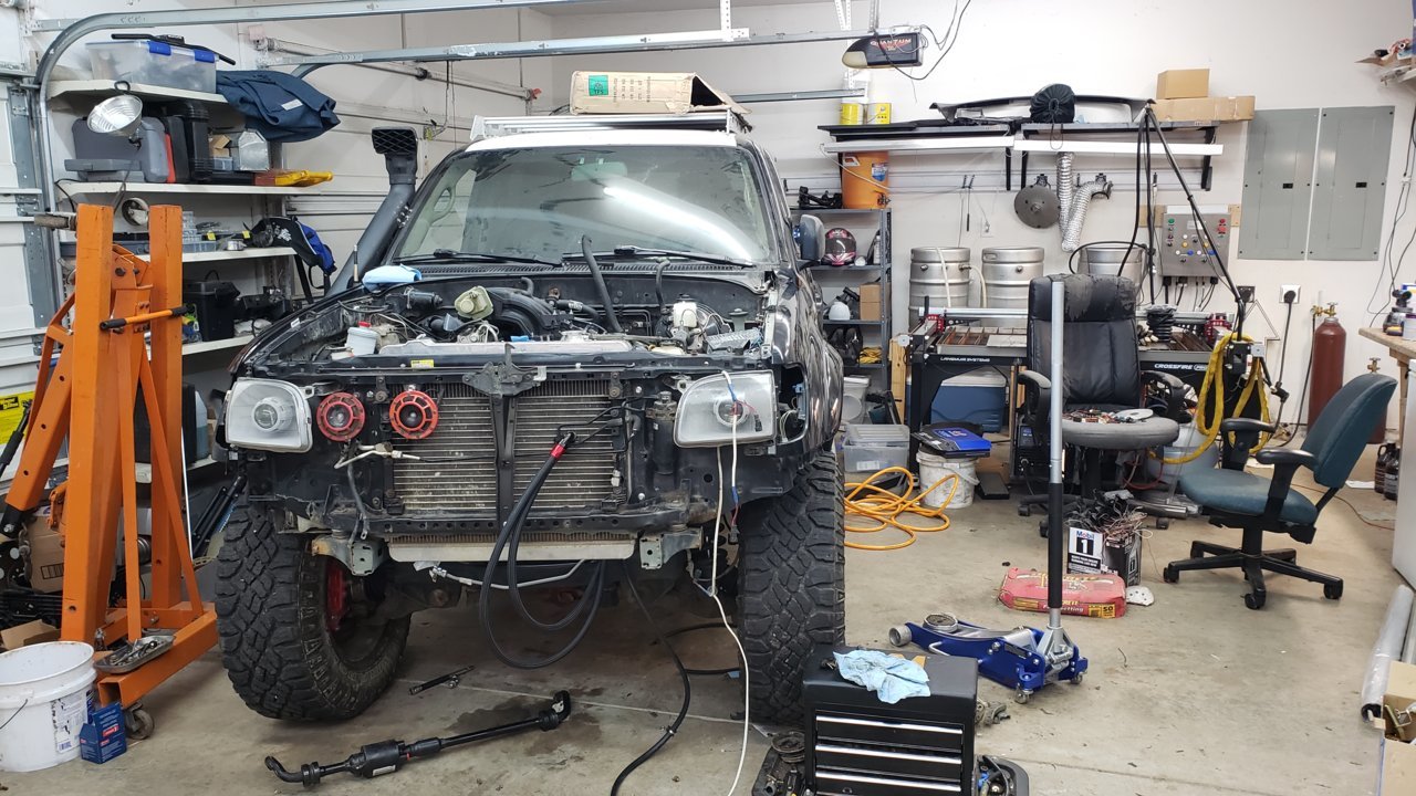

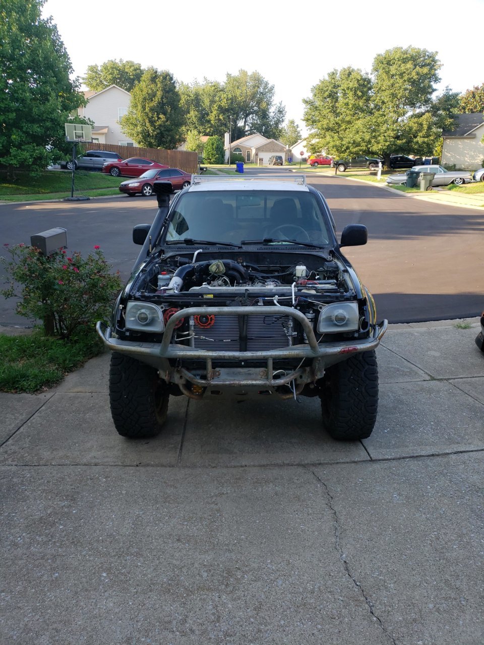

    Ok so the motor swap is in progress, 70% done with headers, still trying to sneak the LH side thru the gap between the steering col and the slave cylinder. Don't have plumbing routed yet, nor fuel hooked up.

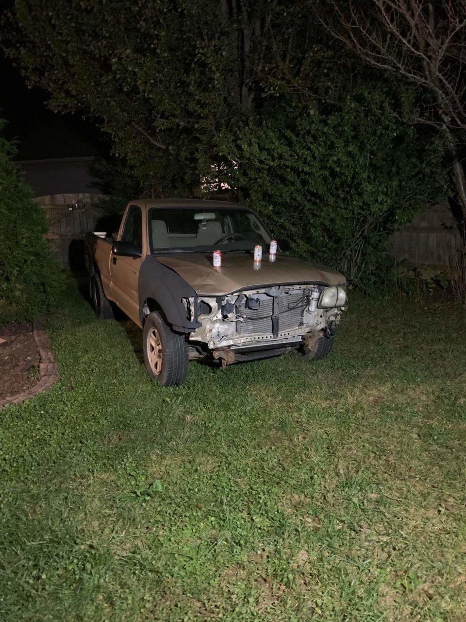

    I bought another 03 Tacoma.
    Got this sucker CHEAP. It's a 2rz 5 lug, clean body, frame in good shape, 5 speed, some front end damage, but runs and drives well. Idea is to make a fun lemons car next summer/spring.

    Exhaust is fab'd and hung, routing interferes with the stock E-brake cable hanging point, I'll probably modify the routing of this.
    Need to make a heat shield for the drivers side cat and for the Slave cylinder.
    Bought a water plumbing kit, and a measured out a serpentine belt length, routing is almost the same as 1GR routing.
    for the intake manifold, I'll end up using an ABS 3D printed adapter, plastic welded to the upper manifold, hopefully that holds up! I also need to re-sell the various manifolds I bought to re-coup some costs..
    Still haven't plumbed fuel or completed wiring...

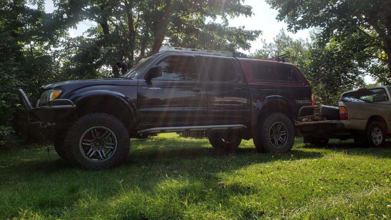

    Also got my hands on a camper top (in red)!

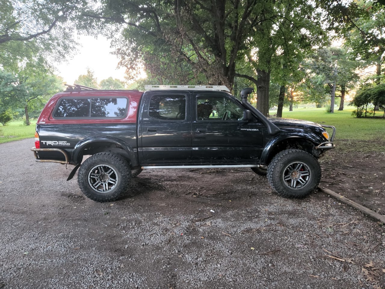

    Well, truck runs!!
    It's louder than expected and revs like a racecar!
    Still need to sort out several things...
    -AC lines need to be connected
    -airbox needs to be modified for the new MAF tube
    -gauge fuse pops every time I turn the key on, really need to figure this out.
    Going away for the weekend so I won't be able to troubleshoot much.

    Went for my first drive!!
    Initially I was underwhelmed... The truck feels about the same as the 5vz. After checking the data log, the throttle body was only opening 22%
    Time for some trouble shooting, as soon as it's running full tilt, I'll be putting the interior back in!!

    Well she's out of the garage, drove about 85 miles today, ECU is in limp mode, but there's no codes which is very strange... Tuner is going to ship me a new ECU and throttle pedal, so hopefully that will get me straightened out! 20220723_170848.jpgfinally got to put the topper on!

    Figured out the issue, the Sienna stp and st- signals dont function the same as the Tacoma signals did, I had to snip the st- to get full throttle(ecu was getting brake switch active condition and was cutting the throttle), cruise doeant work now, but I can live with that for a while.
    The exhaust is massively louder than expected, so I'll need to do something about that sooner rather than later. The dump under the bed isnt helping of course...
    The swap feels awesome, torque is good, better than the 5vz by a margin, but the power is amazing, the butt dyno feels like the power is doubled. The motor spins up to 7400, so the feel is very different than a supercharged 5vz, probably quite a bit faster than that too.

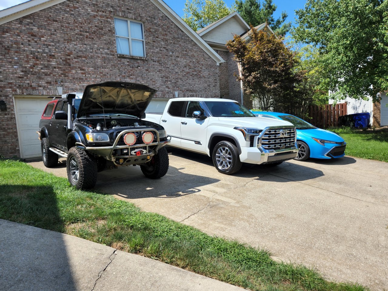

    Took a long lunch break today to play swaparoo at the dealer. We got a little too used to having something easy to drive long distances, so the 3rd gen has been replaced with a Tundra :spending:
    Her Corolla is very likely to go too, to help pay this off fast, and I'll just drive a project as a daily :anonymous:
    Gotta keep at least 1 in running condition now.
    Spending the weekend tracking down the 02 sensor short and doing some of the button up work and maintenance the rig needs.

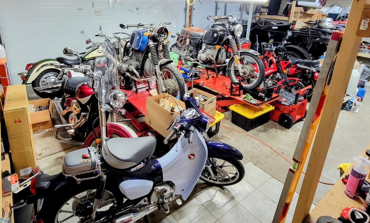

    Jealous you have a garage to work out of. I have a 3 car but it's packed full of other toys. :)
