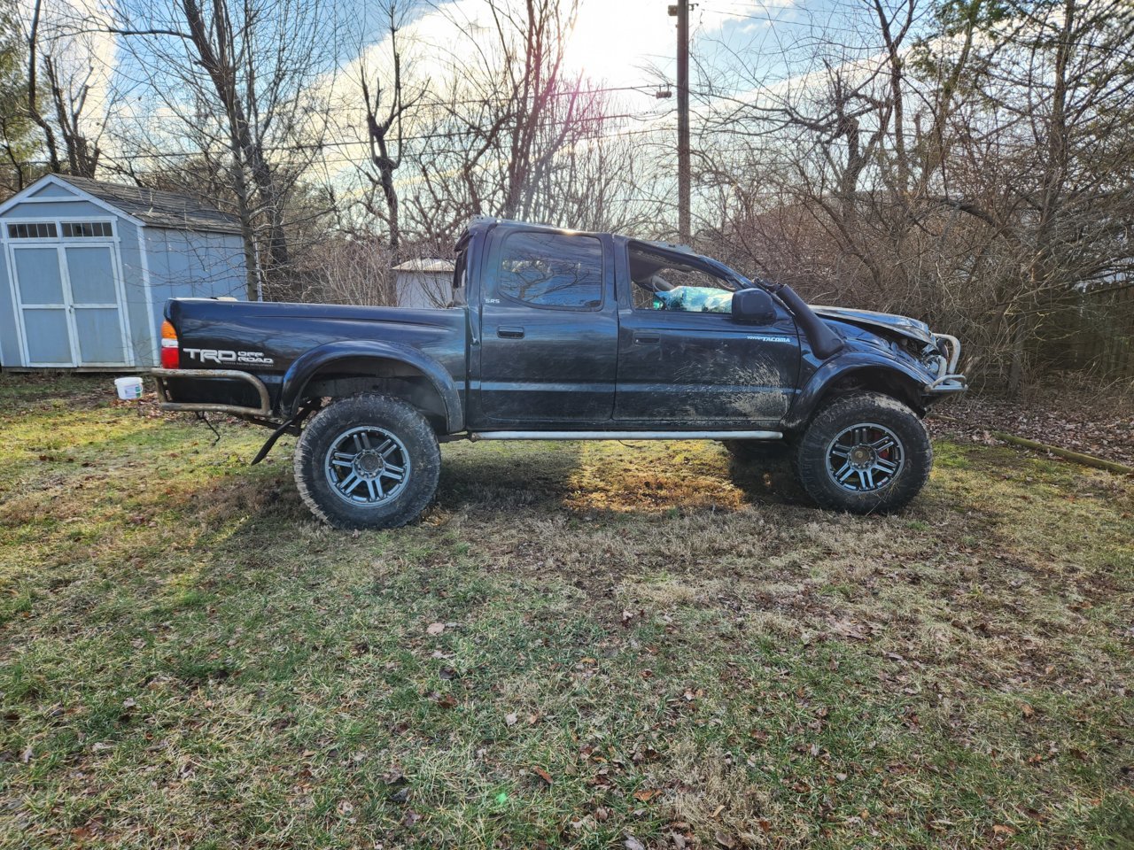

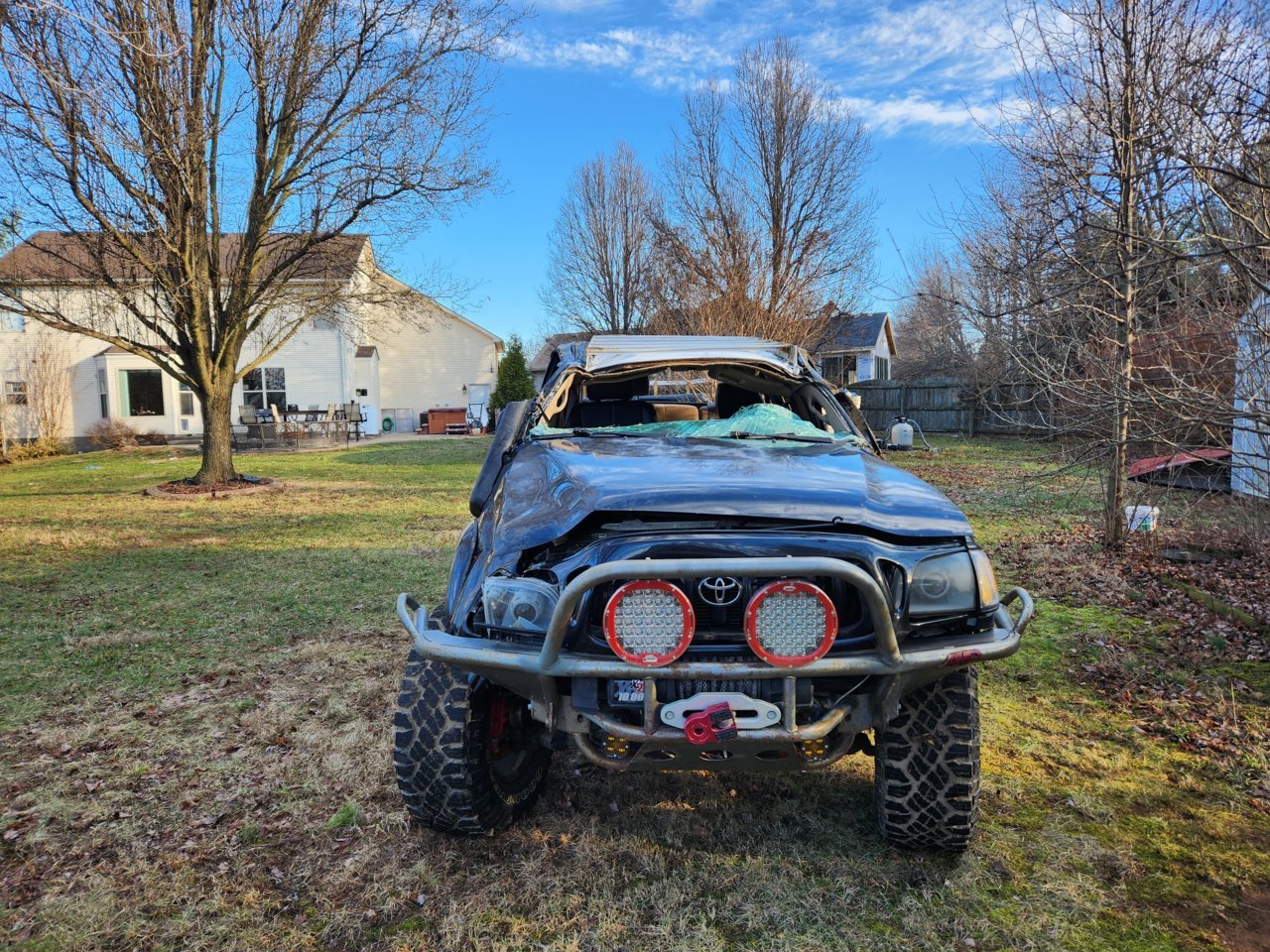

    Well I have a sad update for the build.
    Near the end of the year, I (and the truck) was involved in an accident that resulted in a 2x rollover down an embankment. Not a lot of details to share... in hindsight it should have been avoidable, but thats how hindsight works I guess.
    Damage to the truck is pretty bad, I ended up with a concussion and hospital trip, but no other injuries fortunately.
    Damage Pics:
    I've had an incredibly busy start to the year, and haven't been able to do much about anything regarding the truck until recently... I haven't been able to check the frame for straightness yet, it still runs and drives, no fluid leaks, the rear definitely looks tweaked to me, but I don't know if its the bumper, the bed, the frame, or all three.

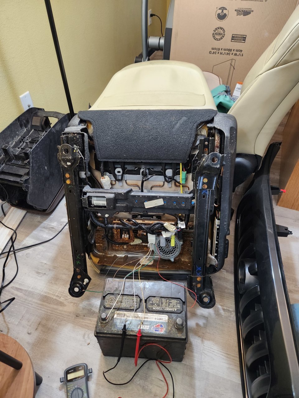

    Spent a few hours actually figuring out how the 2014 Avalon seats I have work, the Heating function and Blower function are actually pretty easy to get working, however the stock controls are not, so "full heat" or "full cool" are what I think I will end up with.

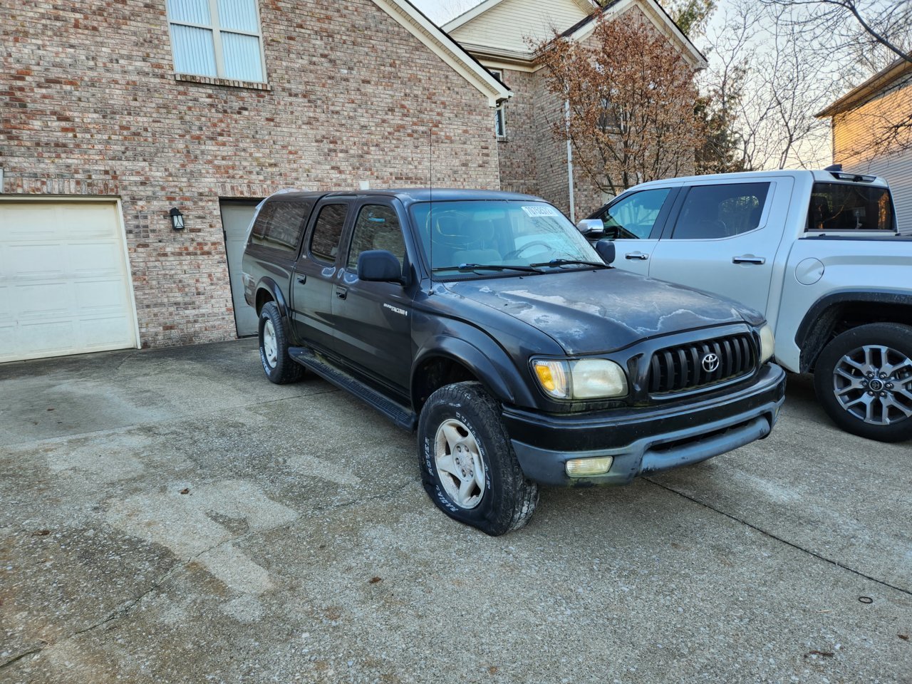

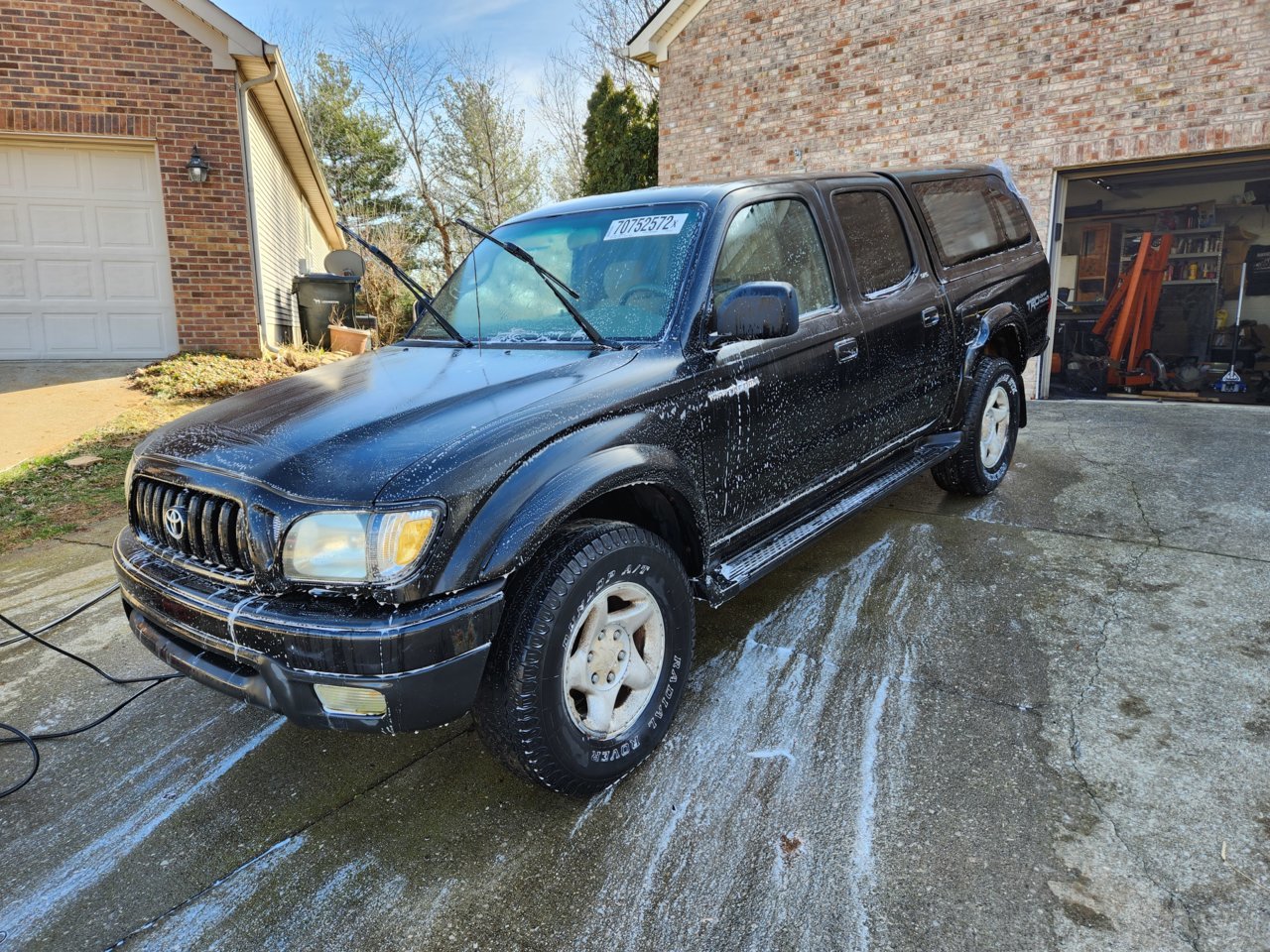

    Coincidently, as I started stalking facebook and Copart for cabs, several 1st gen double cabs were up for sale at my local Copart, so I ended up buying one for what I think is a fair deal.

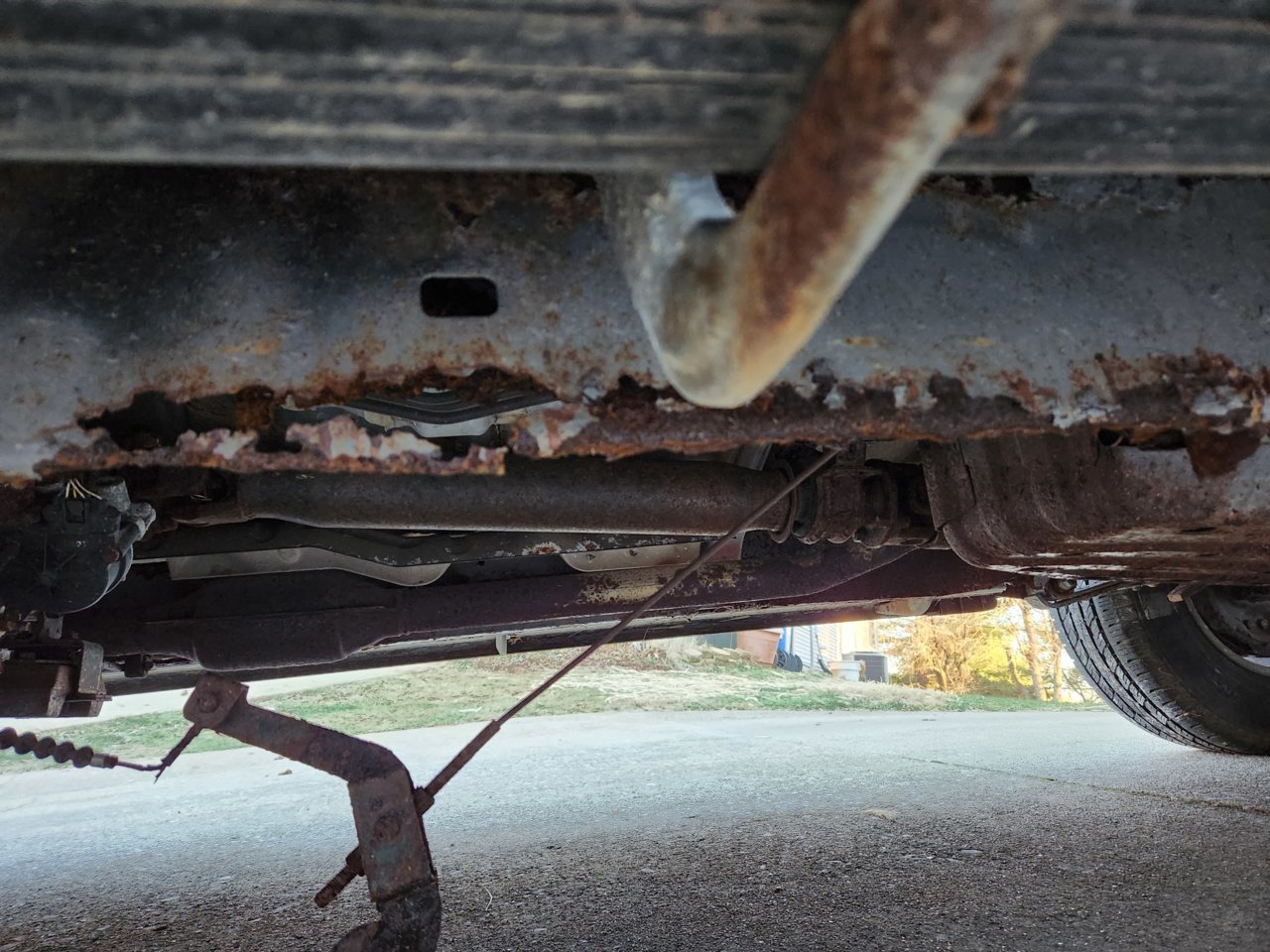

    This was a 1 owner truck that never got a new frame, and the current frame has evidence of attempted repair, but its wayyy too far gone. Clearcoat is in super bad shape, but the Cab and Bed are both Less rusty than the wrecked truck, so this may yet work out.

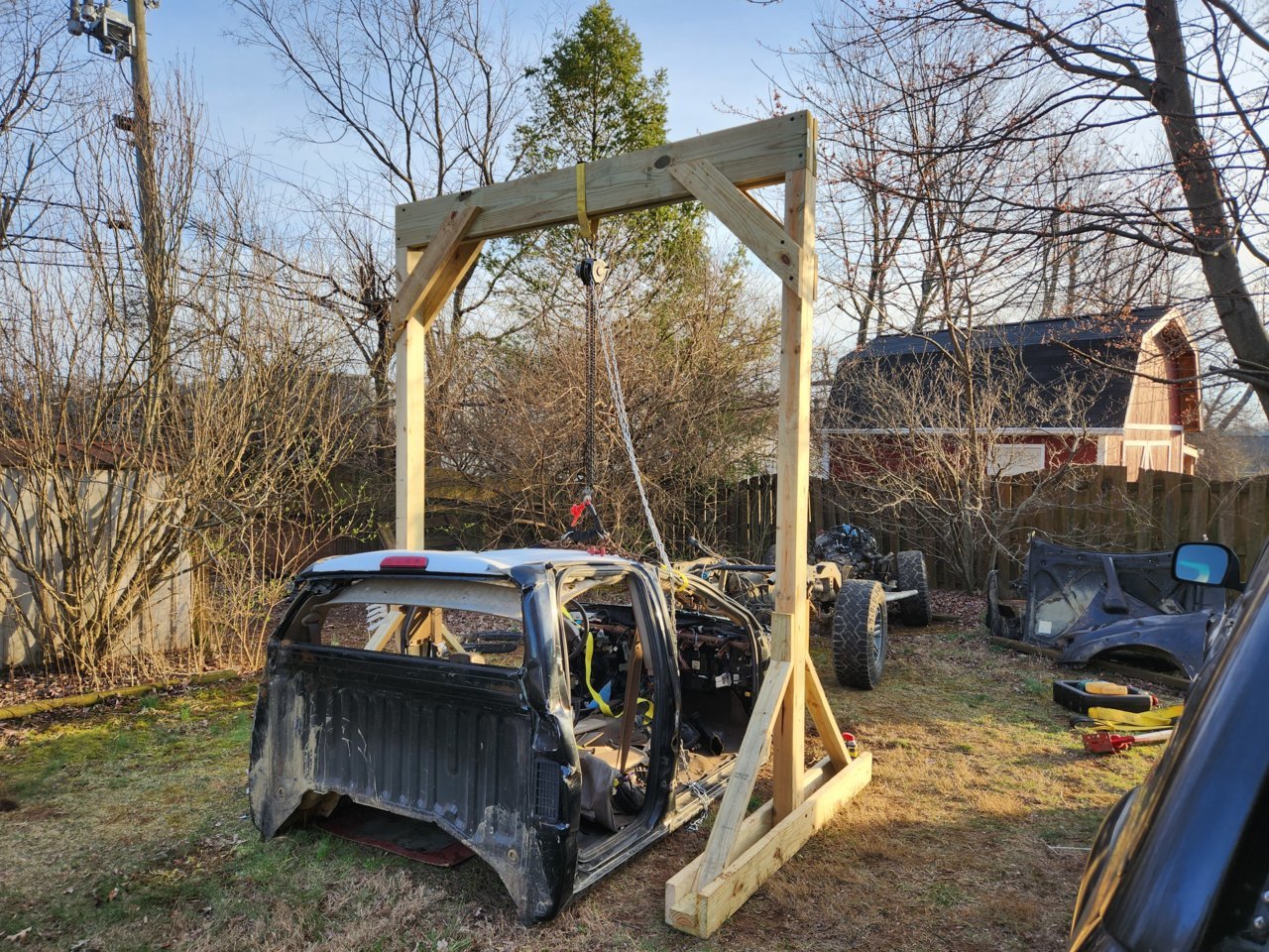

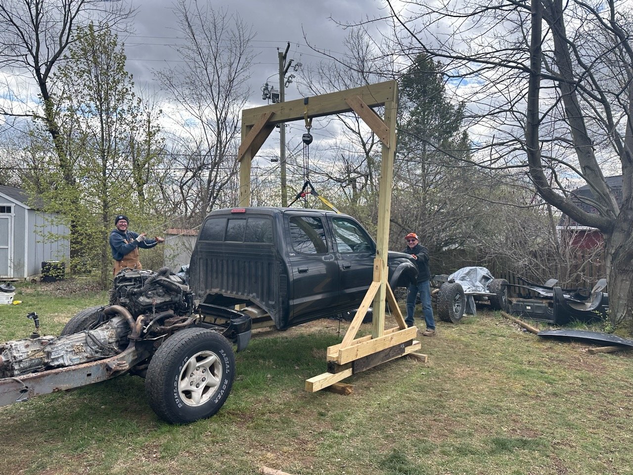

    Still pretty pissed about the whole thing, but this was the first weekend I had time to work on the trucks.
    I built a wooden gantry and got a 1k lbs chainfall.
    I got the wrecked cab stripped and off the frame pretty quickly with help from my fiancee.
    I definitely should have gone 12 foot high on the posts 10 foot was inches too short, I had to pull the front coilovers to get it out.
    I'll probably just put 8' 4x4s under the gantry legs for the next stage.... In a few weeks when I actually have time.
    Currenty I'm not planning to take the time to make sure cab and frame are perfect, the new cab has waaaay less rust than the wrecked cab, but the taquito occupying the work bay in my garage needs to be rolling asap.

    I can do that, I was thinking to keep the dash/firewall section so I can do easy test fits for some engine bay fab I want to do in the future, but w/e
    The floor side of the driver rocker is NOT rust free FYI

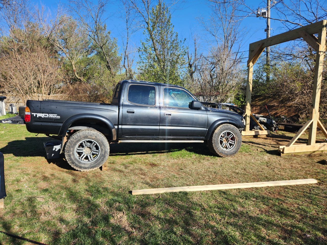

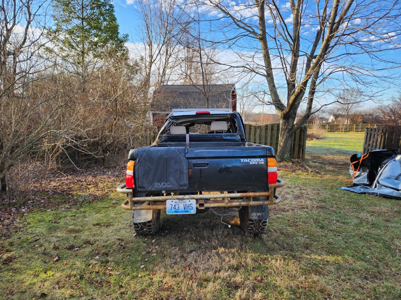

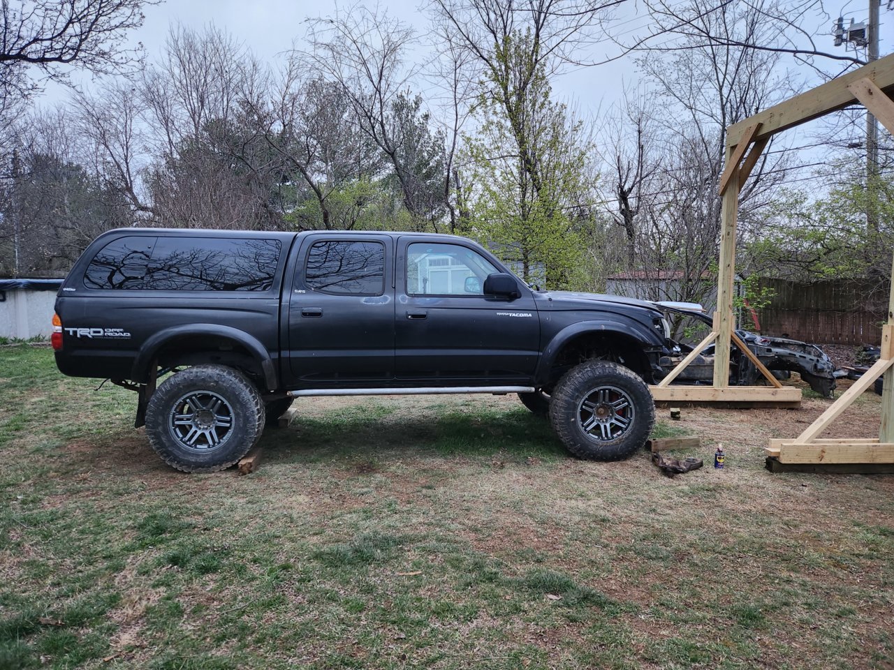

    Dedicated this past weekend to working on the truck..
    I got the good cab and bed on the "good frame" swapped over the cab wiring harness as the 01 cab didn't have ABS, it also was a little easier to keep the various mods I had integrated into the harness already.
    My dad traveled to KY for the weekend to help, and made sure we got a lot done. He also repaired several fence posts that were broken in the wind storm the previous weekend.20230320_173908.jpg
    I say "good frame" because now that I had a straight body and bed, it was obvious that the frame IS infact tweaked a little, its twisted a bit... with the front cab mounts as "zero" the rear right corner of the frame is up about 3/4" and the front right rad support mount is down 1/4"
    The back end is pretty noticeable and needs to be fixed one way or another, I'm going to get a quote for frame straightening from a couple body shops. Eventually I may be able to fix myself by doing a back half or something, but I'd prefer to straighten the frame out.
    Hopefully I can get out of work one day this week to put the front shocks back on and reinstall the cooling systems and bumpers before the weekend.

    I'm also not sure if the frame was twisted the whole time, or just since the accident... The old bed wasn't square, but did line up with the cab very well...
    Managed to stop working at a reasonable time today for once and put the front shocks back on, which required replacing the right front control arm.
    Rickety rig is starting to look good again!
