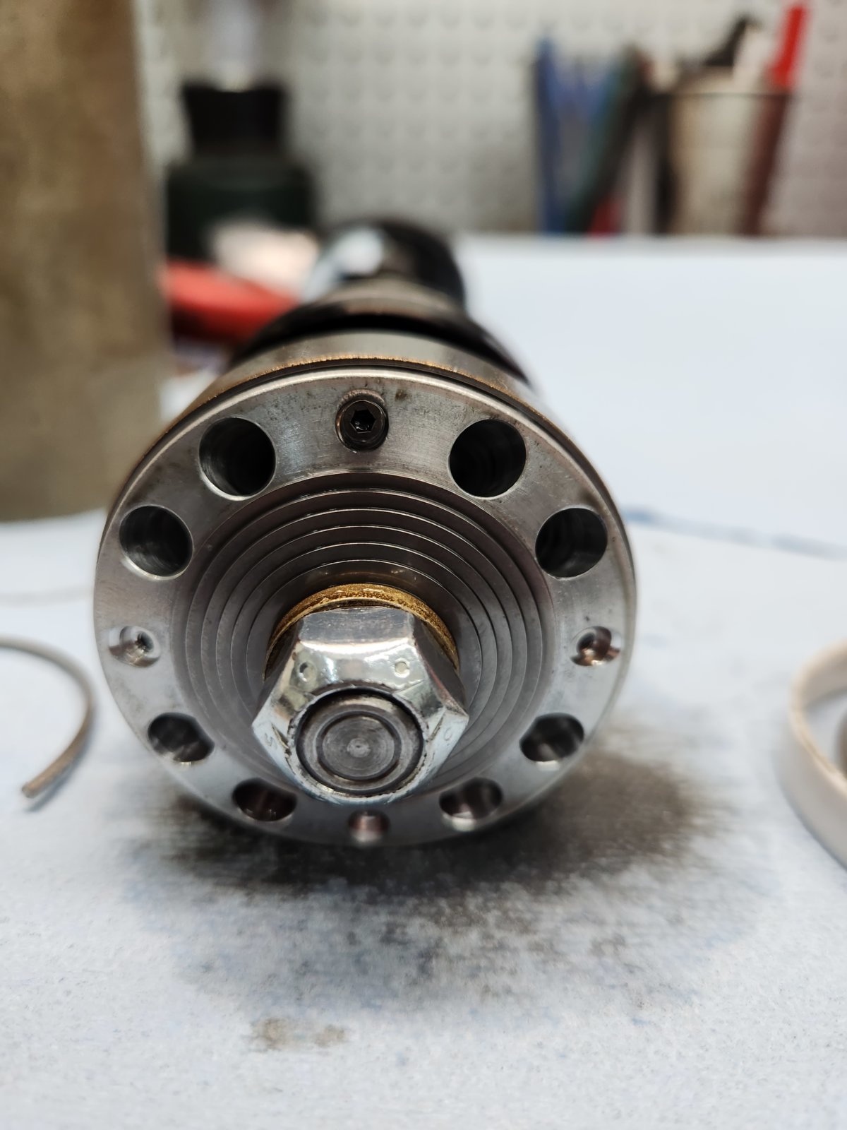

    Much needed maintenance over MLK long weekend, shocks rebuilt with fresh seals, also changed the first flutter shim from .008 to .012. Also Front Right Wheel bearing.... again
