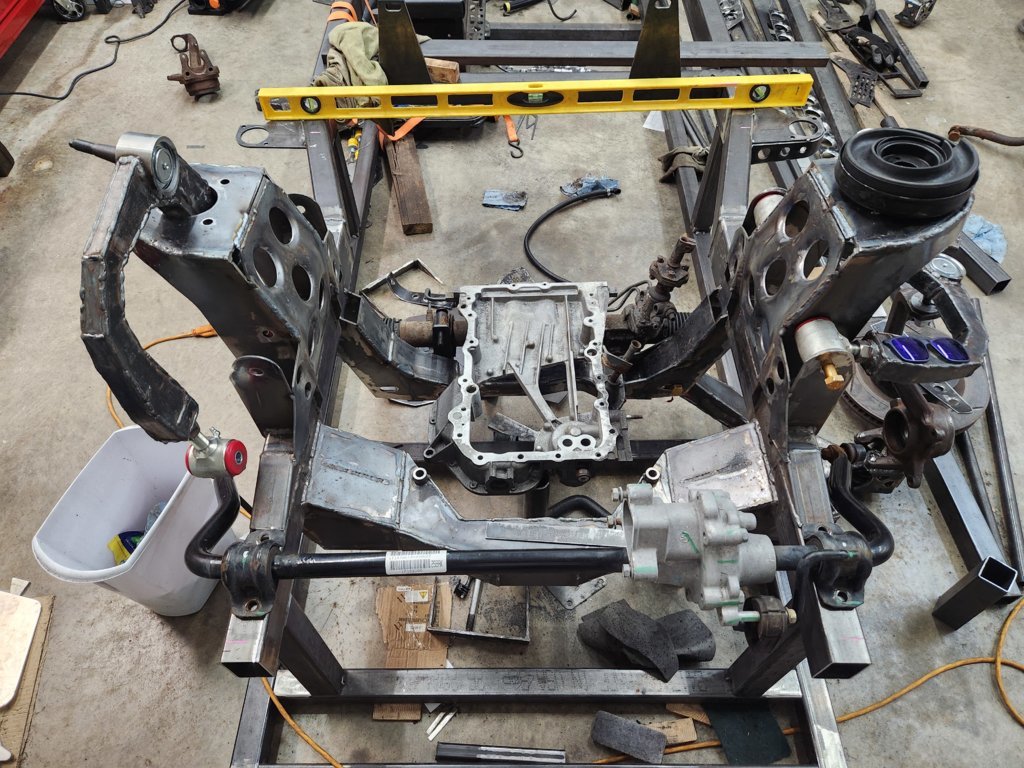

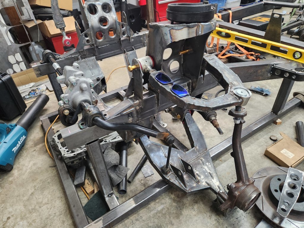

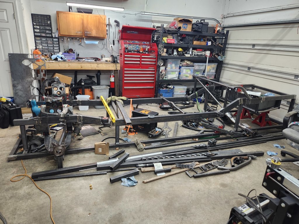

    Had help this weekend from my Dad and wife.
    It may not look like it but we got a ton of things made/measured/fit to the frame. A ton of burn time still required to be ready to swap, and i need to figure out the logistics of doing the swap...

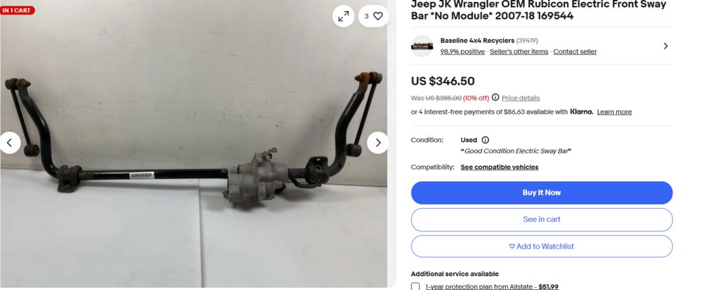

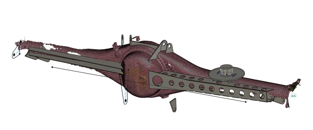

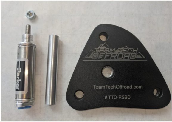

    had time this morning with some PTO before a weekend away with my wife to scan the 8.4 sequoia axle, (well she scanned it) so I made a quick spring mount and truss concept. The fusion 360 mesh tools are pretty neat, once I finalize the truss shape and concept I may make some WIY parts... which I say every step of the way knowing I won't really have time. :ballchain:
    I also pulled the trigger on a JK automatic disconnect sway bar, which I will retrofit to the front of the truck. I think it would even be a pretty easy retrofit on a non-custom frame, so I'll check that as well of course.
    If things go well, I will get another one for the rear, and make some custom arms... and possibly center section to get the ~26" arms I need to have a ~75lb/in wheel rate effect I think I need for handling.
    ~$350 shipped isn't too bad imo
    The pneumatic adapter from the jeep scene looks stupid easy to replicate, I feel a little bad ripping off the concept, but if this was $100 ($30 cylinder, $8 threaded stock, $30 machined aluminum plate, $5 coating) instead of $300, well I'd buy rather than make, but I won't be selling plates, so no infringement of their rights?

    Is the pneumatic adapter used to interface with the swaybar disconnect module?
    Bandido[OP] likes this.

    Its to replace the mopar electric actuator. Which according to the jeep people is the main issue with the system.

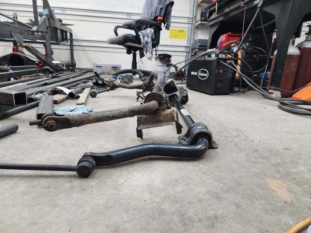

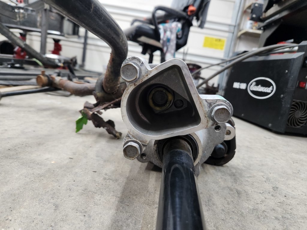

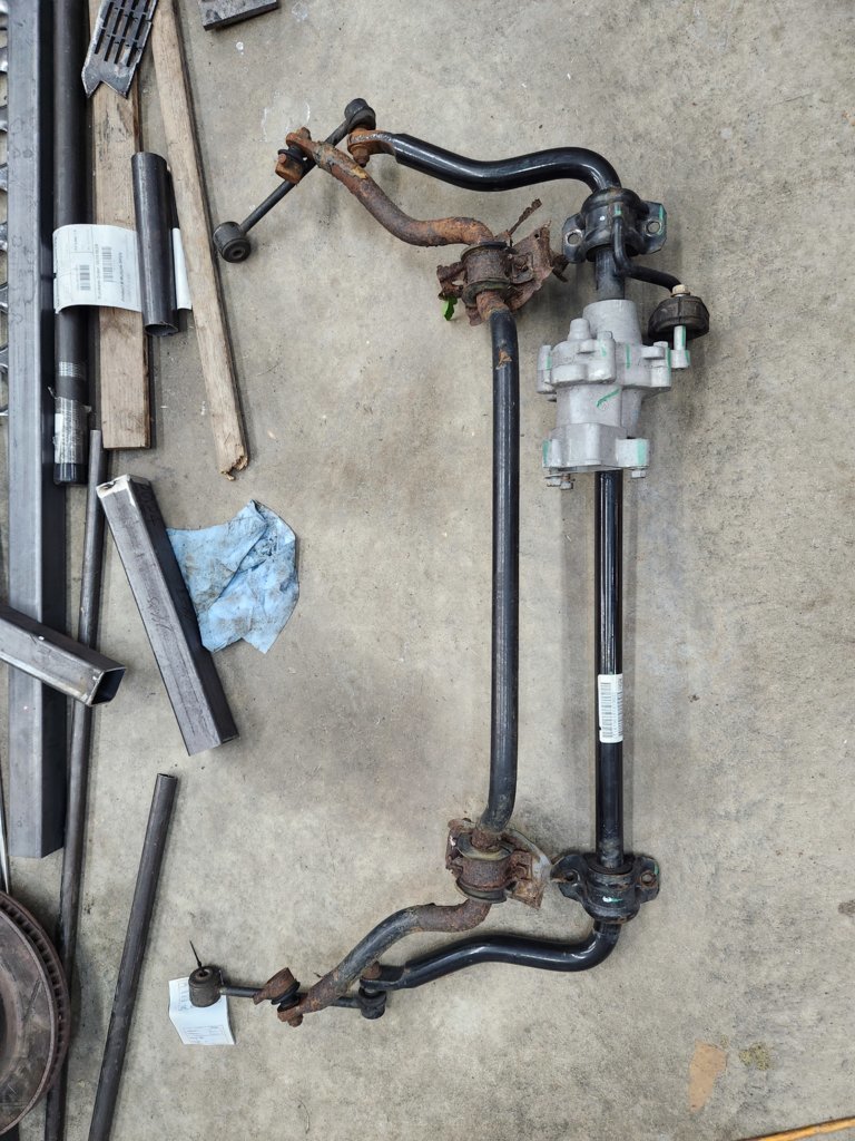

    Jeep swaybar arrived today, its an even better match than I'd hoped for! With a little work, this could probably be adapted to a stock frame with a little bit of work to clear the trans.
    The mechanism is also about as simple as I had hoped, seems like a pnuematic shift unit will nail it.
    As for me, I'm going to mount it to the underside of the forward rails, similar to how a 5 lug mounts the swaybar.
    So like this, but on the bottom side of the frame...
