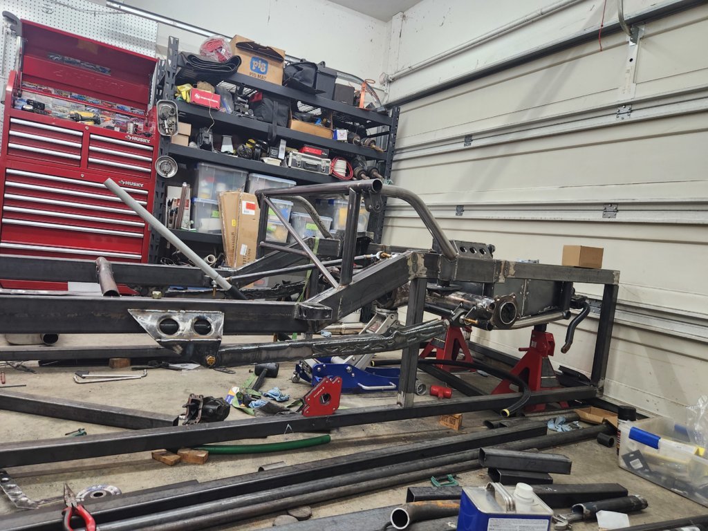

    Traveled over the holiday for a funeral, but took Monday off and was able to fit up the rear sus finally.
    I need to pull the frame off the table to finish weld the bottom of all my joints.
    With the rear sus in I have started to fabricate the exhaust, as expected its tight to the 4 link.
    I did order a 2nd jeep bar for the rear, the mechanism for disconnecting is working well pnuematically!

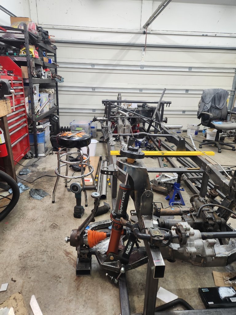

    Had time to work on the chassis some this weekend, and noticed i made a pretty big measurement error that leaves me a little confused... I had the rack travel wrong, its about 6", not 4", and i had the "centered" end position about 1" inboard relTive to the chassis center line...
    What this means is that i either need to sacrifice some bump travel/bumpsteer, or Ackerman geometry, or limit travel to about 14" up front.
    Pretty mad at myself for making this mistake... I guess i really should have tried harder to switch to a front steer rack :annoyed:
    Oh well, have a pic.
