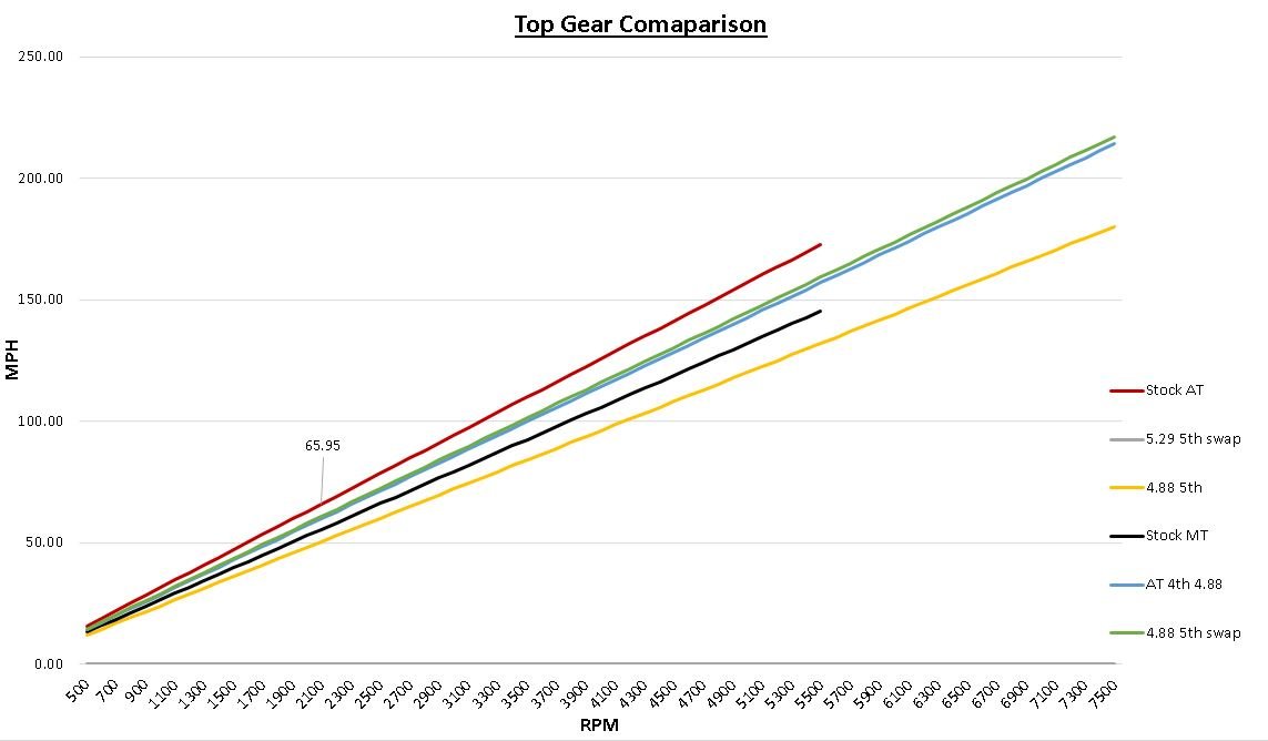

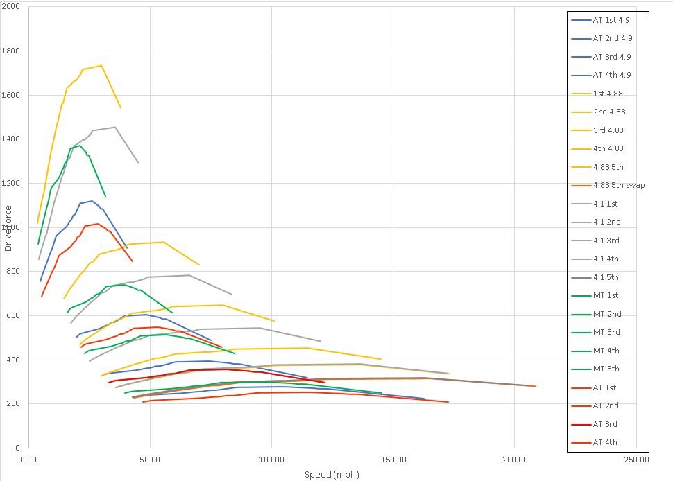

    Since I need to know stuff... I made a spread sheet to help figure it out.
    Below the Stock AT and Stock MT(MT) use 30.5" for tire diameter and everything else uses 33" X and Y axis should really be switched, but W/E.taco_top_gears.jpg
    The AT with 33" tires and 4.88's will maintain almost the same rpm@speed as the MT with .69 5th gear on 33's also with 4.88's.
    Since wheel torque is also a top issue, I made a chart for that too!
    in this one, AT and MT are both 5vz with 30.5 diameter tires.
    My chart doesn't show Torque converter torque/slip, but basically draw a flattish line off to the left of the first slowing in the torque curve to simulate that... So the AT has MUCH less net torque at speed than the MT, however at 0mph, it has lots more 'cause of the magic salad mixer.
    The yellow and grey lines represent a 2GR torque curve. I've mapped some other options, such as 5vz supercharged and 1GR, 1GR supercharged etc, but since I'm currently planning a 2gr swap thats what I left turned on in the plot lol, key point is that the powerband is almost 2k rpm more than the 5vz, with more power and torque.
    The drive force plot doesn't account for the increase in rotational mass of switching to a heavier larger tire, but it should. Maybe I'll make an estimate based on fortera triple tread data and Duratrec data and check the result. Certainly the heavier tire negatively impacts available driving force, and in this case, would lower all the non stock tire curves a little bit.

    with my handy online calculator I've came up with the following: (this is for 4 speed auto)
    stock 4.10 on 30s traveling @70mph I'll be in (2266rpm)
    current 4.88 on 33s traveling @70mph I'll be in (2452rpm)
    Option 1: 4.88 on 35s traveling @70mph I'll be in (2312rpm)
    Option 2: 4.88 on 37s traveling @70mph I'll be in (2187rpm)
    Now with a 5 speed swap here are the numbers:
    4.88 on 33s traveling @70mph I'll be in (2915rpm)
    Option 1: 4.88 on 35s traveling @70mph I'll be in (2748rpm)
    Option 2: 4.88 on 37s traveling @70mph I'll be in (2600rpm)
    I think the 3.4 5 speed swap on 37s will be different from stock running at 334rpm higher @70mph is as close as ill get.
