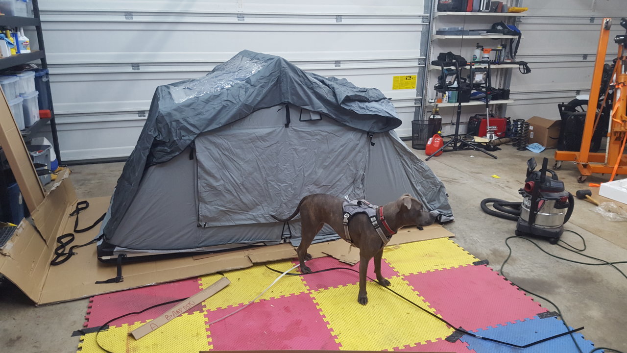

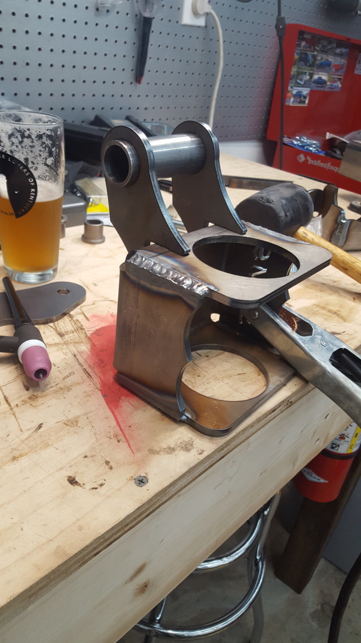

    So I took some "progress" pics... I'm starting to get better at that?
    Trying to use my engine hoist on the bender didn't work so great... it worked, but not well, and I definitely F'd $20 of tube on that try, out of plane bends and all that.
    Gluing together the ram mount from SWAG Offroad, pretty handy little kit they've got.
    I also received the CVT RTT on Wednesday, opened and inspected upon delivery.
    I knew these things were cool, worth the hype and big $$$$? ...TBD
    However, I'm stoked for scene points, pupper is hyped (default setting), GF is glad that we'll stop popping air mattresses:thumbsup:
    So it should be good... definitely need to get the pupper used to the ladder if I manage to get it on the truck for a minute or 10 this weekend.

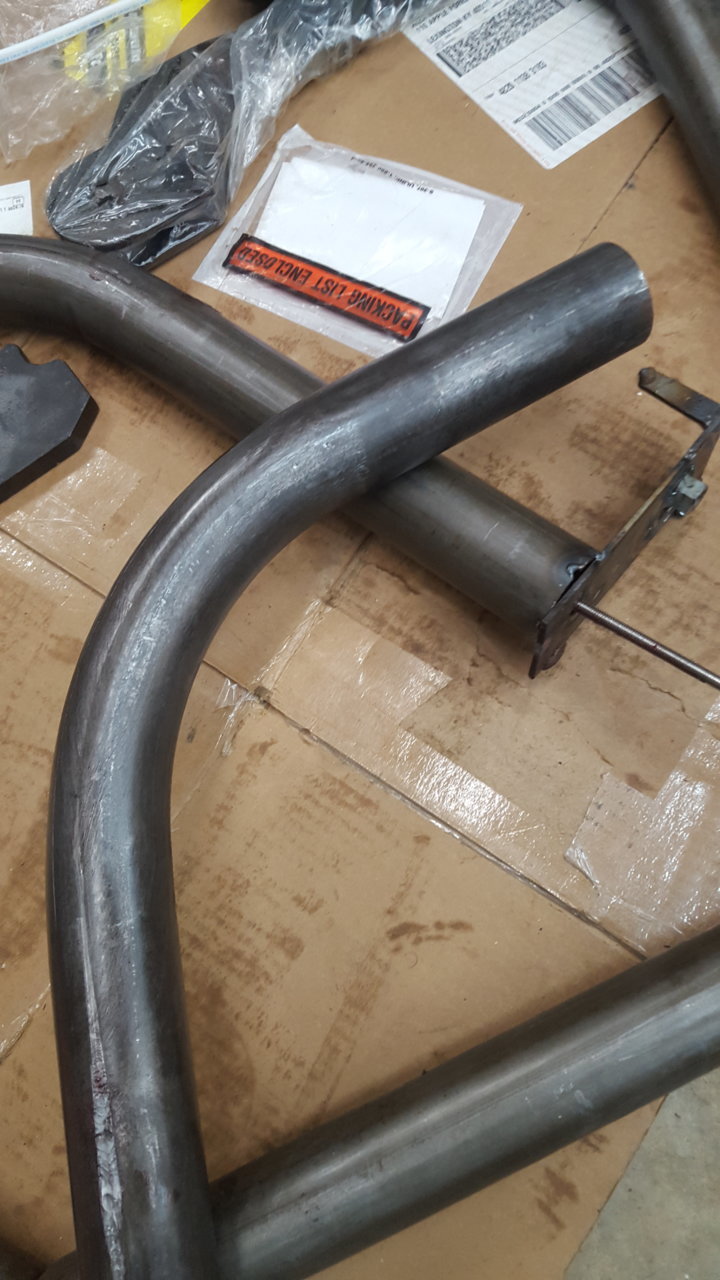

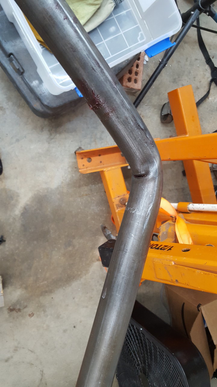

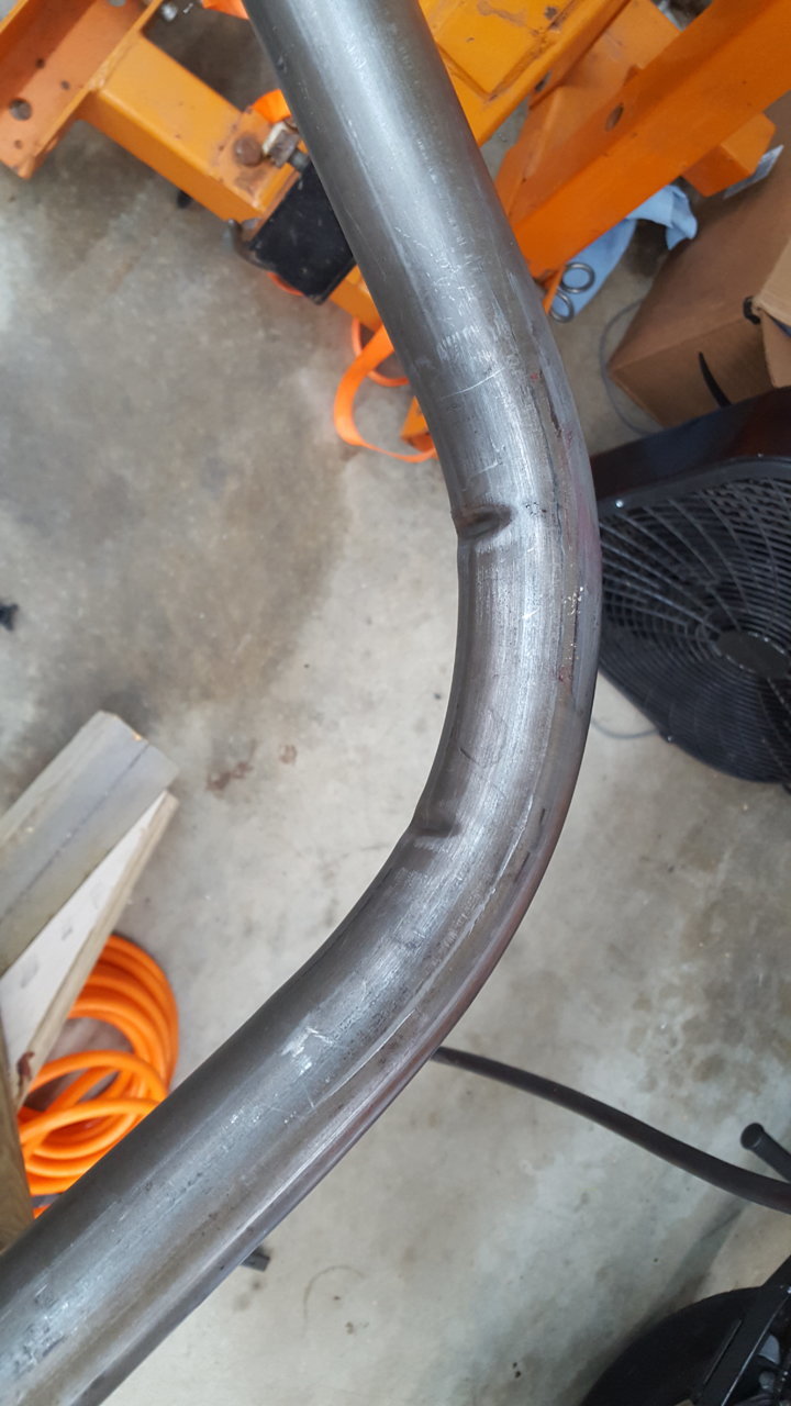

    First bend got me by surprise, it kinked at like 10 degrees... this little cylinder moves way faster than I was prepared for...
    Sent it to 45 for fun.
    Second bend I took my time with, almost got it, but still had two minor kinks, I'm pretty disappointed in myself...
    I noticed the kinks before resetting the lever arm on the bender... so I don't think they are slide-back.
    I'm pretty sure the kinks are from insufficient lubrication and too many deg/min on the bender for the wall/diameter tubing I'm trying to bend.
    I'm gonna run to Home Desperate when it opens for a bag of sand.
    Hopefully I can get the Tent bars built tomorrow.
    The Light hoop tube is now the test tube, fortunately 1.75" x .065" DOM is only ~$4 a foot :/

    The effort to bend 1.75"x.065" is sooo not worth the weight savings...
    pic of Sandrel FTW
    Definitely gonna stick to .120" so I can bend a tube in 2 mins instead of 2 hours :frusty:

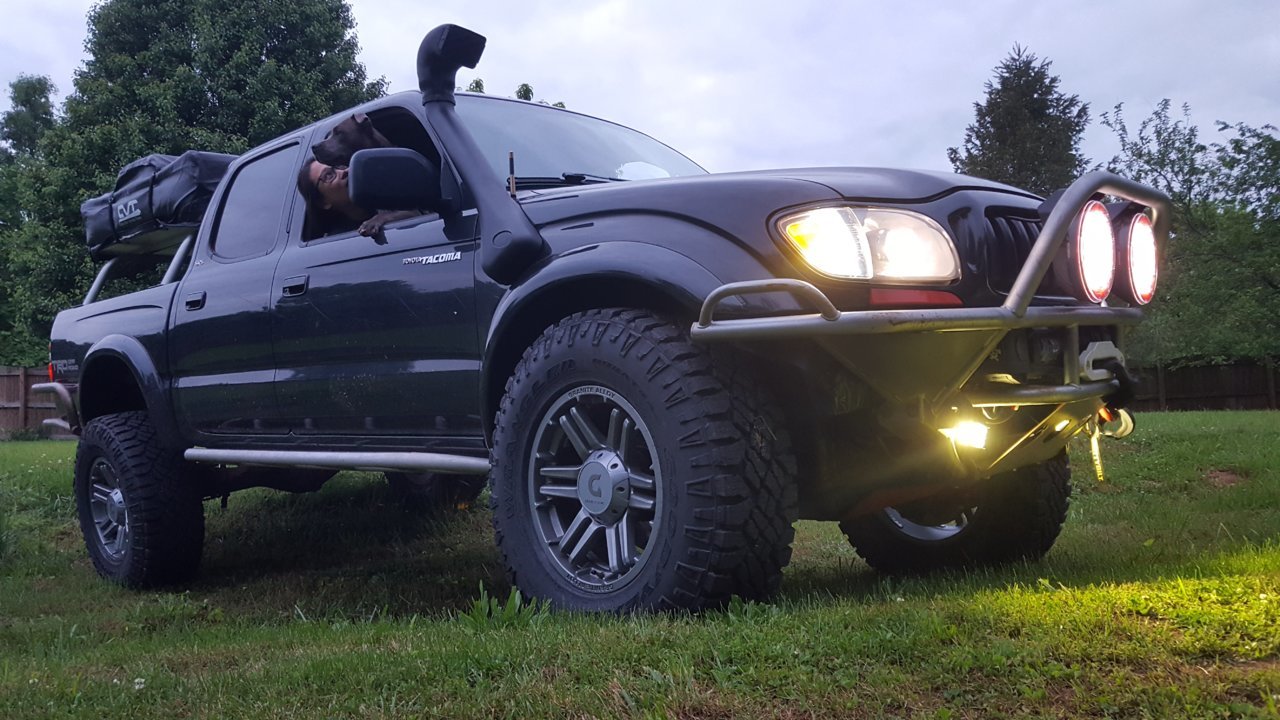

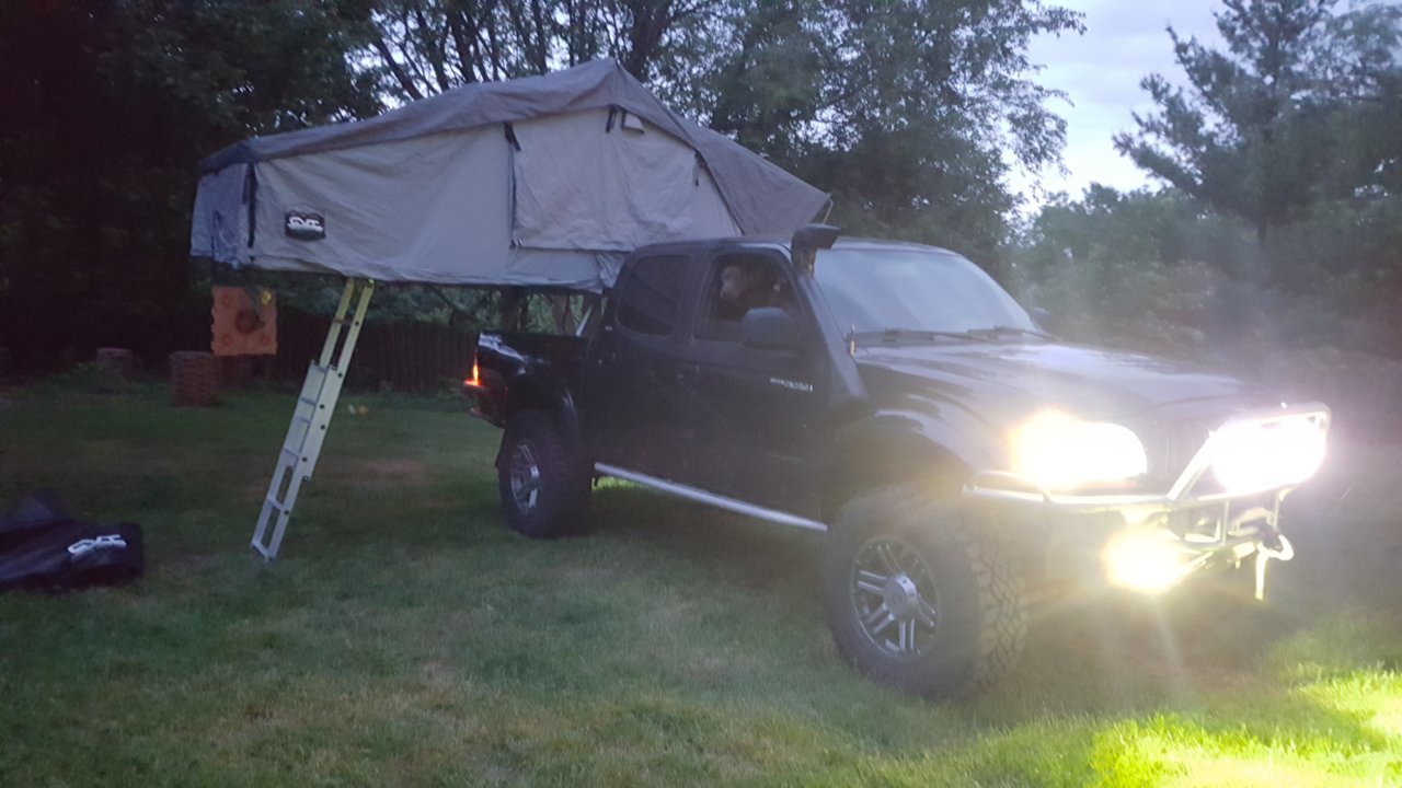

    Update:
    Got almost all my lights on, rocklights and reverse lights still pending.
    New light hoop bent & welded
    bed bars made &welded
    gastank skid installed
    sick ass fuse box made and installed
    paranoid fab single switch holder installed
    Spotlights installed
    fog lights installed (and tinted yellow)
    Camry(?) power seats installed - the heating/cooling functions not currently working however :(
    RTT installed and tested in the back yard :crapstorm:
    20190513_203459.jpg I was excited and had to drive around the backyard to try to get a feel for the new weight up high... totally didn't tho
    Also had to open the tent on the truck for the first time! Our dog has almost figure out Up the ladder, but down looks like it won't be a thing for a while...
    Ready to be trippin around!
