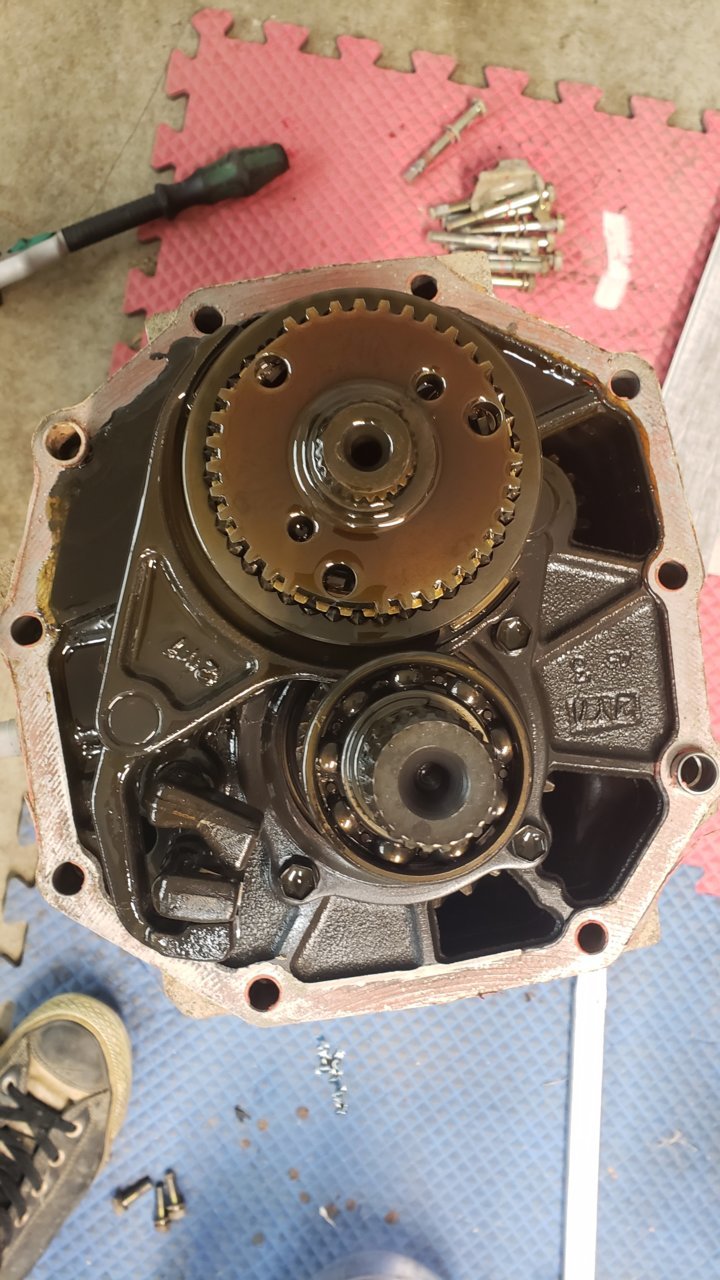

    So I don't forget which 5th gear I have when I go to order in 5-6 beers.20200812_182545.jpg

    Gears just arrived, ordered from megazip.
    Fair price, good communication... would recommend as the source for gears for this mod.
    ~$235 shipped
    Going to install tonight hopefully.

    SO as it happens... if using the later USDM R150F... which I have, you also need the synchro set from the R452.
    if using the earlier R150 or R151, the synchro style should be the same... another thing I guess I should have checked.
    welp 2 more weeks of waiting I guess.

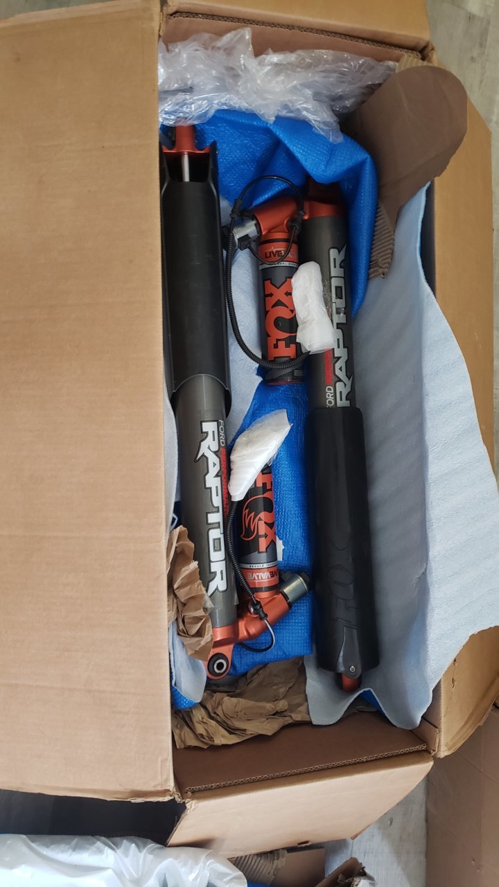

    Did a test fit Sunday, I'll need some misalignment spacers for sure, also it looks like my current mounting setup has the shock sitting with barely 3" uptravel, about an inch and a half less than my kings, also thats into the bumpstop zone on the fox.
    It might be time for Archive garage mounts or a custom job?

  13. Aug 31, 2020 at 6:06 AM
    #113
    rdpoe
    rdpoe #2WDFTW
    May 28, 2018
    #254789
    1,733
    Central Kentucky
    2019 TRD OR DCLB (Sold), Honda Civic TRD PRO
    You're a mad scientist...
    I'll have evenings free over the long weekend and starting next week if you want an extra set of hands
    Bandido[QUOTED][OP] likes this.

  15. Aug 31, 2020 at 11:56 AM
    #115
    Dalandser
    Dalandser ¡Me Gustan Las Tacos-mas!
    Feb 19, 2015
    #149090
    17,635
    Anthony
    Downey
    08 PreRunner Regular Cab / 98 4x4 Extra Cab
    Empty Wallet Mod

    Thats definitely a considered option.
    Tube style or plate style is TBD... Personally I would want to kick the angle forward a little more to protect the reservoir from the tire a little better in flex as well as get the inboard point higher to allow more bump.
    If that motion ratio requires me to revlave (running max soft just to survive), so be it... at least the primary is pretty easy to do on these.

    With 2.5" shocks valved correctly and spring under axle / beefier spring packs it's not really a big deal with 190 hp.
