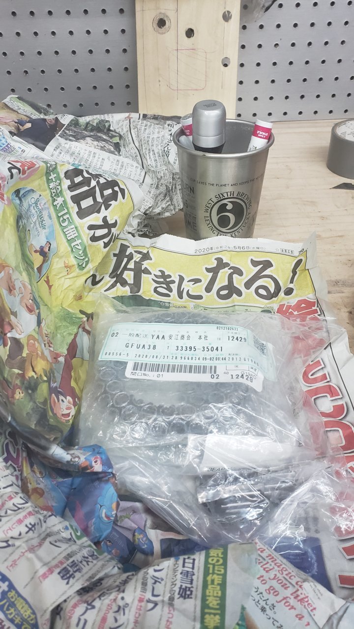

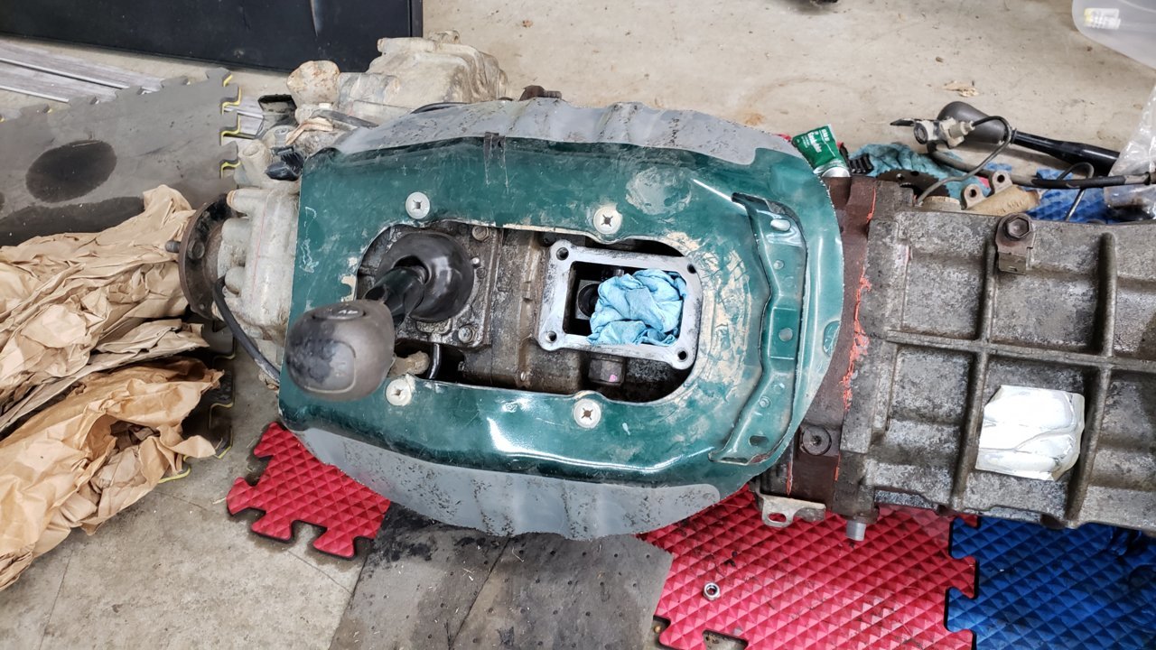

    Synchros and stuff arrived super fast...20200904_102726.jpg JDM af.
    Took a long lunch break WFH to install.
    I'll now have about the same overdrive as the AT. I need to install soon!!

    Overdrive change, discussed a bit ago, just finally got around to completing it.

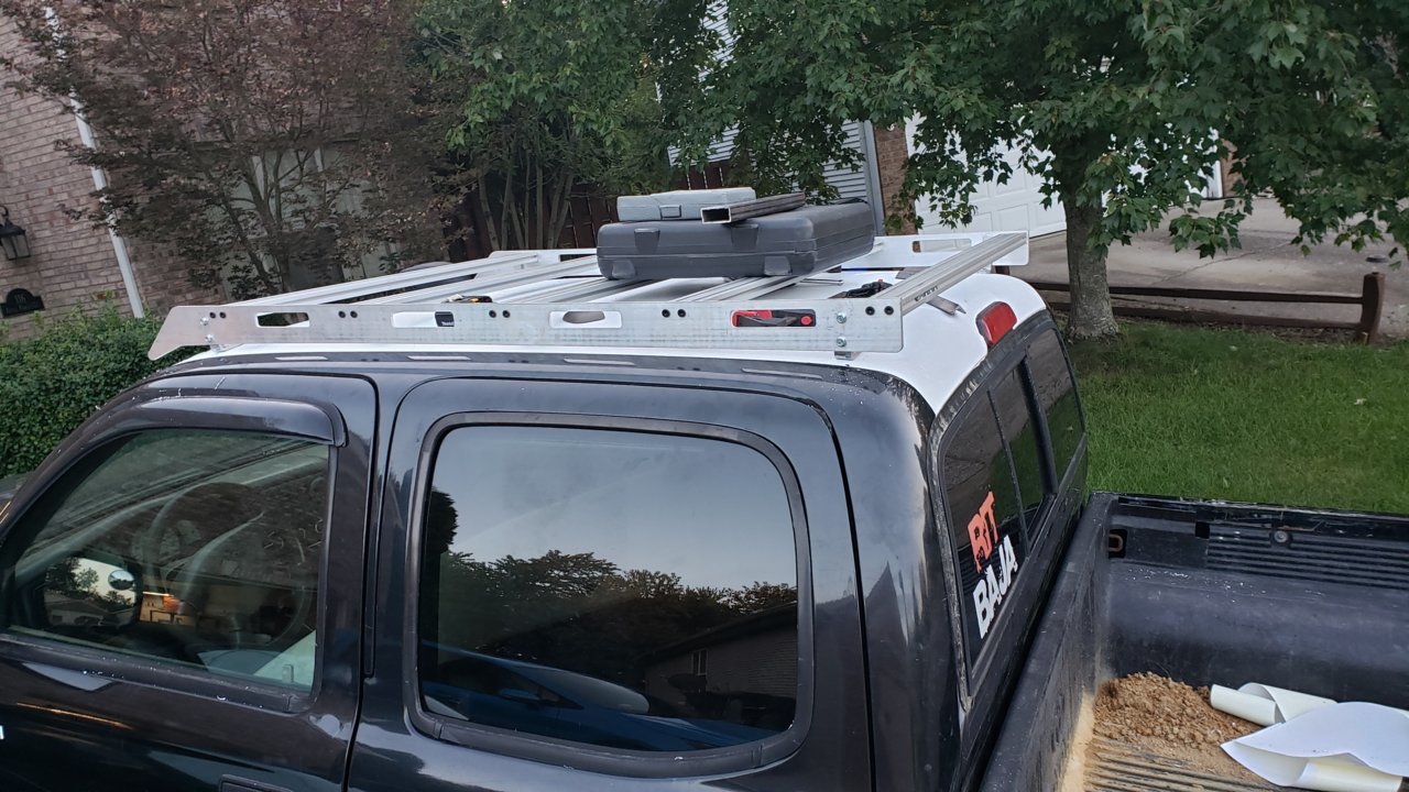

    Diy roof rack installed this weekend, also wrapped the roof terribly. I'll re-do it sometime next year I guess?
    Also put some sound deadener on the roof while the headliner was removed.
