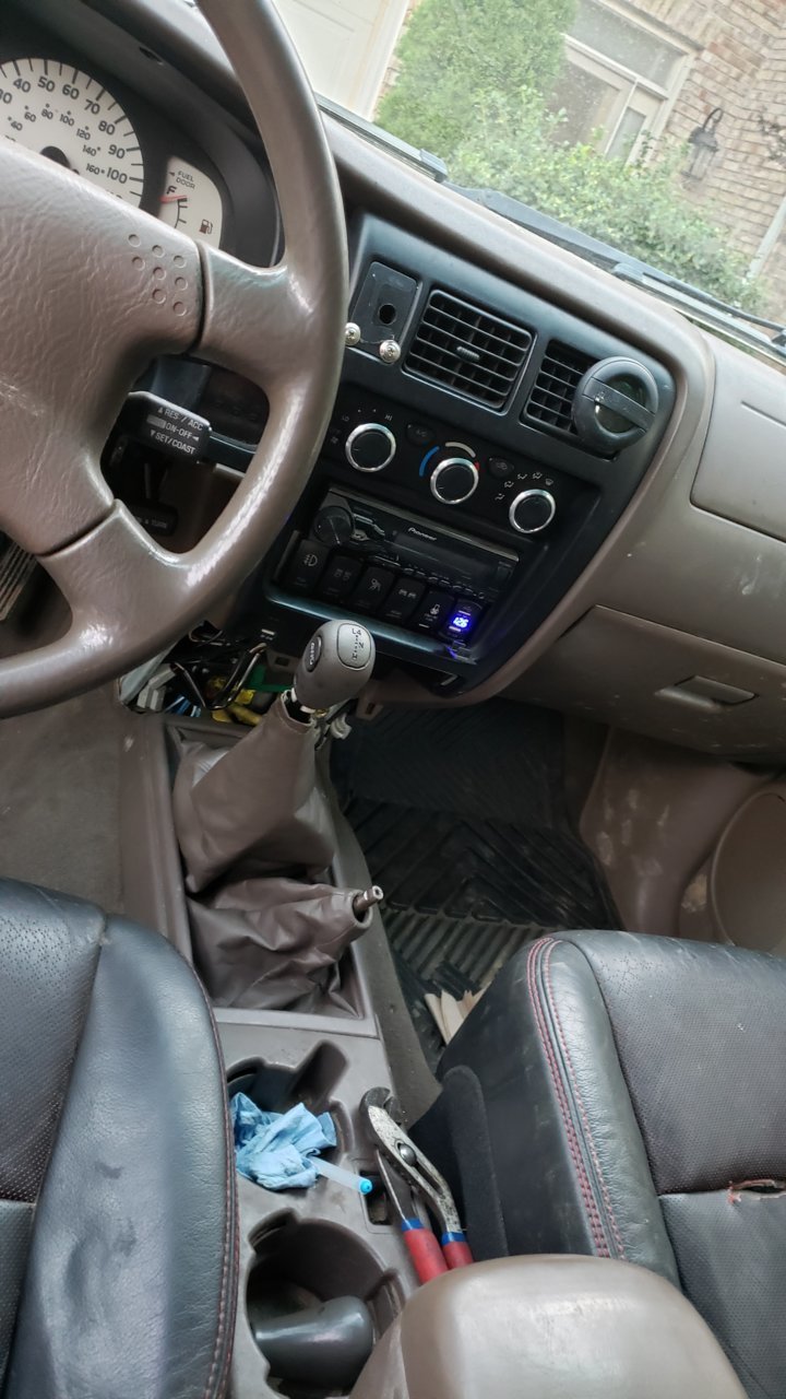

    I also lug hard in 5th now with the current gears/TQ. Happy with the 5th swap, should keep the highway positively pleasant with 4.88's

    Still need a few bits to finish everything off. Does anyone know of a good L-N-H shift knob? I'm gonna be running the 4x button on the 5spd shifter for sure lol.
