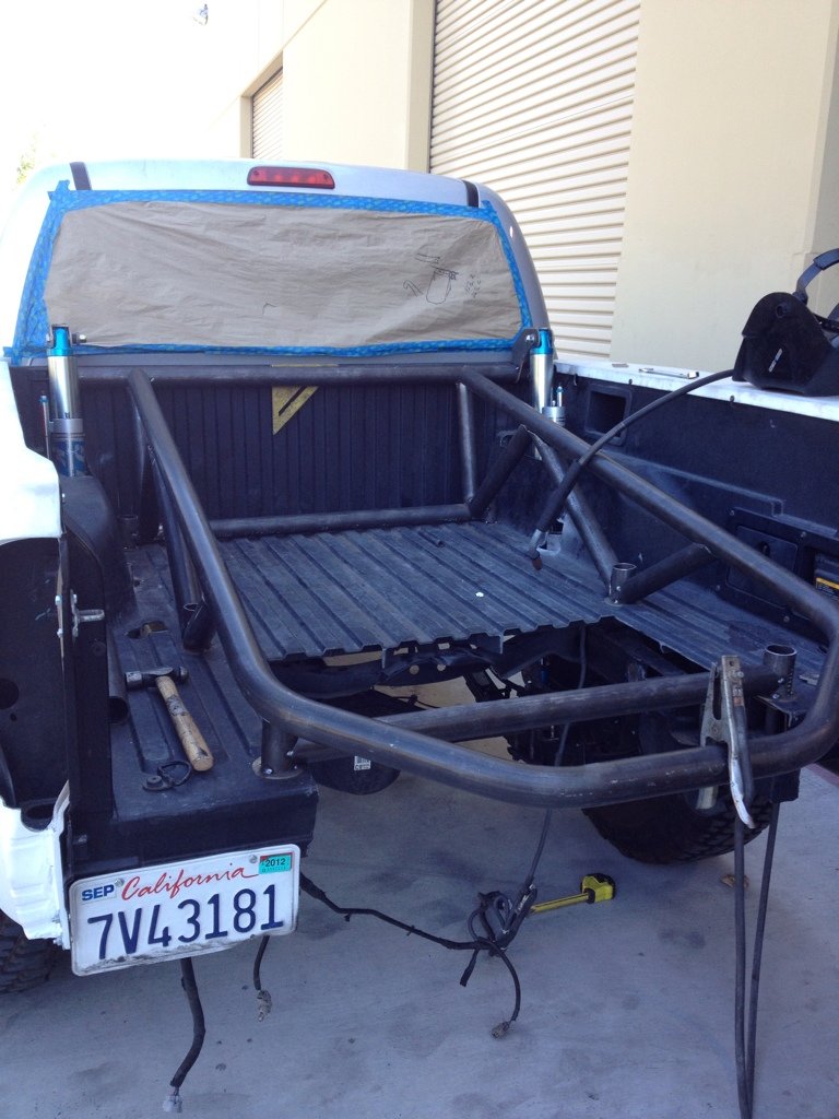

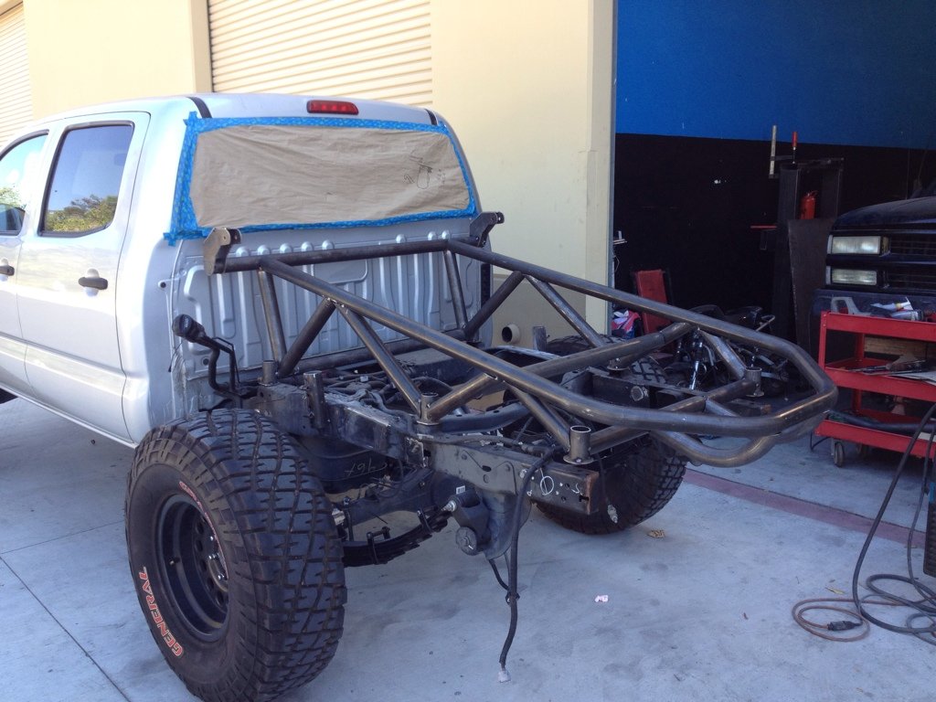

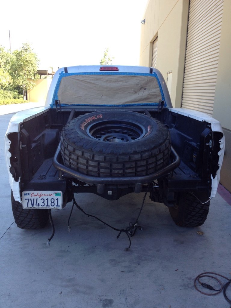

    Ok well changed the design will be installing the defined kit tomorrow and finishing he tire carrier hopefully.
    Basic bed saver style all welded up and ready for SUA kit
    Will be puttin a few more braces in and making an area behind the tires for two gas cans

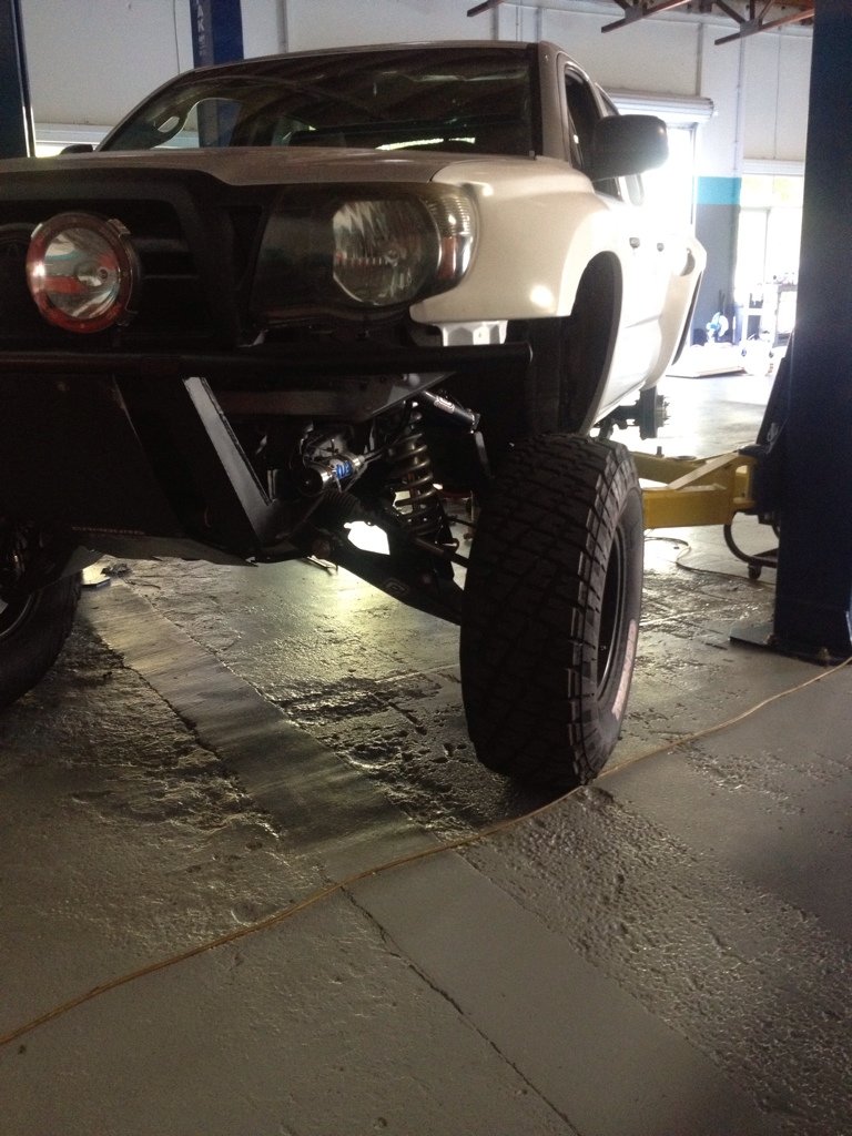

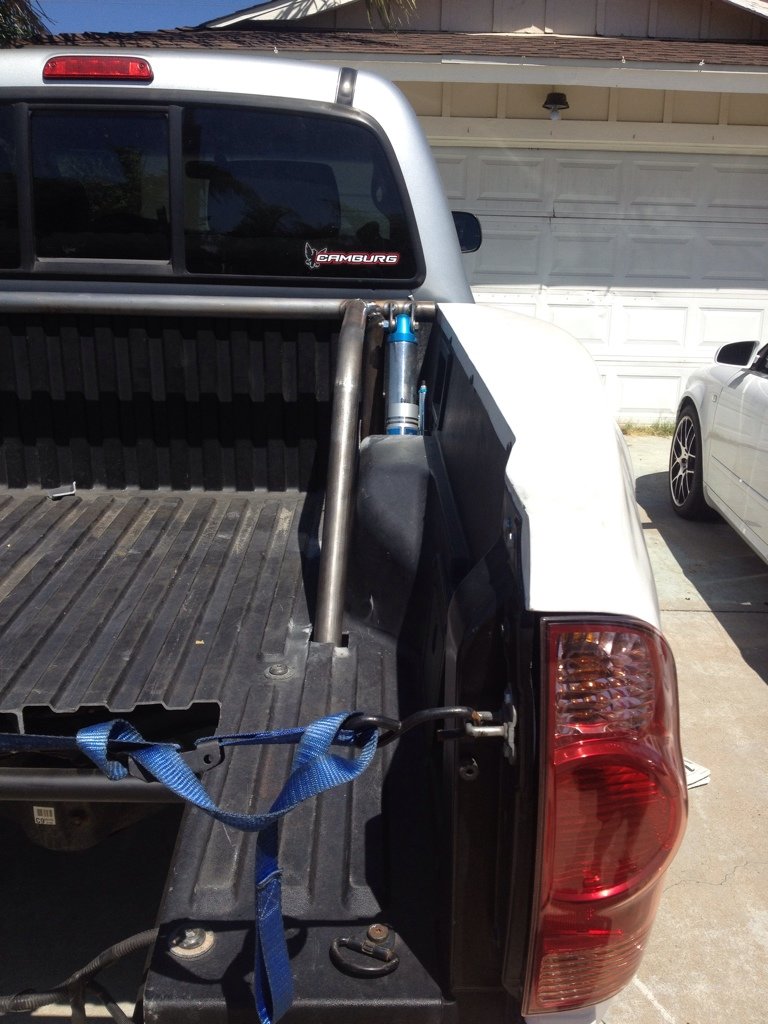

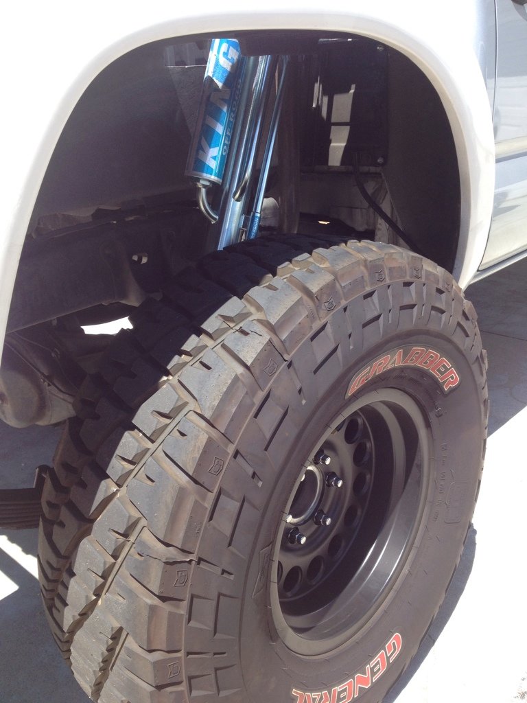

    Shitty picture, long day of installing. Drives pretty different the body roll is pretty fun just need to get the weight in the bed, limit straps and break lines. Oh and a slip yoke damn 2wd. Will get more pics later

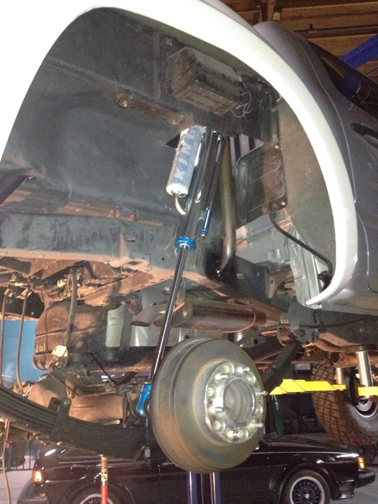

    This too. The cage looks sick chris! Why did you guys mount the shocks so high if they are 16s? Mine and most others are level with the bed.

    Do you have a slip yoke? When you installed the spring perch did you just weld it parrallel with the top one?
  20. Sep 15, 2012 at 12:22 PM
    #60
    Bandwagon
    Bandwagon [OP] Well-Known Member
    Jan 8, 2012
    #70253
    454
    Escondido/San diego
    Camburg long travel, full glass,
    For whatever reason the shock is way longer then the leaf pack so we split the difference and there is about 1.5" left for full droop and 1.75" for full bump.. Maybe when the pack settles it will change. Also mounted the shock in the middle of the axle and about 4" from it so the shock is almost vertical.
    When we welded on the spring perch we had the leafs on and set it to the angle I don't remember what it was I'm thinking 5 degrees?? Tacked it and took it all apart and welded it it.
