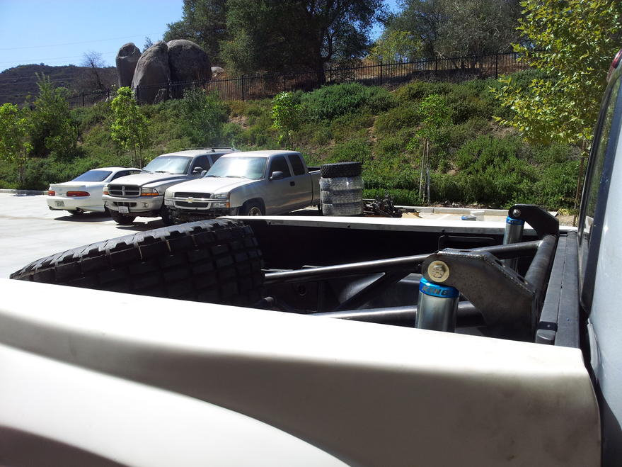

    You running 18" shocks:confused:
    You should have a bit left at both end of the shock but that seems like quite a bit.
    5 Degrees is what Mike says to set the yoke at, as this is the approximate angle of the fixed part of the 2-piece driveshaft :cool:

    No they are 16" shocks, the kit is only getting about 14" of travel metal to metal...

    No I'm not mad at the number at all, it has a huge gain in up travel from stock and I hit a drainage ditch and the rear handled it great. We could of mounted the shock level with the bed but figured it was better to split the difference. Mike recommends a 14" shock with his kit if u talk to him.

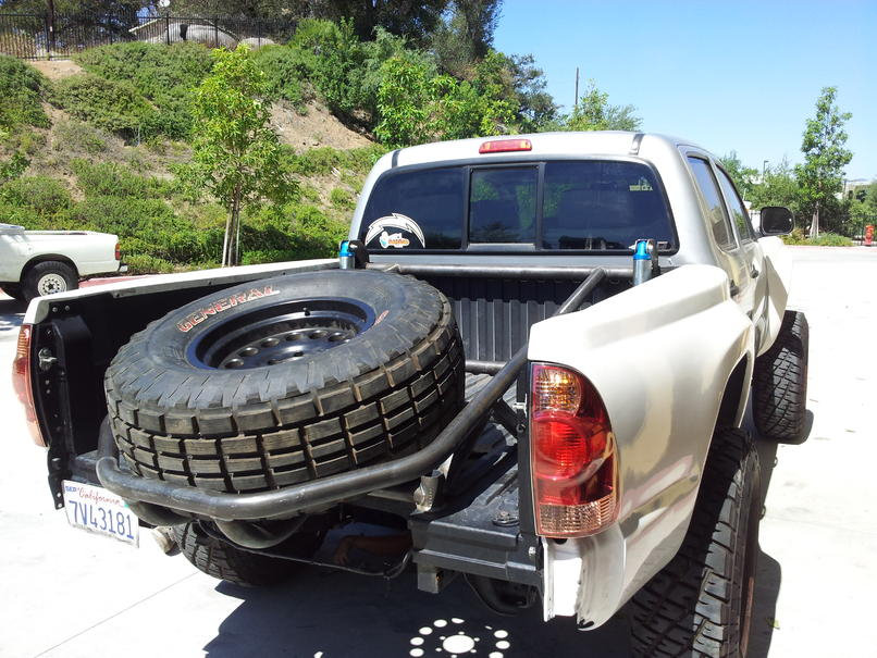

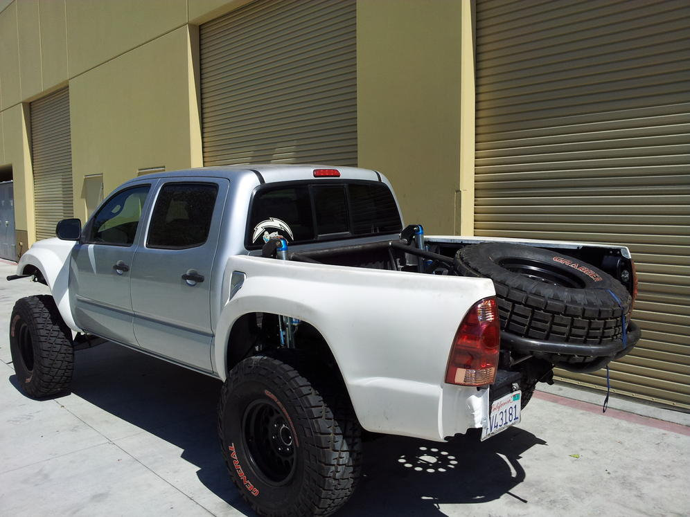

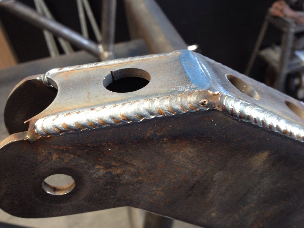

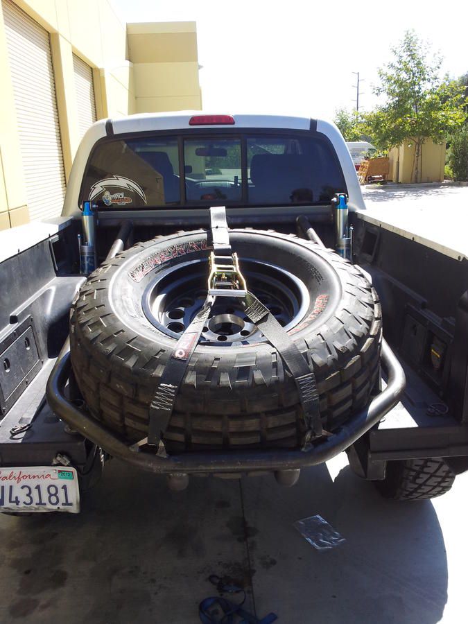

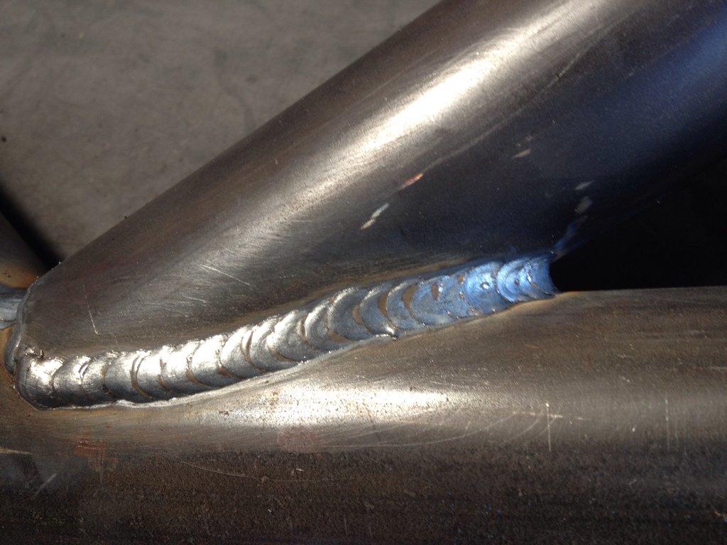

    New bed cage. American Motorsports
    0B369C96-830C-4575-9FC8-6389DB6FC62D-211_1adc2f014ca524f718c3dfc2cecb367537fead26.jpg
    EBD3DF68-86EB-4E1F-B21A-AF0962DEC9C8-211_af416165a49bda44af53b2d1d90b7d15067edf40.jpg
    6AFC156E-5803-4A48-AE13-B2168FB29393-211_02754e98ac1fb9b19f6c023b1e1a5e5a0ba83fef.jpg
    DB8F8242-5406-448C-ADAA-CE4F8321ECED-111_8a139d67e3d85ce29e23509edce5c9346a14a45b.jpg
    Will take some finished pics with shocks and bumps installed when the truck gets home
