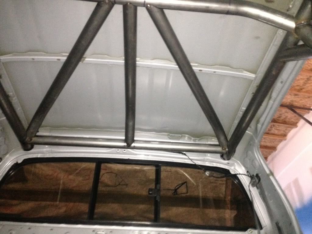

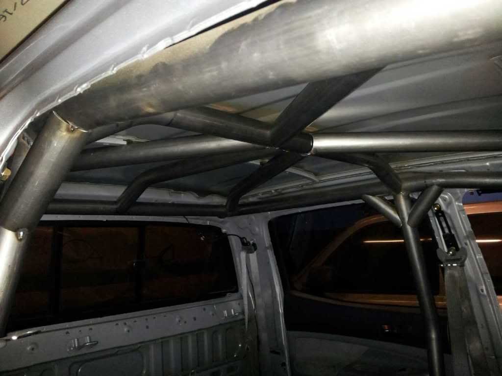

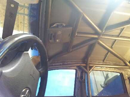

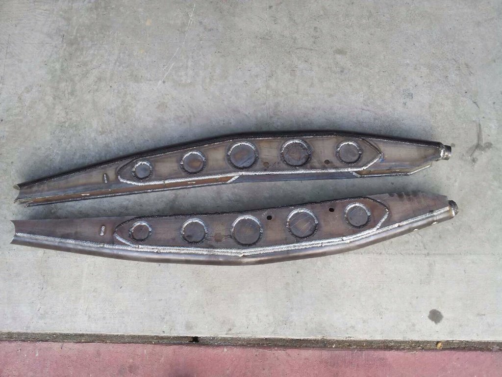

    Man that sucks but thank you for what u do and I hope you get home soon to see your baby girl!! Brian came by and visited and brought a present for me to look at while he played with the baby... Will get more pics on Monday and bring the daily updates back
    8C0D0B86-B06D-424D-95C9-B43D93A43890-188_5d81802a6e01a4d68f6dc5d7dc33b2522b31388e.jpg
    0193DFA9-48A0-4855-B029-CF56A427785C-188_20b8cb90b9e3061f075fe1e74847ccbfd967758a.jpg
    And Taylor was thrilled with her Winnie the Pooh toys
    9A64F967-47A9-4ED4-9922-413F7B1F5EAC-188_192abe5305a3d444890cac369345349797beb008.jpg

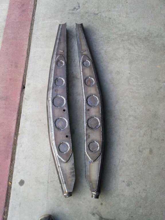

    Looking good!
    And congrats on the baby!
    What length are those links?!

    The trailing arms are 48" and the plan is to mount them under the axle.

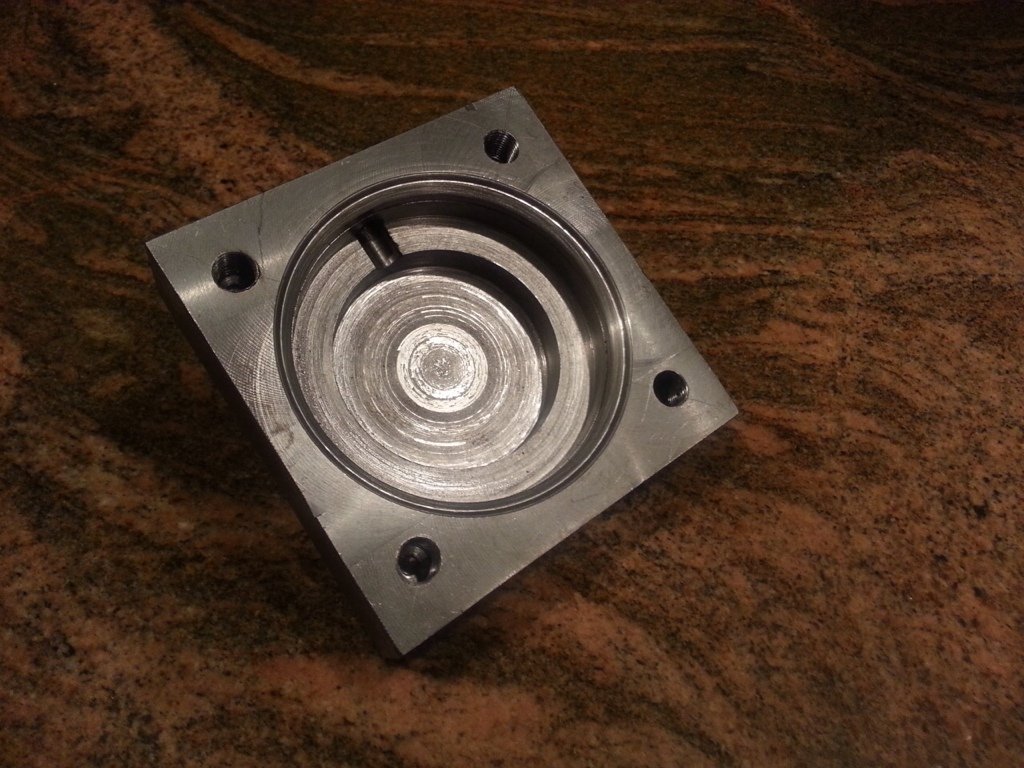

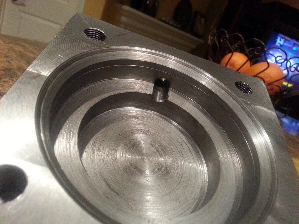

    First step to building the new front kit machined hub block.... Hope to have everything back from waterjet by the end of the week. Will have cad drawings of the new American Motorsports 05+ 2wd kit up within the week(barring any setbacks out of our control)

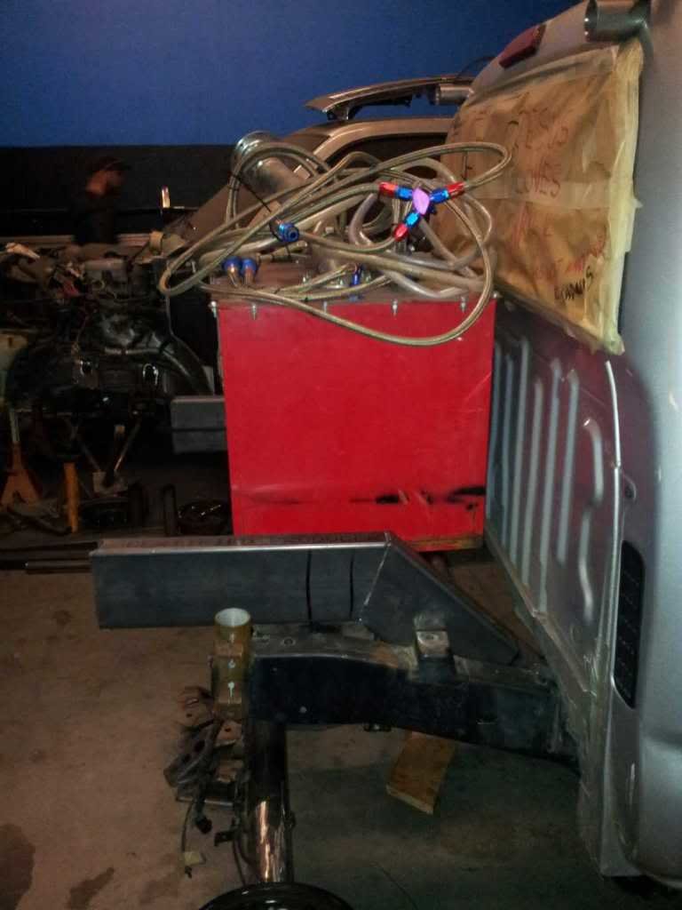

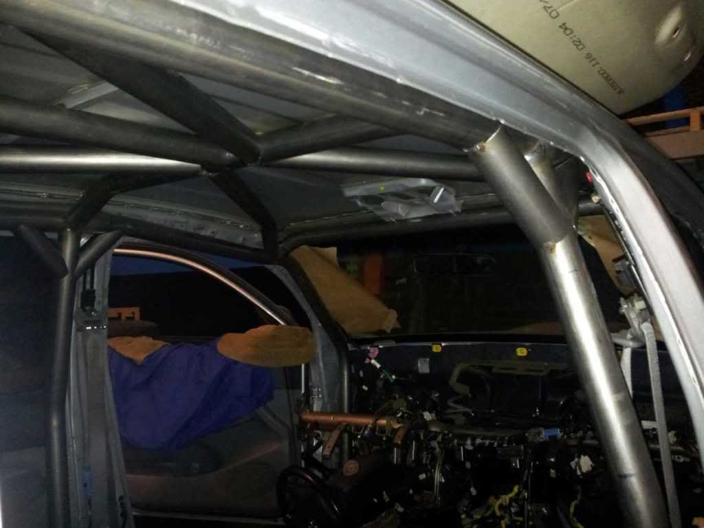

    Ok so let me explain, I asked Brian to hold off on the truck until I could be there and not be dealing with the craziness of new baby stuff. So today he finished a few small projects and tomorrow will be full bore back on the taco. I was able to make it to the shop today to get "day 4" photos. Cage is ready to be dropped for full 360 welds and once that happens we can finish the back half and mount the links... There is still a few bars left in the cage that will be going in but would of been in the way when dropping it.
    On to the pics
    Still need to cut the rest of the frame out, this shows where the fuel cell is going. Top of the cell will be flush with the bedsides and when the tire carrier goes in it will only stick out 6" past the end of the bedside

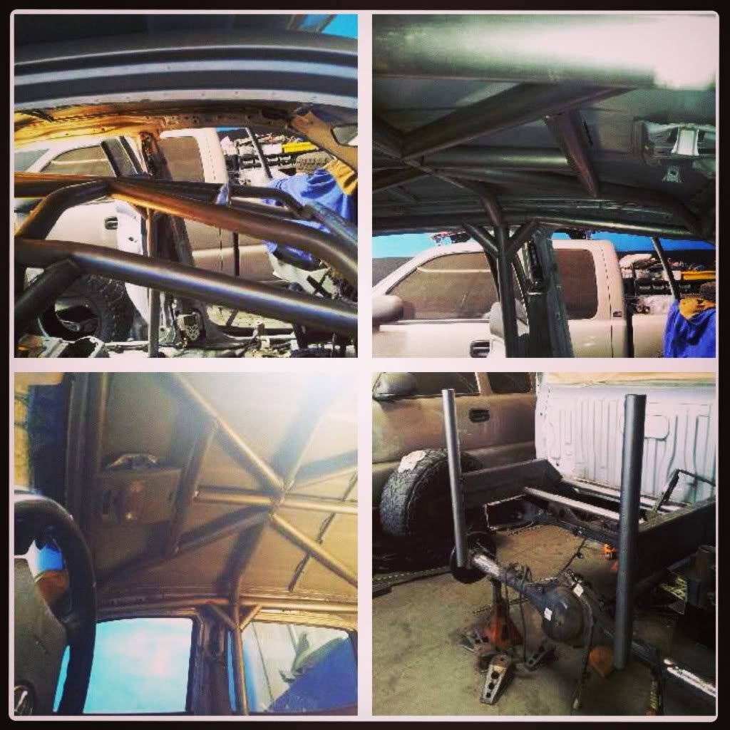

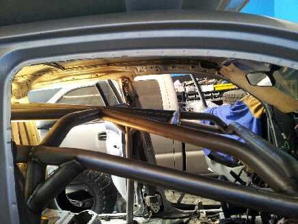

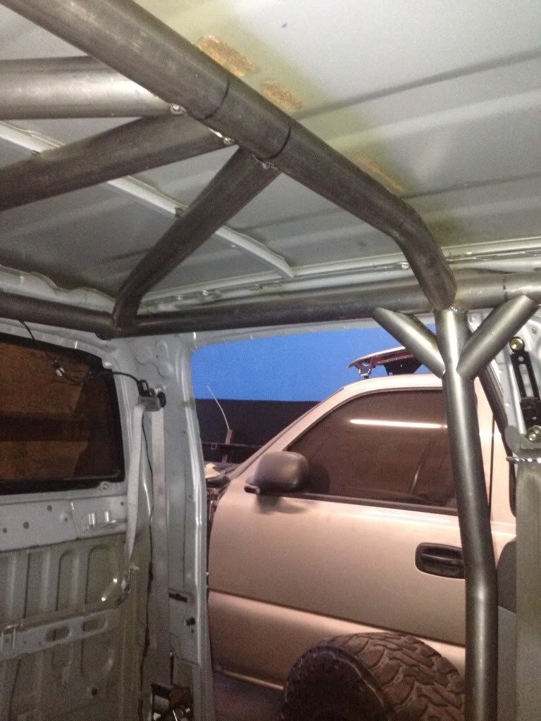

    Next day pics got the cage dropped and full welded and started the back half. Plan is to have dual verticals right behind the axle so they won't stick out to far past the end of the bed. Going to make it to where the spares can be pulled out and have a storage are or put a panel over it and have a small bed, that's the plan anyway anyway to the pics
    Going to paint it tomorrow and throw some interior back in and hopefully mount the links
