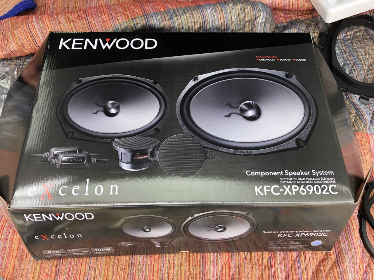

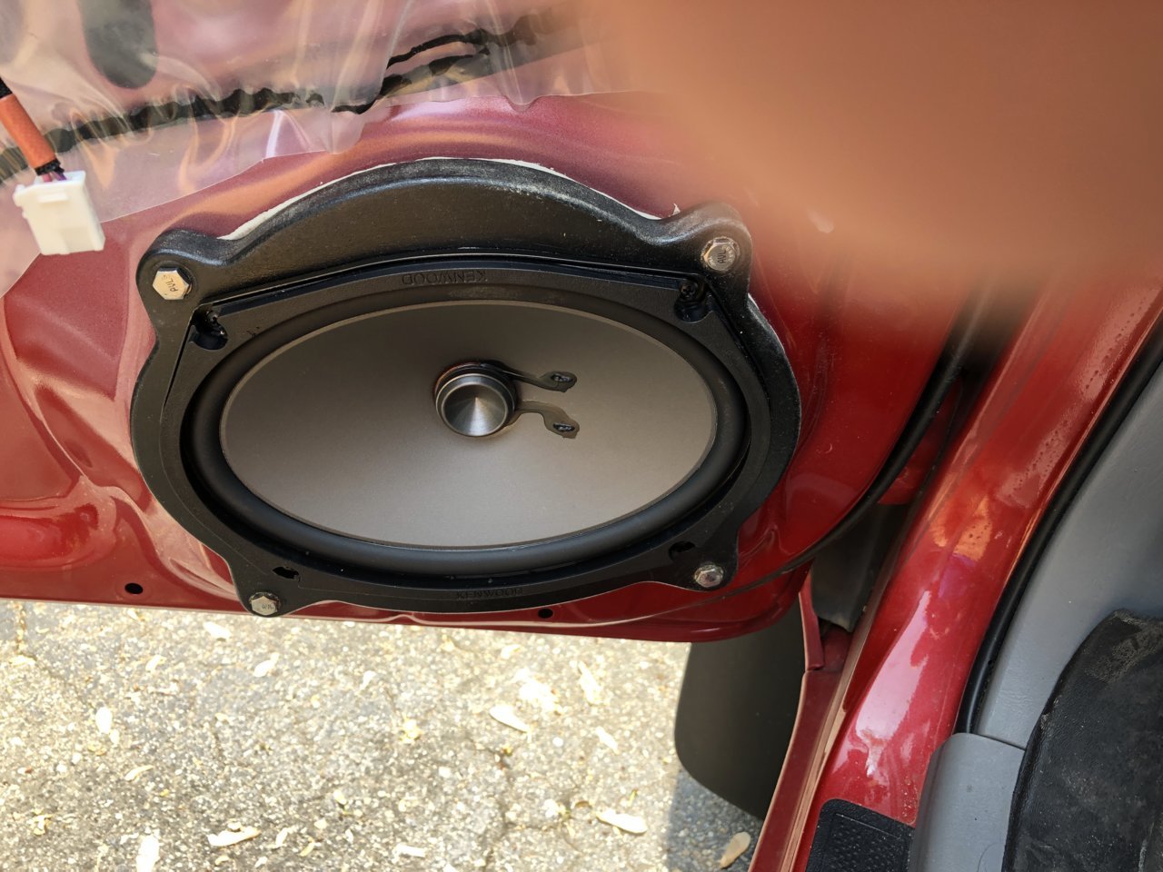

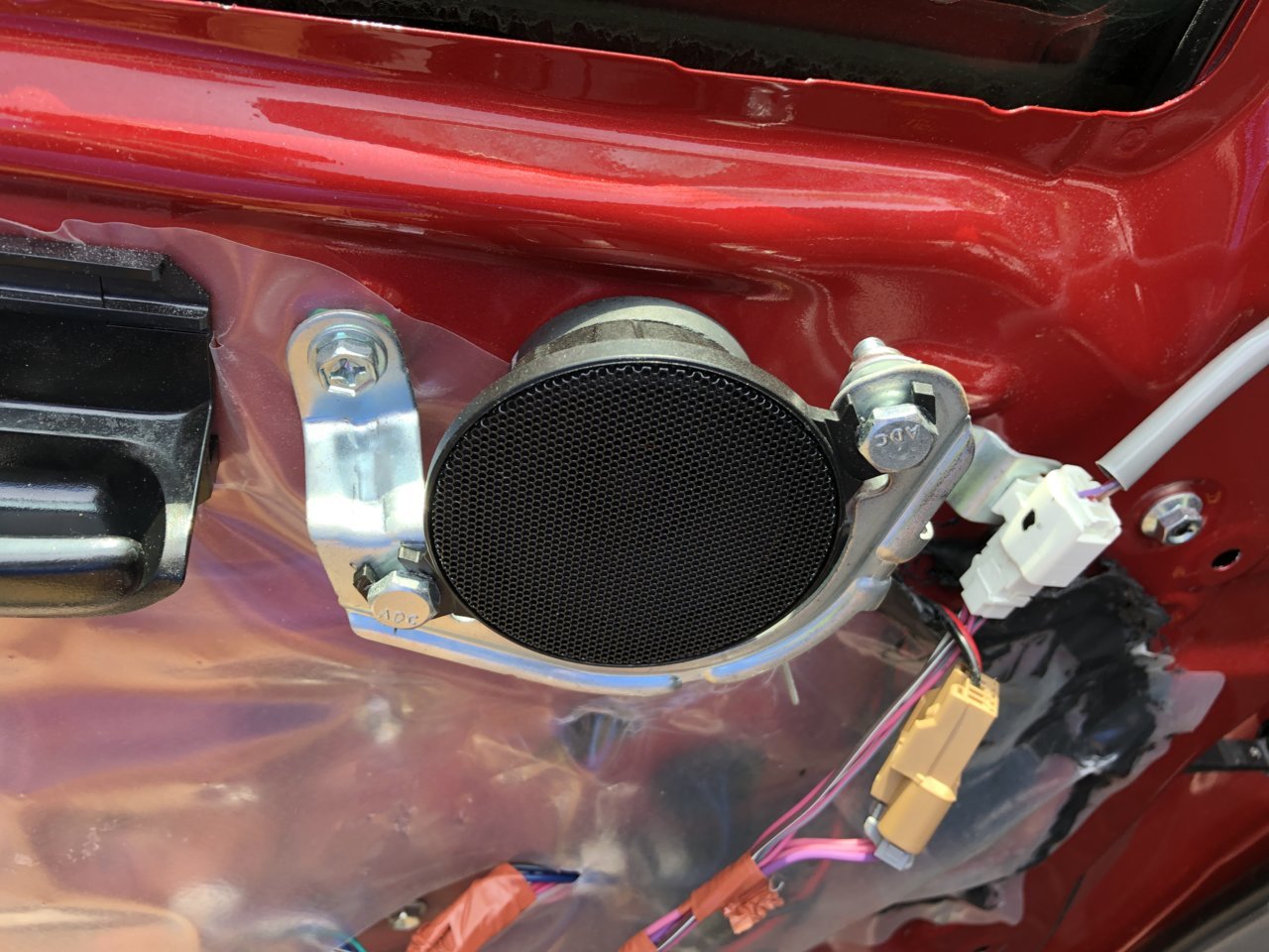

    Installed and ready to go. Haven’t given them a good listen yet but not bad right out of the gate.
    These came with plastic baffles for the 6x9s. They have tabs that can be broken off to fit the specific car you have. I was going to use them but when I was breaking the tabs I actually broke the whole thing.
    As you can see, i re-used the MDF baffles from the previous 5x7 (after some jigsaw action). It was a hassle but I’m better off with these I’m sure.

    Not really. You’ll need a way to get the tweeter mounted in the factory location. I think Metra makes some brackets that fit and you just cut a hole for your tweeter. Pretty simple.

    Ive been very happy with the speakers. I have no interest in changing anything. I’m about 98% satellite radio and it sounds excellent. The Alpine amp (bridged) was the ticket for me. Minimal wiring hassles and it’s stuck inside the dash on top of the radio.
