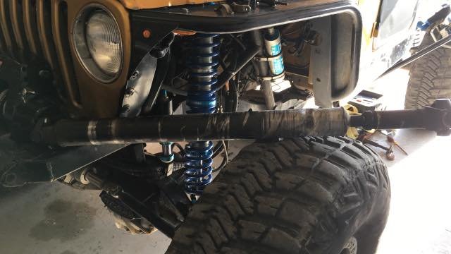

    I would look around at different drive shaft shops. 400.00 to re-tube a driveshaft is ridiculous.
    After 4 years of abuse on this one, it cost 122.16 to retube. Hell, I was even bitching about that and was just going to buy a kit, weld it up myself and have them balance it.

    I paid $370 to get mine retubbed as well. They also changed a yoke and u-joint. Steep.
