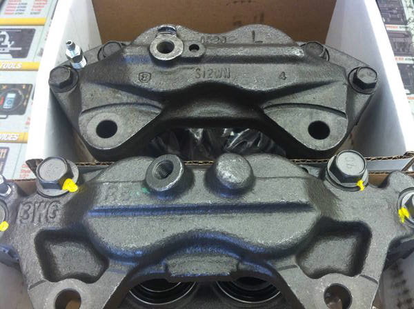

    Getting ready to start gathering parts for the Tundra 231mm brake upgrade. I know the banjo bolt needs to be modified so it will clear the flare fitting on the calipers, but I'm wondering if anyone has had problems with the banjo fitting sealing properly against the caliper itself?
    Looking at both the remanufactured 13WL & 13WG calipers for an '05 Tundra at NAPA, the surface around the hole is pretty rough since it's designed to take a flare fitting. Has anyone had to machine the surface, is there a different caliper out there that has a smoother surface, or does it just work fine as-is since it uses a copper washer? I'd hate to get this all put together and end up with a massive leak....
    13WG next to the stock caliper that is designed to use the banjo fitting. None of the surfaces were very smooth, IMO:
    Thanks for the help!

    I had no issues. The copper is a soft metal and when you tighten it down the copper should form around the imperfections.

    I filied the rough surface down as best I could and it sealed up perfect on the drivers side. The pass. side I had to use 2 copper washers on the caliper and that stopped my leak.

    Good to know... Sounds a little less than ideal. Someone mentioned that the '06 tundra calipers were machined, but that could be hearsay....

    Any chance you could post a photo of the Wheelers lines at the calipers? With banjos we still have the problem of seal at the copper crush ring against the rough casting.
    I think they should be "spot faced" by a machine shop with a shorter banjo bolt. However, I will stop at the dealers to see how the Tundra fitment is before doing any machine work.
