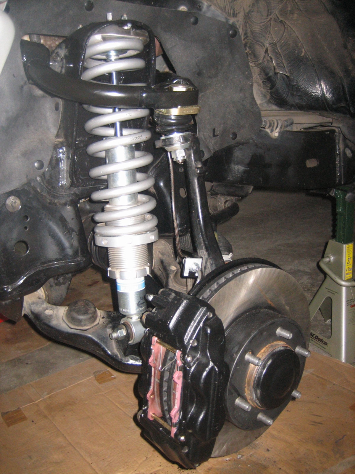

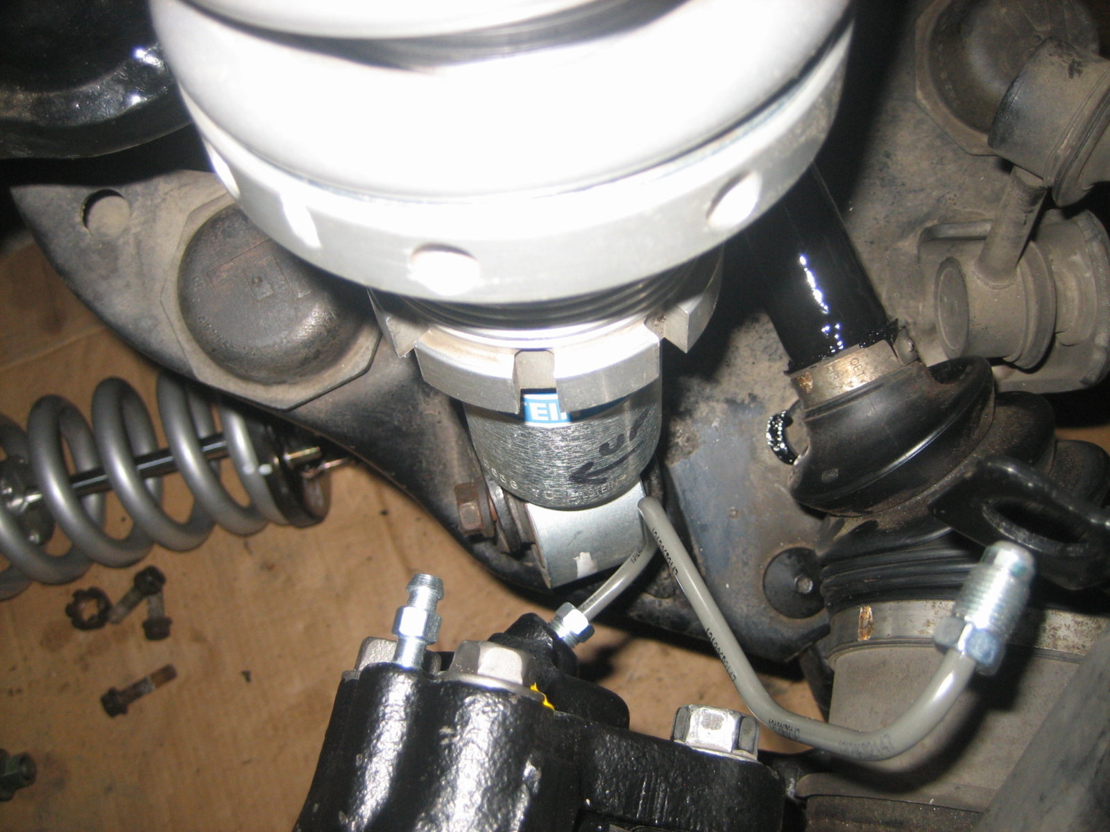

    Ok! Finally had some time to follow-up on this and post up some install pics.
    Regarding the spongy brake pedal feel, I re-bled the calipers after some road time and found no air in the system. Removed the pads and pressed out the pistons a bit to make sure none of them were sticking. Re-assembled and pedal feel was better, and has greatly improved over the last 1000 miles as the pads have bedded in. Then again, maybe I'm just getting used to it :rolleyes:. I had also installed the new UCA's and adjusted the front lift height, so during the alignment I had the shop check the brakes and they checked out fine. Braking feels much more uniform with less force on the pedal. All this without feeling like the brakes were going to fade or lock up while slowing down. Overall, I'm very pleased with this upgrade and how the fit and finish turned out!
    I'll say a great source for this upgrade came from t4r.org. BigFishAllDay put together an outstanding write up complete with specs and measurements for his Tundra brake upgrade. It's well worth the read! I ordered the following parts spec'd for a 2005 Tundra 4X4 4.7L:
    *Rotors- Toyota OEM
    *Pads & Shim Kit- Toyota OEM
    *Calipers (231mm, 13WL stamping)- NAPA Eclipse Remanufactured

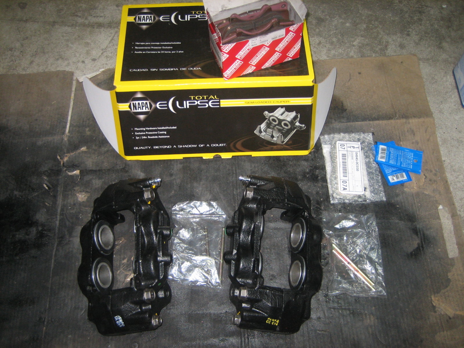

    Calipers and pads..... My old calipers were the same Eclipse brand and worked without fail for the last 10K miles up until the upgrade.

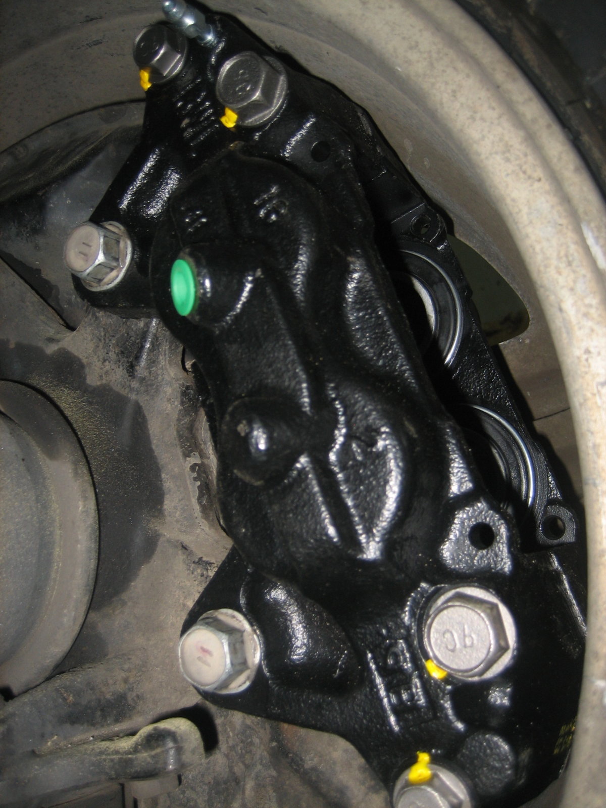

    Fitting the calipers was a bolt-on procedure. The dust shield only needed to be trimmed back 1/4" at both the top and bottom end of the caliper. The OEM caliper bolts were the perfect length.
    There was adequate clearance between the caliper and the stock 16" 5-spoke alloy wheels.

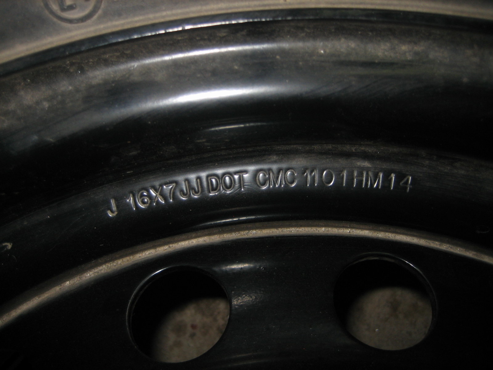

    Note that the stock 16X7 spare rim fit with plenty of caliper clearance to spare! :) Stamping on spare rim shown for reference.......

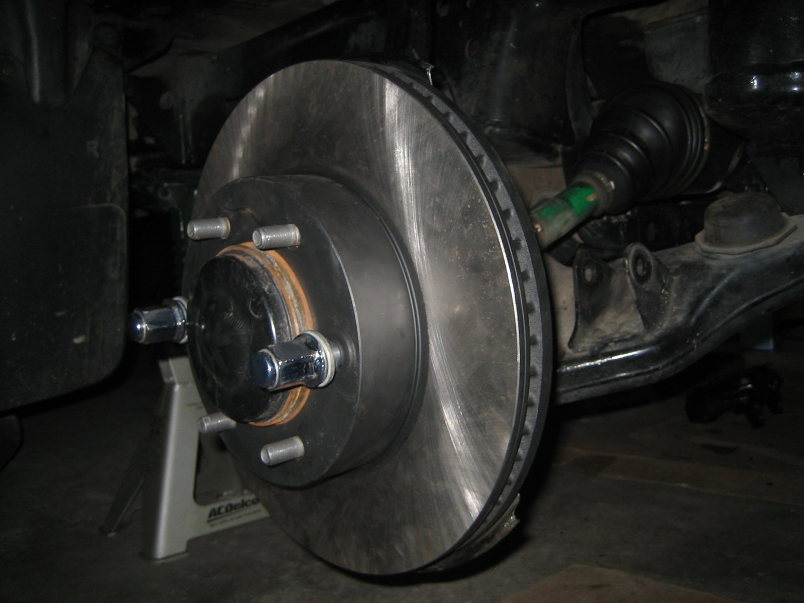

    I expected the rotors to slide right on without interfering with the shield, however, they are slightly larger than stock so the shield needed to be bent/pushed back about 1/4" to gain clearance behind the rotors.

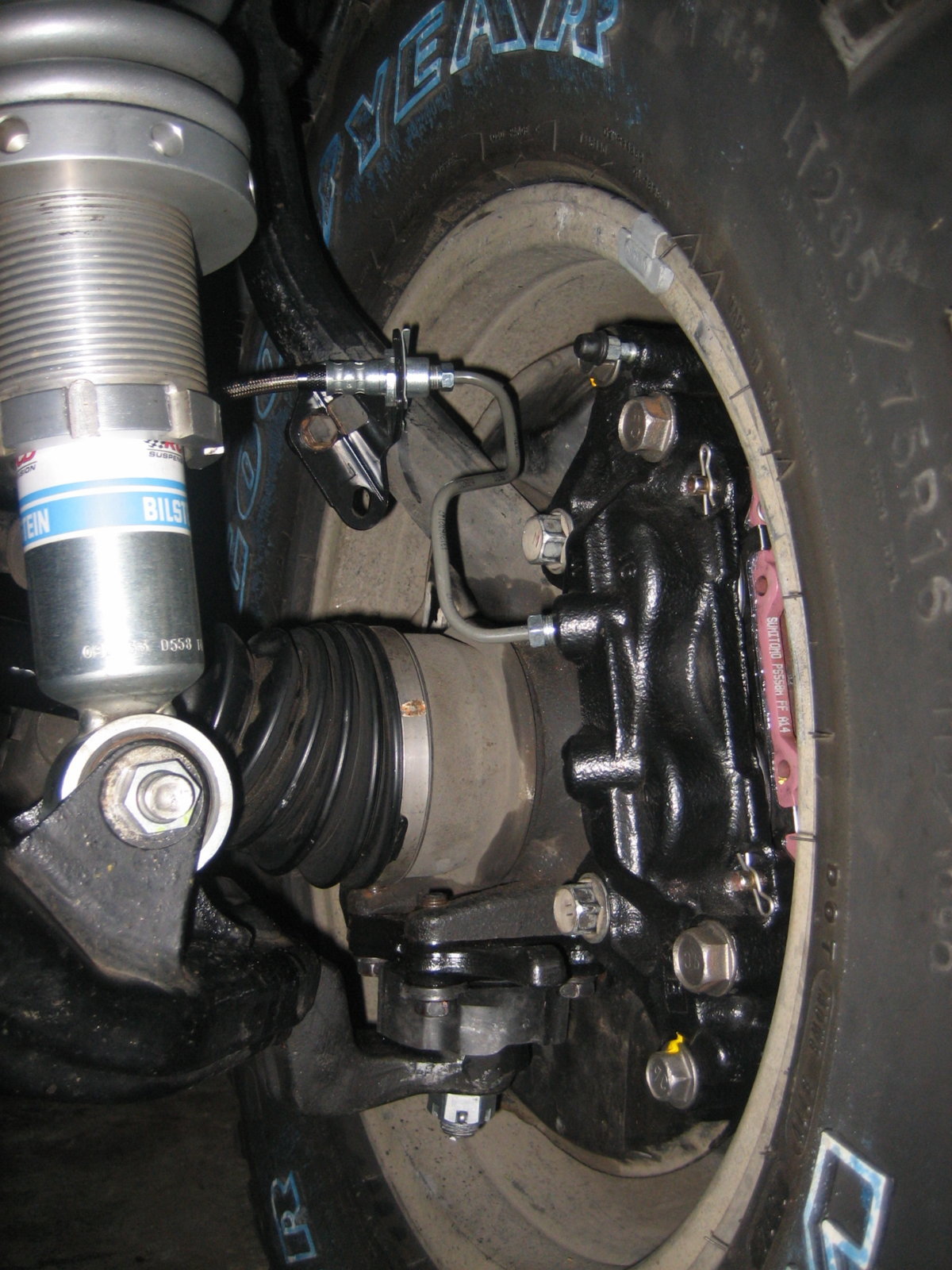

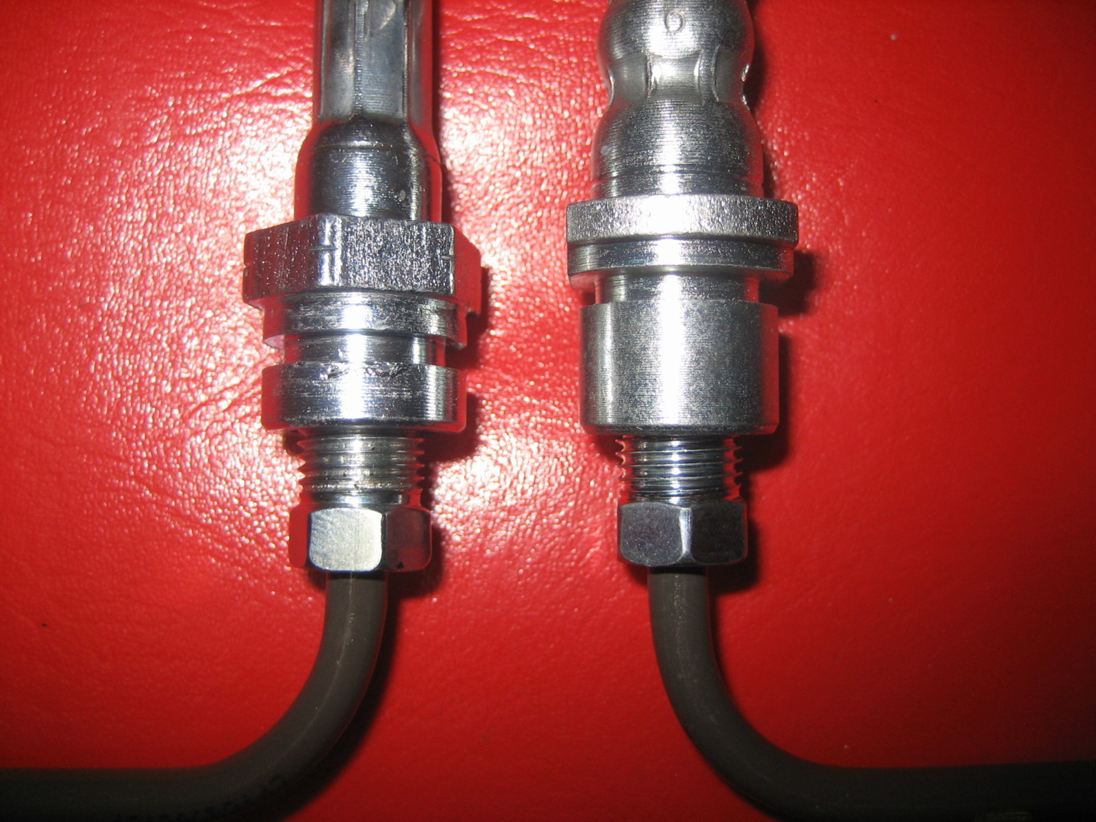

    I decided not use the banjo bolt mod since the banjo mating surface on the calipers was very rough and the calipers were designed to accept a double-flare fitting. So I came up with my own solution and ordered the following:

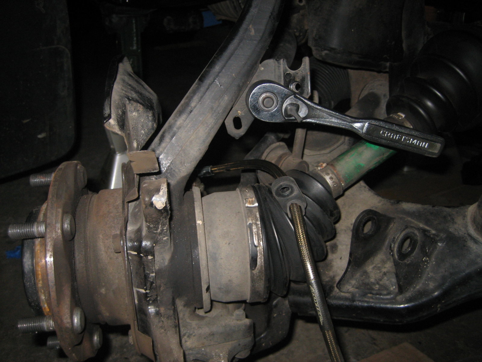

    *Left and right hard line located between the caliper and spindle for a 2002 4-Runner- Toyota OEM
    *Left and right hard liine to flex line spindle bracket for a 2002 4-Runner- Toyota OEM
    *(4) C-Clips
    *Left and right ~17" custom length brake lines female-female- Paragon Performance

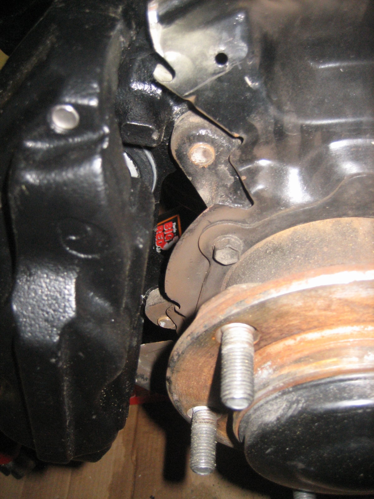

    Removing the stock brake line bracket from the spindle:

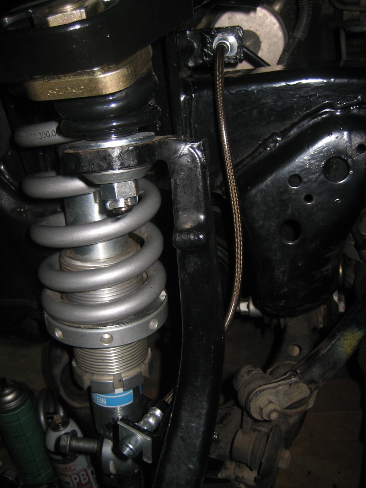

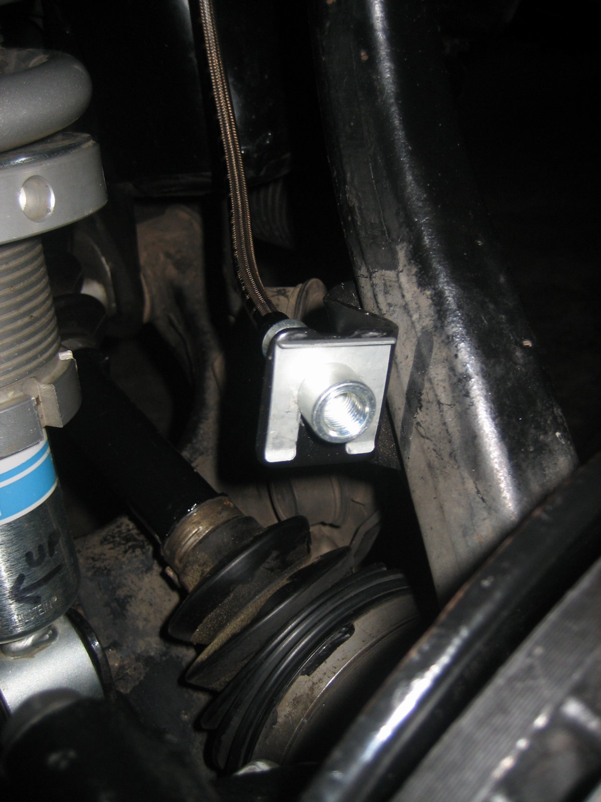

    Flex hose installed between frame and spindle:
    Overall view of the flex hose routed between the frame and spindle:
    I have to give a shout-out to Paragon Performance. I originally ordered my lines from Crown Performance, but ended up going with Paragon. See the side-by-side comparison below with Crown on left and Paragon on the right. Note that the Paragon fitting has deeper threads and the OEM-type backing plate while Crown has shallower threads and requires a thin washer to be used as the backing plate. While Crown is a reputable source your hydraulic line needs, I thought the Paragon lines were a much better fit and finish, $20 less, and they shipped in half the time! While the Paragon hoses appear to have a smaller outside diameter, they are also more flexible than Crown. Time will tell how they hold up in the long-run.
    Lines connected, calipers and pads installed!
    Finished product! The 4-Runner brackets and hard lines were a perfect fit and an easy bolt-on procedure. I would like to have used a 4-Runner hose, however, the hose to hardline connection on the Tacoma is located on the top of the frame, rather than the side as on the 4-runner. An extra several inches of hose length was required for everything to fit up properly. The hose doesn't appear to be touching anything, though I'll check back in a few months for witness marks. Otherwise, this setup is identical to that of a third generation 4-Runner.
    The only issue I see with using the hard line vs. banjo fittings is interference issues if I ever decide to go with a true coilover setup such as a King, Icon or Racerunner. At full lock, the hard line is less than an inch from the shock mount. Would love to hear from 4-Runner folks who are running coilovers and whether they had to modify the hard line where it connects to the caliper.

    I just used the 4runner hard lines from the frame to the caliper. Welded the tab at the frame.

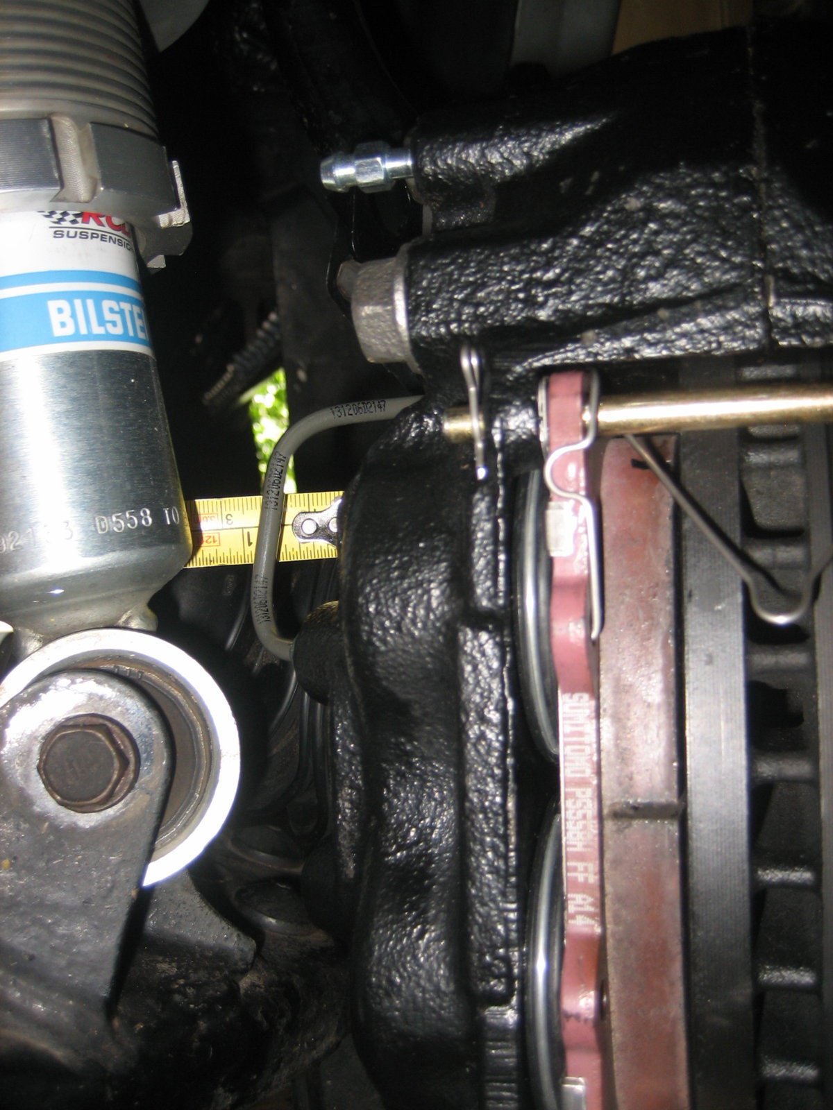

    I found the order list, and it is as follows:
    Fronts: 10mm 1.0 female fittings (on both ends), 17.5" length.
    The two fronts and rear brake lines were $107 shipped. I only ordered the rear because it was part of my lift project, and needed the longer brake line.
    17.5" seems to be spot on for travel and turning articulation. Please keep in mind I have a 2.5" lift up front, with Light Racing UCA's, which gives me about a half inch more downtravel. Overall, you should be good with this length regardless since it needs to be able to move through various travel positions anyway.
    After 8 months and about 3K miles (don't drive it much), there have been zero problems with the line rubbing, leaks, or other problems. The upgrade performs great and I feel it has been very reliable.
    Also, another option that someone mentioned, would be to mimic the 4-Runner setup by attaching (in our case, welding) a mounting point to the frame, re-route the hardlines to it, and use a standard 4-Runner brake hose since it'll be long enough. Or, just go the Wheeler's route and use their lines. I just didn't feel comfortable with how those banjo fittings would mate to the rough surface of the re-manufactured Tundra calipers I had purchased. That's just me.....

    FWIW I drilled out the banjo fitting and got new copper washers. Works fine, no leaks. I tried to go the hard line route but I guess I didn't get all the parts I needed so I ditched that idea, put my purse away and got the drill out.
    Those damn brakes have saved my ass more times than I can count, and I've only had them on for a year. Stock brakes with 33s are like "I'll stop when I feel like it...."
