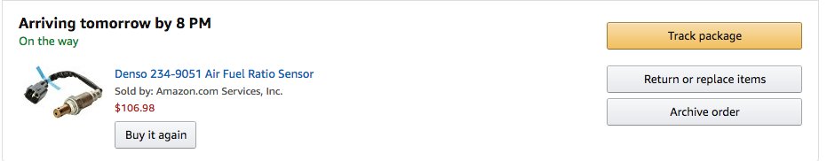

    I have a 2006 4.0 and have a bank 2 sensor 1 code... This is the one I bought :
    EDIT: disregard, looks like they changed part #s over for different years.
