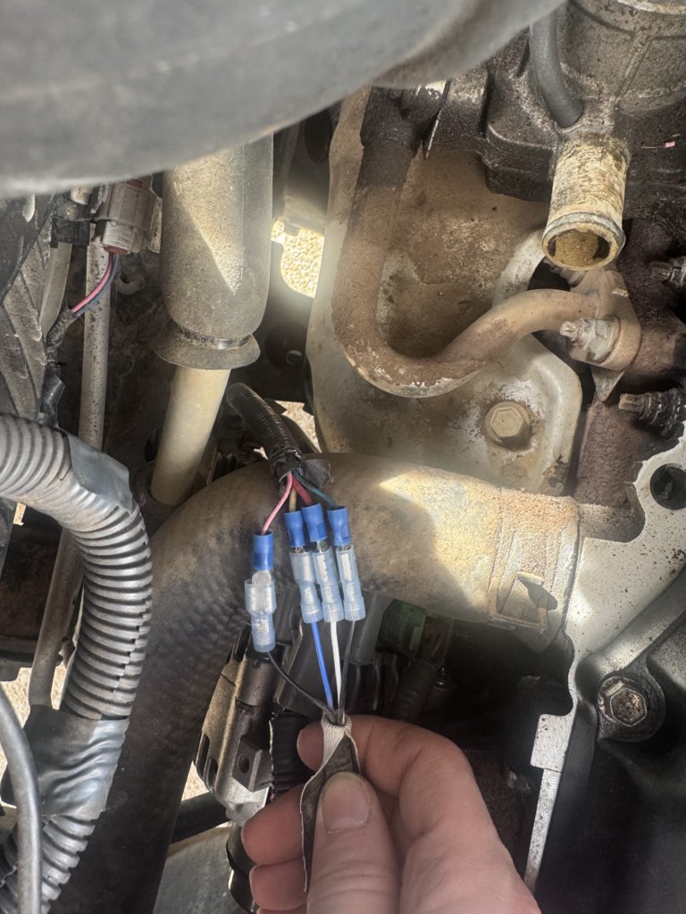

    Can anyone tell me if I have these wires up right?

    No way to know like that, the sensor end colors vary. Even if it is it won't work long being those aren't sealed terminals, why did you cut the connector off?

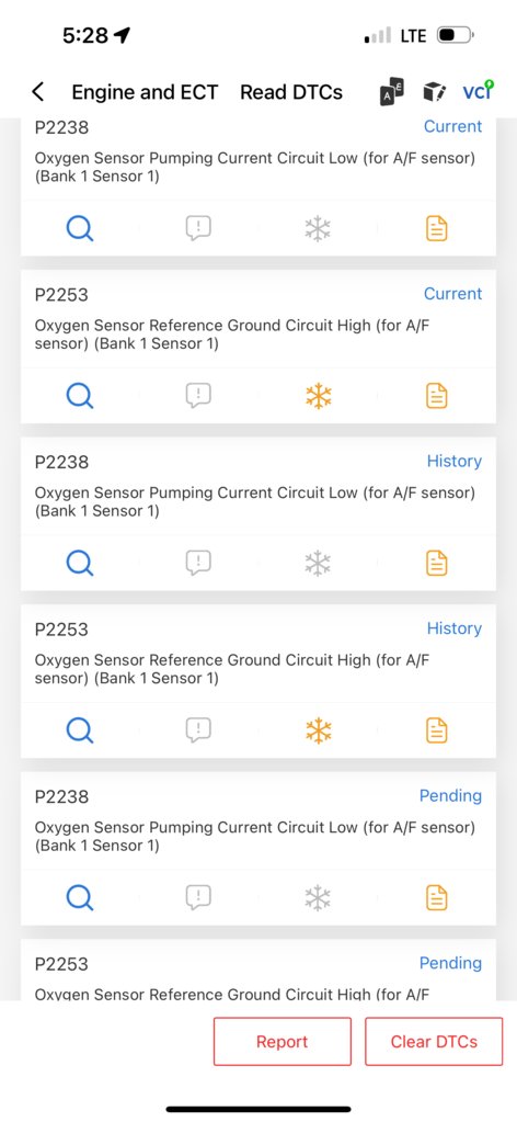

    I didn’t cut the connectors off, I just bought the truck and it was wired like this but the obd codes are as follows

    Looks like a universal sensor.
    They don’t tend to play well with Toyotas.
    We’d need to know how the universal is supposed to be wired.
    Is it a Bosch?

    If that's the case I'd suspect someone bought a "universal" sensor and tried to make it work which they will not because it's an AFR sensor not a standard O2 sensor, that would be the only reason to cut the connector off.
    I'd reccomend getting the correct sensor and connector and properly splicing it on with either solder and heatshrink or heat seal butt connectors.

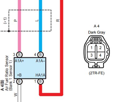

    Here's the wire colors and pinout, view is looking into the connector.
